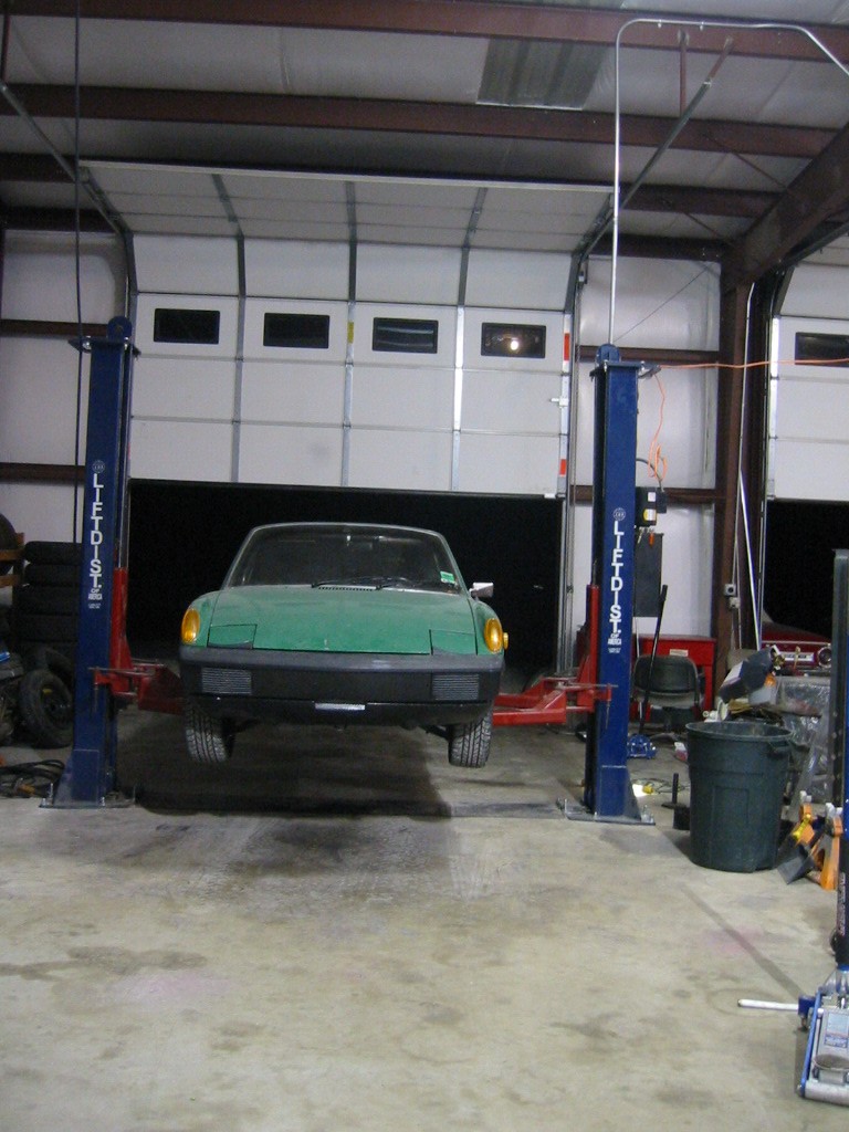

car in its natural habitat...on the lift:

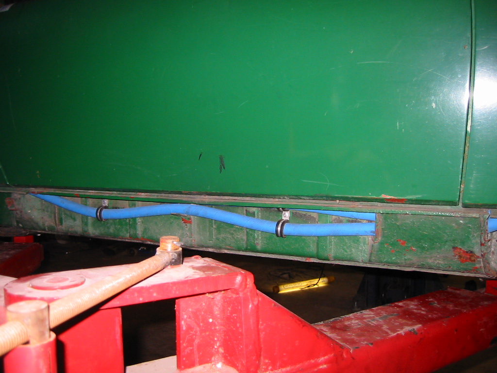

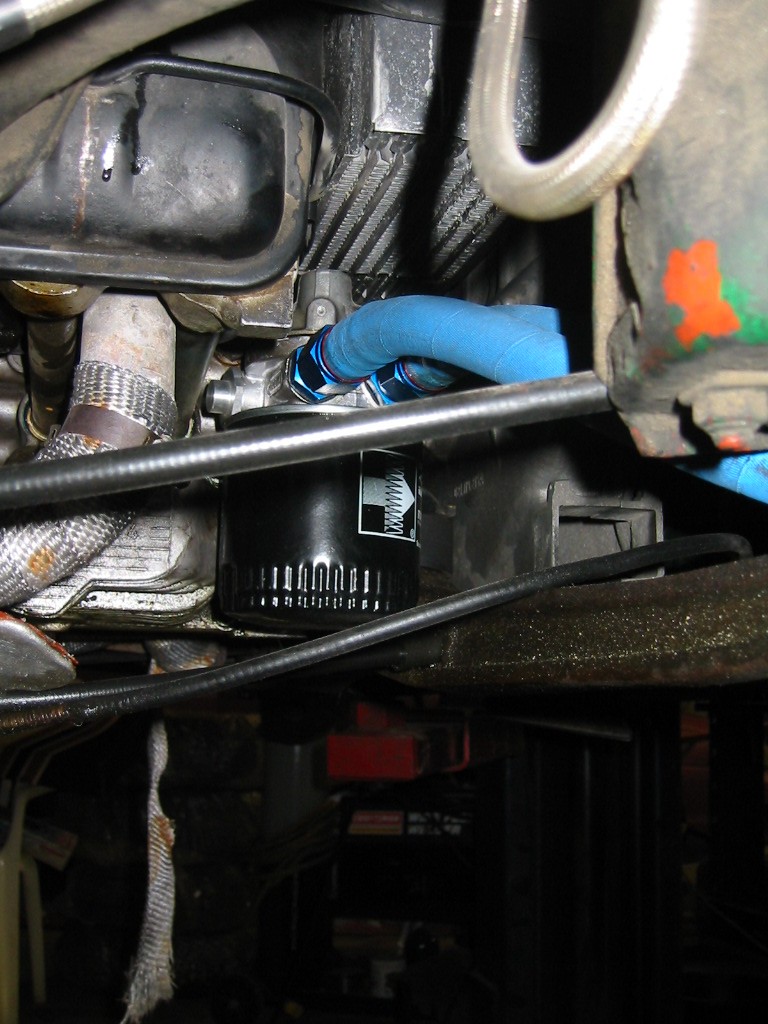

oil cooler pic 1

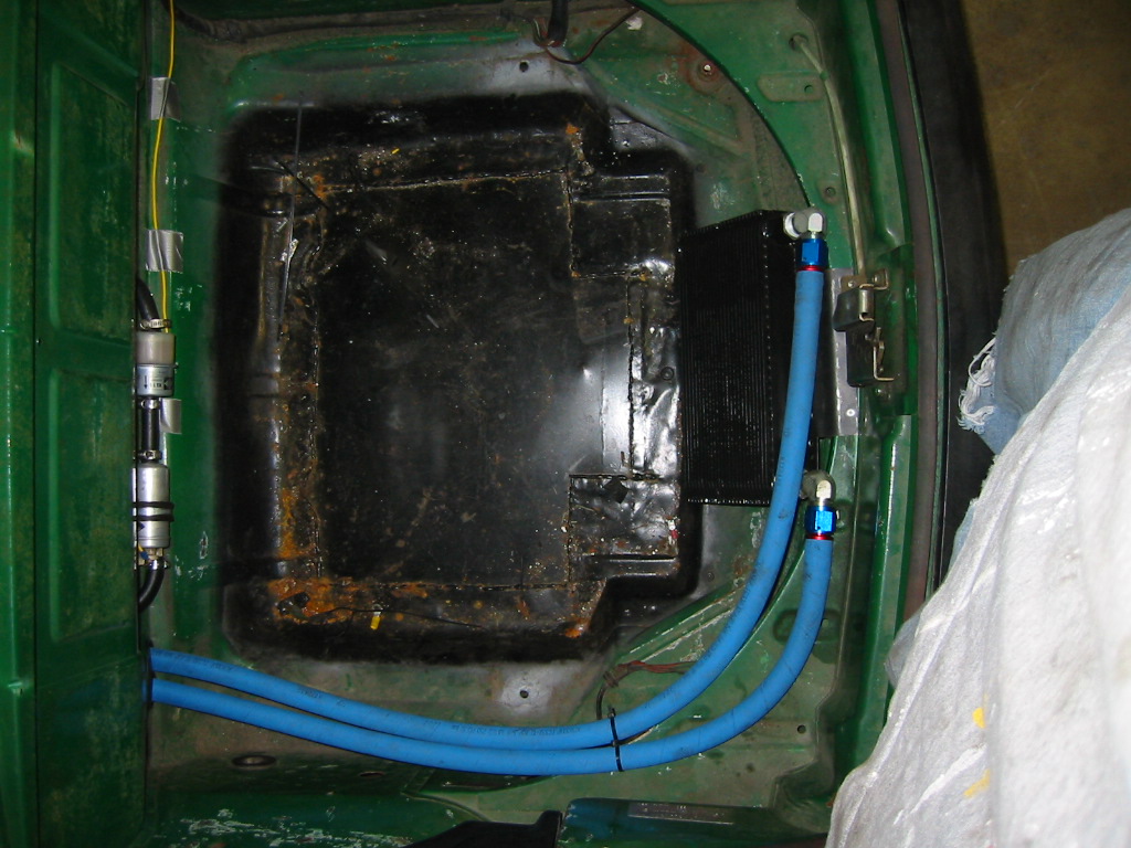

oil cooler 2

oil cooler 3

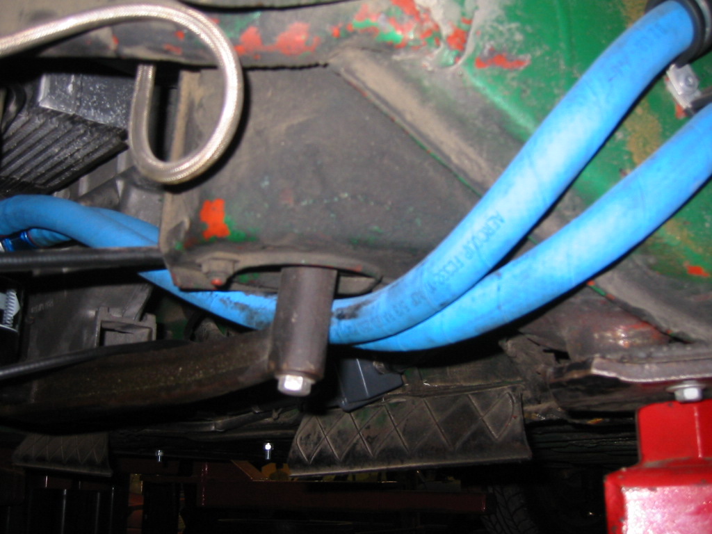

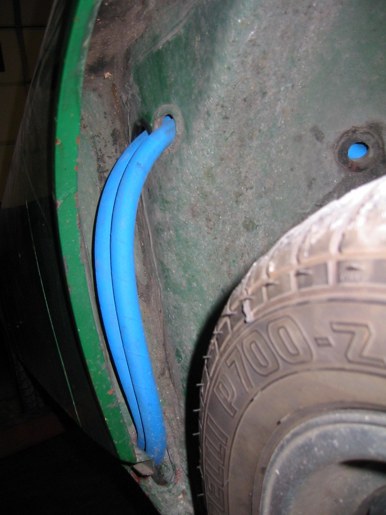

oil cooler 4

oil cooler 5

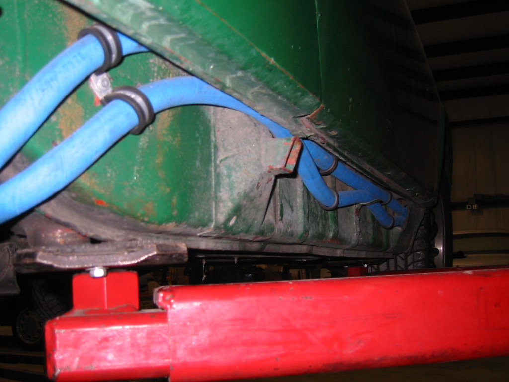

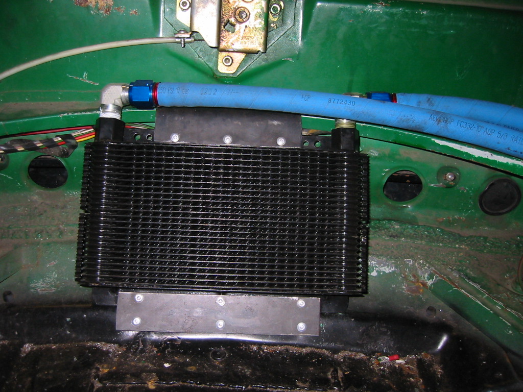

oil cooler 6

oil cooler 7

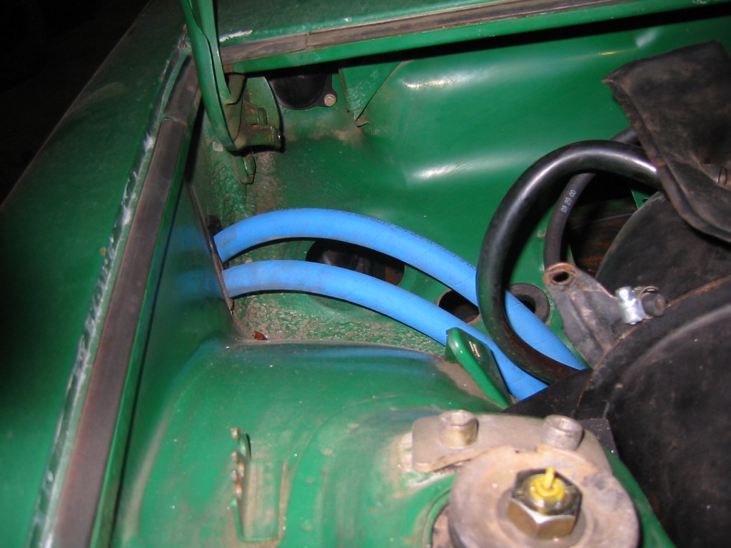

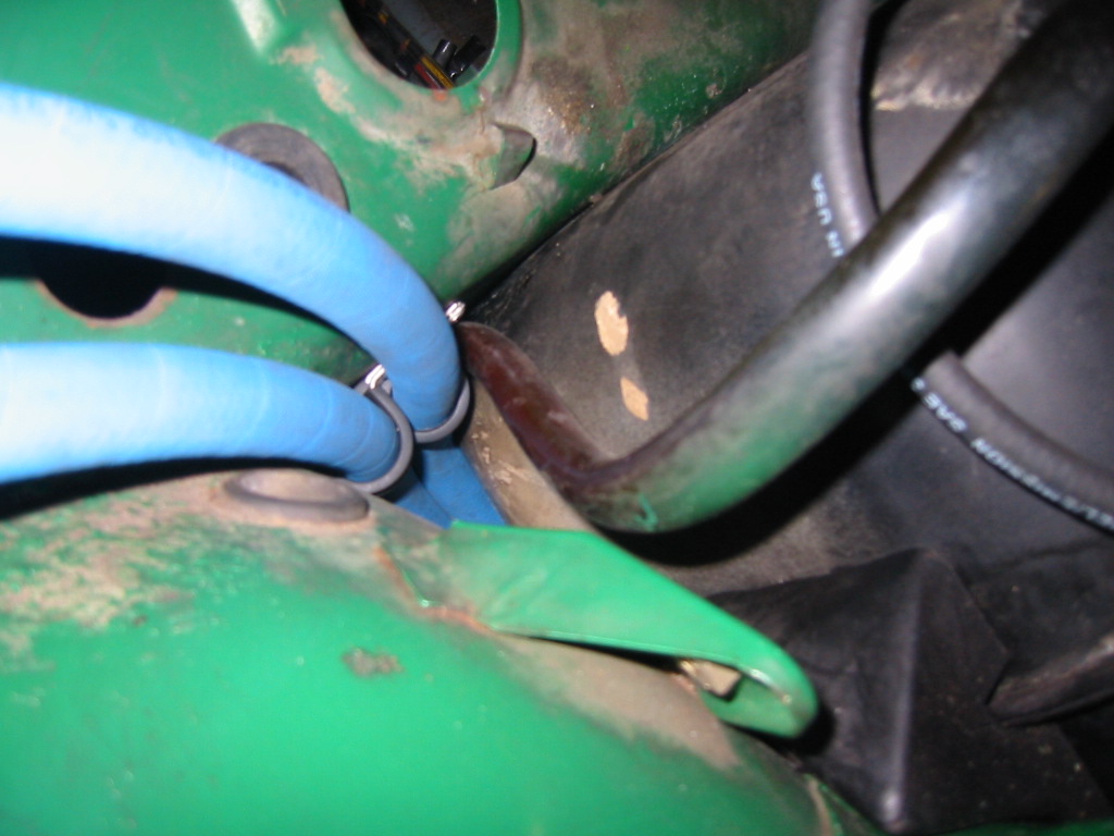

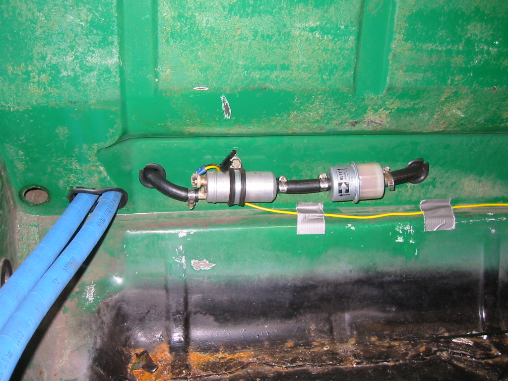

oil cooler 8 - also notice relocated fuel pump w/ pre-filter and getto wiring...

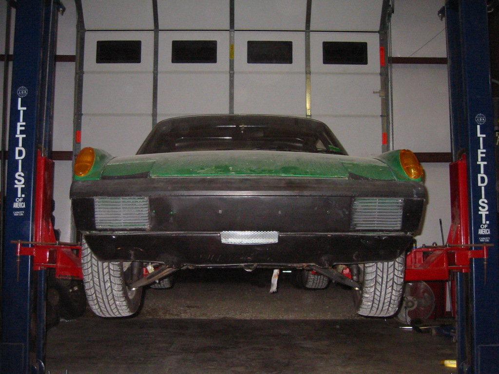

opening I made in the valance and bumper...all i did was cut out the front trunk between the circles, so that is why the opening is so small...so far it has worked well, oil has not gotten over 190, but it has been cool out and i have yet to really push the car...

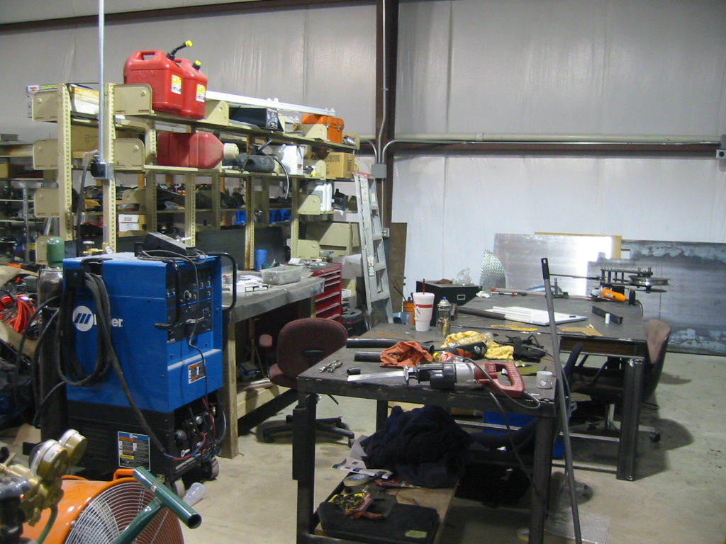

our main shop area, with our Miller TIG...(I love that thing)

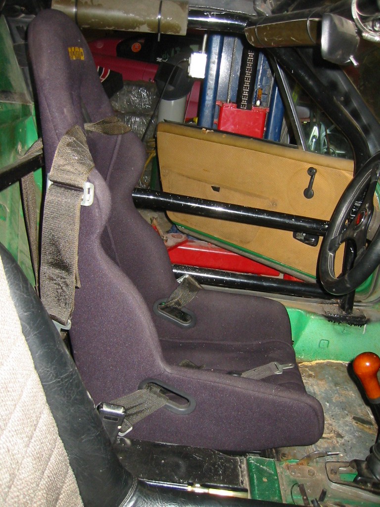

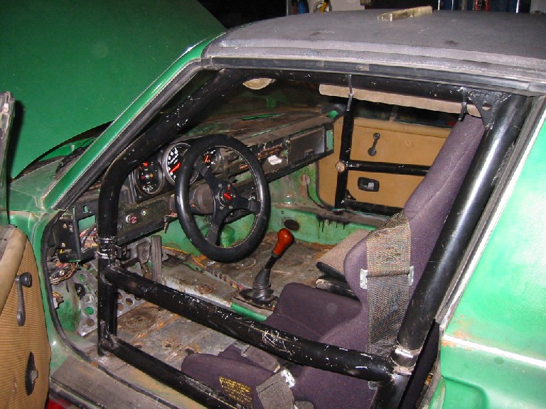

almost forgot to show my seat...its a MOMO start, full fiberglass FIA approved seat, I think it is similar in dimentions to the Corebu that alot of people have used...so far I love it:

seat 2...I cut out the cross brace on the drivers side to bring the seating position lower, but I did used the adj sliders with the seat, so there is some adjustment for different size drivers...I actually think this seat would work well in a full interior car also...
