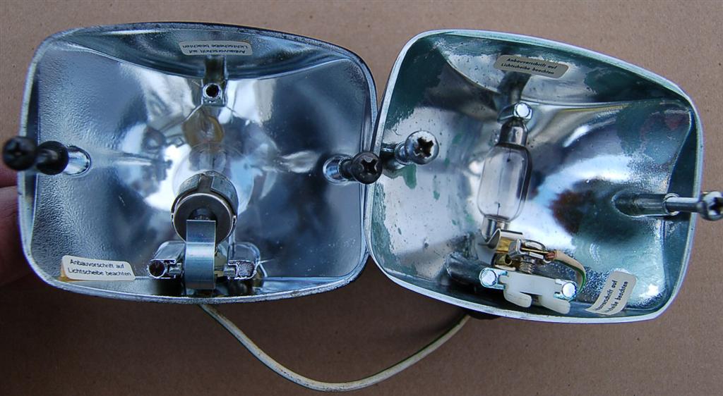

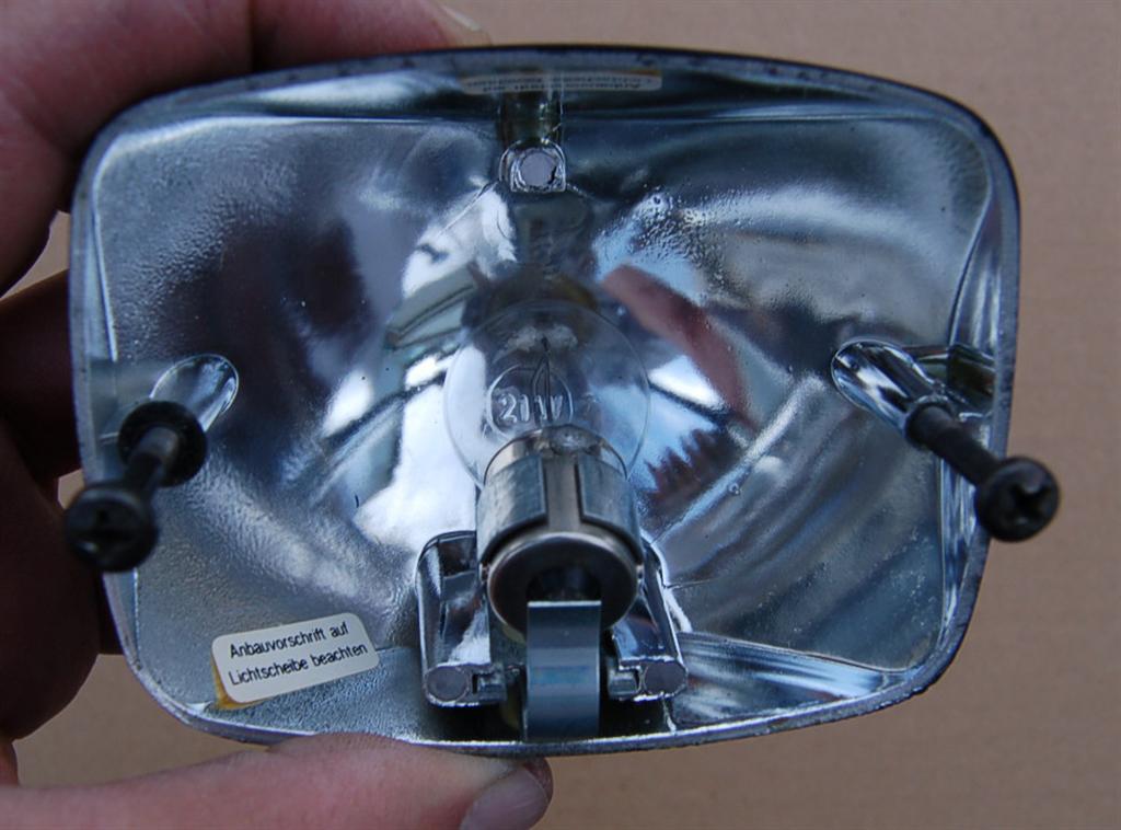

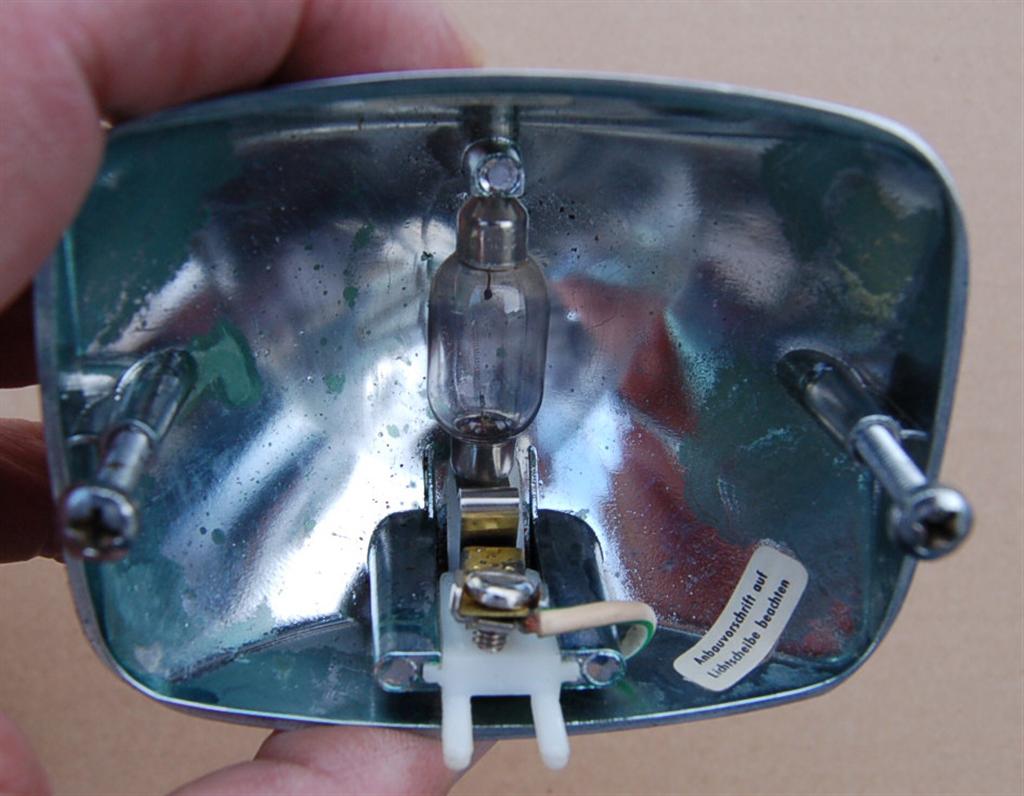

Differences inside the U.S. & Euro housings
Tom

Lens are different. I like the Euro lens & that's what I used.
Tom

QUOTE(Thomas J Bliznik @ Jun 30 2007, 11:00 PM) *
Note, the U.S. spec housing is satin black & the Euro housing I got from Gustls was chromed. I wonder why??
maybe it has to do something with the model year?
or they used the different versions for cars with black bumpers vs. cars with chrome bumpers (IMG:style_emoticons/default/confused24.gif)
