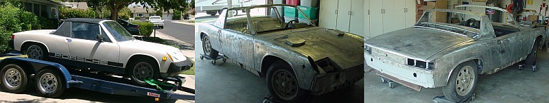

Edited.....thought I would add some before and a after picture since this thread has evolved into a v-8 install/restore/modify thread. The story begins....

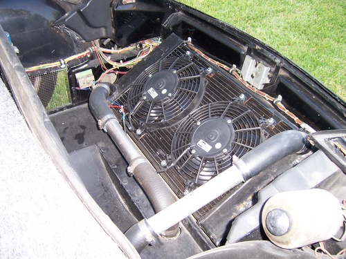

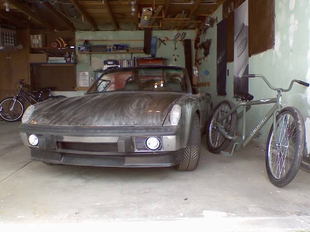

Heres a photo of my radiator setup... I have the 916 front so I just use the cutout to get my air. I also have my fluid lines hard plumbed...no clearance issues..

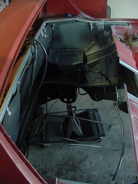

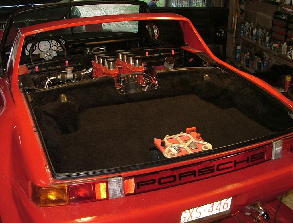

Here is how I did my front trunk.
Why did I move my battery? I don't know, i wish I had left it in the engine compartment. Its the first thing I did on the car. You need to wire the fans with a relay so that you do not overload the sender for the fans. I used a JC whitney adjustable fan. Also went with a custom $275 dual pass radiator done by a local shop, worksd great!
I also ran hard lines wherever I could
Mark

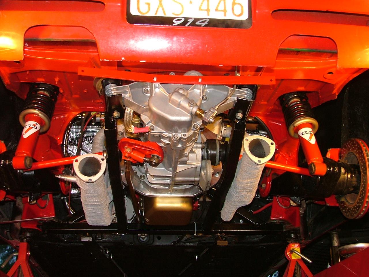

This is what 500HP looks like...
(IMG:http://renegadehybrids.com/914/Customers/RichardL/Pic02.jpg)

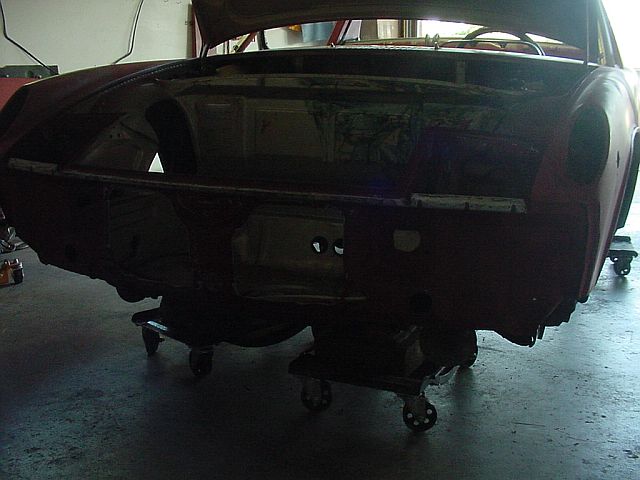

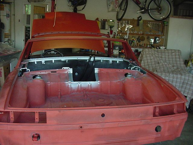

I made a lot of progress yesterday. I made all the cuts in the front trunk for the dual fan radiator and exhaust holes, the cut for the larger dizzy, removed the proportional valve and installed a tee, hung all four Renegade motor mounts, installed the rear konis with 200lb springs, prepped the engine compartment. That took longer than I hoped. Next step, bolt up one of my sideshifters to the chevy 305 and drop it in. I also picked up from a local trunk company all the green striped hose and clamps for the cooling. I have to go back to work for a rest, then attack it agan.

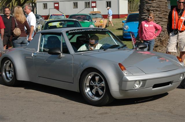

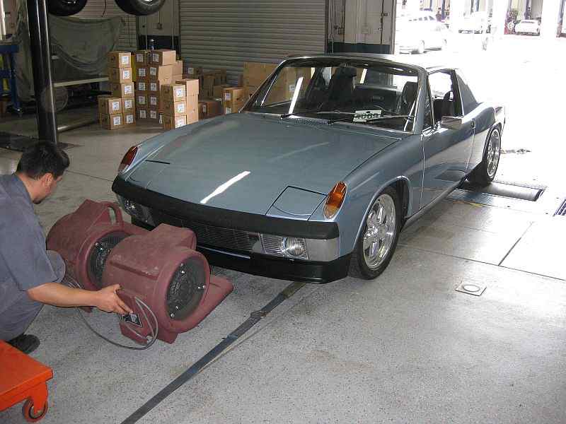

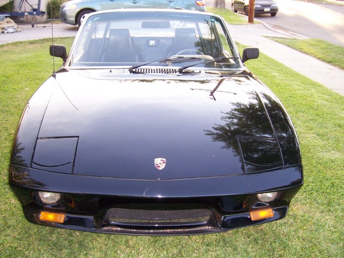

Here are some pics I have of various cars...

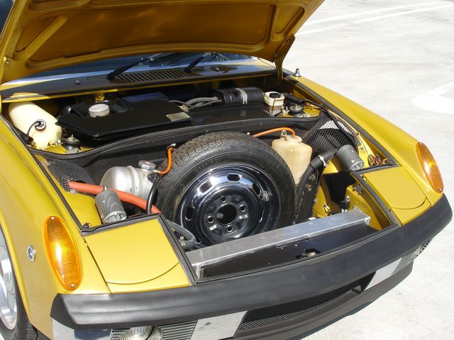

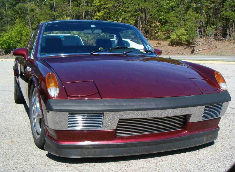

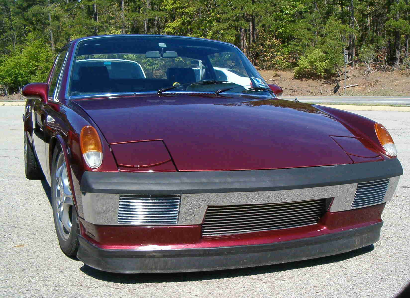

Here is my front end. With Renegades lower valence.

Just a question...are those jackstands sitting on coaster dollies? Be careful it does not fall on you........ stationary jackstands are one thing...when they become a rolling jackstand..I dunno...scary! (IMG:style_emoticons/default/blink.gif)
