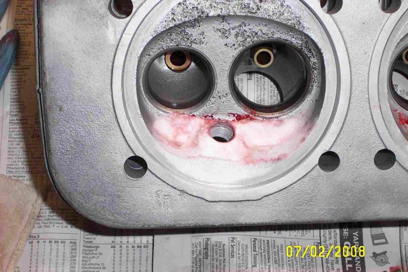

Crackage

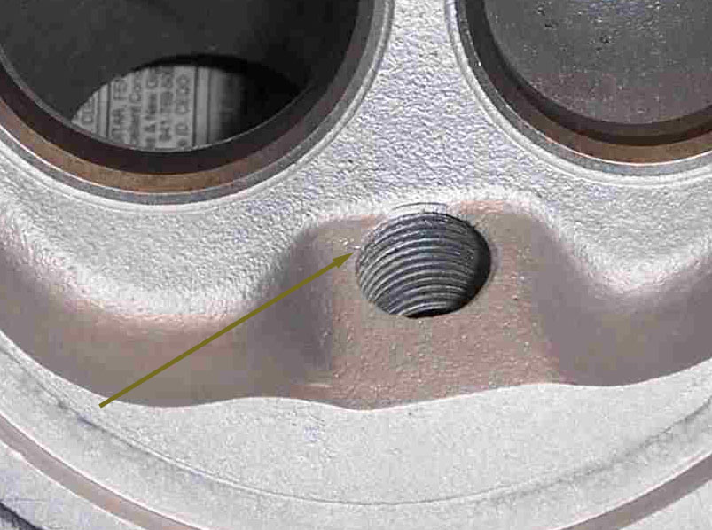

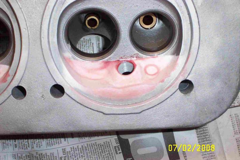

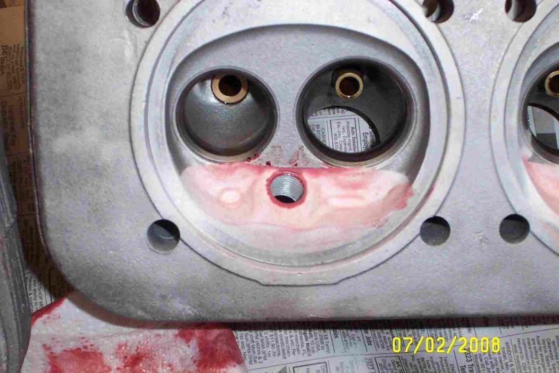

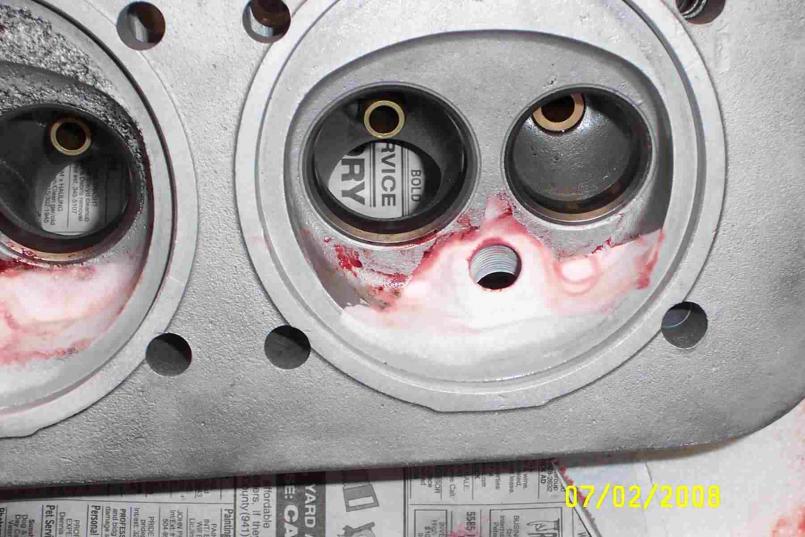

Here are some additional photos. Many years ago I did a lot of NDE and I still have some dye penetrant. While this may not be the best test for cracks in this application, its better than my old eyes. The first picture is the pitted chamber. The next is the other chamber that indeed shows the start of a crack(s). Jake has a good trained eye. The next two are of the other head.
By all the comments I suppose the one head is scap. I was hoping to be able to slightly buff out the rough spots (pitts) and use as is until the cracks appeared.
Jake, if most 2-liter heads have cracks, does that imply that most 2-liter cars on the road are running with cracked heads, yet still operating okay? The cracks you see in this head, pitting aside, could it be used on a stock motor or is this wishful thinking and as pointed out, the head could become a book end!
Thanks to all for the time to read and respond.

Unlike water-cooled heads, air-cooled heads can run for some time with cracks, and quite often do! The problems begin when the cracks spread far enough to reach a valve seat (on T4 heads these usually begin under the ex. studs) or until they migrate up the spark plug threads (big problem on the 2.0 heads) and the plug blows out or carbon wicks up the crack and interlocks the sparkplug to the head. That's when the head strips during plug changes.
BTW there is a second crack in the photo that Mark is using to point out a crack. Look over at about 2 0'clock on the plug threads. There is another crack forming that, left unrepaired, will head up the plug threads and toward the ex. seat.
It's one thing to drive around with cracks that are yet to be discovered, but to reassemble an engine using heads that have cracks known to cause trouble is gambling.
If I had a dollor for every 2.0 head I've worked on that had 0 cracks it wouldn't have paid for my lunch today!
Tyhats the first one I saw.
these heads crack in the same places time and time again.

To much dye and than to much developer. After the dye dwells for like 30 minutes, wipe it all off. Than use developer to draw it out of the crack. Very light misting not like a coat of sandable primer.
