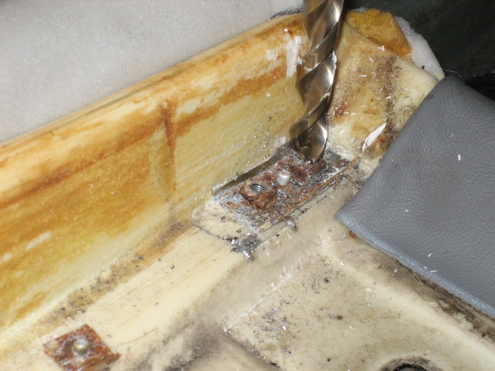

QUOTE(atomix8 @ Jul 24 2008, 06:48 PM) *
Any secrets on the seat (PB Blaster, etc), or did you just tug like hell? (IMG:style_emoticons/default/wink.gif)
luckily I was able to remove the seat with the intention of putting in racing seats. But what I did was I removed the upholstery and the foam and then I drilled out the retaining nuts for the seat mount. My goal was to preserve the floor brackets I'll post pics later

Stripped interior---drilling out the nuts

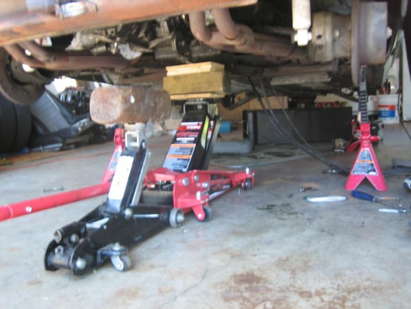

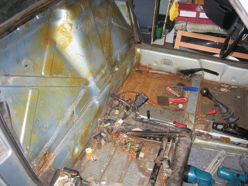

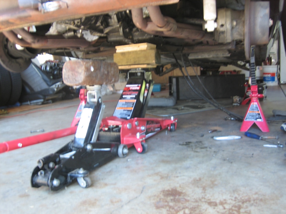

So, updates for the weekend
-the engine is out!!!! my brother and my two friends came over to help with the removal. all went well. got a little hung up on some of the engine tin, but easily fixed with a little massaging of the tin.
-removed the rest of the floor tar, so now the entire floor and backpad is ready to be sanded/grinded down to bare metal then I will por-15 the entire inside.
here are some pics...
