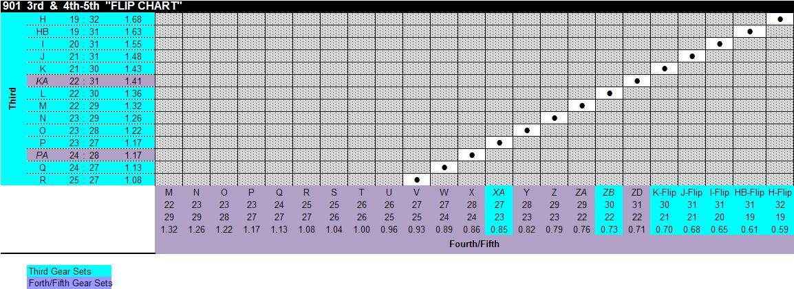

The ZD 5th gear in the 914-4 trannies is the highest 5th that Porsche made for 901's. That's the one that people flip around for a KA 3rd which is almost like an M 3rd. The 914-6 5th is a ZA which is even lower. If you want a higher 5th you'll need bigger OD tires or a different ring and pinion and either will make all of your existing gears seem higher. There might be aftermarket 901 gears available at some point, I head a rumor that a tranny parts manufacturer will be producing brand new gears for us in '09 but I don't think that they'll be cheap, nothing is except Top Ramen.

The best way to get a taller 5th is to flip an H second and put it in the 5th spot. A stock ZD is a .710 ratio, a flipped 3rd (N) is a .793 ratio. You want a smaller number, thus a flipped N will give you a shorter gear. A flipped H is .594 and a flipped HB is .613. The H series are the easiest, most straight forward and cheapest (about $500 or less) way to get taller gearing in 5th.

There is H, HA and HB. IIRC, you can not use HA as it is too small of an internal fit, but the H, and I know for sure the HB are perfectly fine.

Here's the '901 gear flip chart'
This chart, along with the gear ratio worksheet is available here:
http://www.914world.com/bbs2/index.php?showtopic=79893
Coincidentally, the Re-gearing tech article includes an example auto-cross setup that shows flipping 3rd & 5th making a A-F-Ka-V-Z (IMG:style_emoticons/default/smile.gif)
