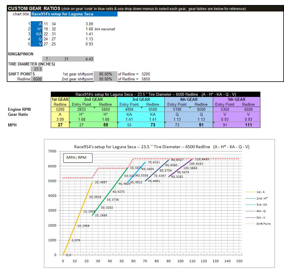

race914
post Dec 25 2008, 12:34 PM
73 914-4
Posts: 1,006
Joined: 31-October 05
From: Nipomo, California (Central Coast)
Member No.: 5,027
With Santa's help, I just finished gathering the parts for my Laguna Seca gear setup: 904 mainshaft with A-H-Ka-Q-V. Here's the chart from the Gear Ratio Workbook link in this thread.
The issue I'm working is turn 11 which leads onto the main straight. The stock F 2nd was too low, and my Ka 3rd was a little too high. The turn before the longest straight is the most important turn related to lap times, and I was probably losing a couple car lengths there when I'd lose my momentum in traffic, so this was my highest priority off season improvement.
The H second will let me take that turn around 4K rpm. The video of the the original setup A-F-Ka-Q-V is here. Will post the results once I get the upgrades done and get back to Laguna.
Thank you Santa! (IMG:style_emoticons/default/santa_smiley.gif) (IMG:style_emoticons/default/bye1.gif)
