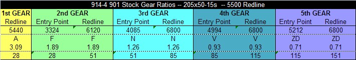

As a baseline, the Stock 914-4 gear ratio chart is below. Note that 1) Porsche uses letter codes for its gear sets (“A” thru “ZD”) you’ll see this notation whenever 914 901 gear ratios are discussed, and 2) The letter codes refer to the number of teeth on each gear of the pair, e.g. “A” = 11:34, this is important since some gear sets have letters stamped on them that are not related to the actual ratio. The stock 914-4 901 gear set is “A”-“F”-“N”-“V”-“ZD”. The complete gear ratio table, along with teeth counts, is included in the 914 901 Gear Ratio Excel sheet.
Figure 1. Stock 914-4 901 Gear Ratios, with 205-50x15 tires and a 5500 RPM redline

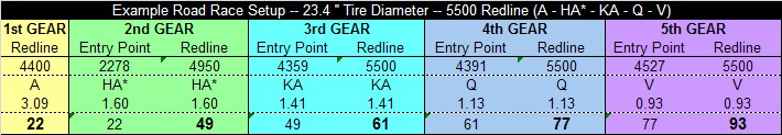

Figure 2. Example Road Race setup, with 205-50x15 tires and a 5500 RPM redline
The setup in this example “KA”-“Q”-“V” is also one of the economy short gear sets:
  • 3rd – your stock “ZD” 5th is ‘flipped’ to make a “KA” and moved to 3rd
  • 5th – your stock “V” 4th is moved to 5th
  • 4th - You need to find a “Q” gear for your new 4th
See the “901 3rd & 4th-5th “FLIP” Chart” on the 914 901 Gear Ratio Workbook for more info on ‘flipping gears’.
Another popular combination for longer tracks is M”-“S”-“X”. Of course what will work for you is dependent on your tire diameter, engine power band, and the specific track you are tuning for. That’s where the spreadsheet comes in handy to do your “what if” calculations to model your RPM and MPH at your shift points before buying and changing out any gears.

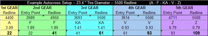

Here is a setup that requires no new gears to be purchased. By ‘flipping’ the stock 3rd & 5th gears you get a lower 3rd gear and a 5th that is still acceptable for short trips on the highway. See the “flip chart” on the 914 901 Gear Ratio Workbook:
  • 3rd - Stock “N” becomes a “KA”
  • 5th – Stock “ZD” becomes a “Z”

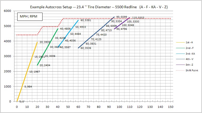

Figure 3. Example Autocross Setup, with 205-50x15 tires and a 5500 RPM redline
You can see from the graph that this setup give close ratio gears for 1st - 3rd and leaves 4th & 5th for getting to and from the event. The next step for your Autocross setup is to dial in your 2nd gear. If the “F” 2nd isn’t working out for your typical autocross MPH, try the “GA”, or “GB” main shafts in the model. If they don’t fit the bill either, you’ll need to a) find a 904 main shaft so can you can interchange gears same as with the 1st and 3rd-5th positions, or b) consider the alternative for other 2nd gear options noted in the Summary section below. Of course what will work for you is dependent on your tire diameter, engine power band, and the situations you are tuning for.
