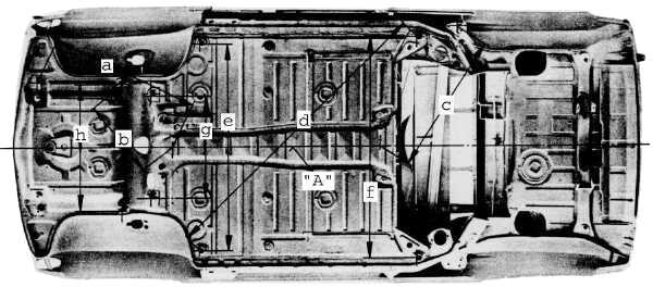

914 Underbody Dimensions
dim. description distance description
a Distance from form bead center to outer hole of front reinforcement for suspension seat 895 mm, 35 1/4" Fasten an approximately 125 mm, (5") long M10 bolt into the outside treaded hole of the suspension seat. Bolt protrusion (to top of bolt head) should be 104 mm, (4 3/32"). the measure from center of form bead to center of bolt head.
b Distance between form bead center and seat of transverse front suspension tube 473 mm,
18 5/8"
Measured directly between hole center and form bead center
c Distance between form bead center and the rear outer hole of the suspension arm attatchment 846 mm,
33 5/16"
Fasten an approximately 230 mm (9") long M10 bolt into the suspension seat. Bolt protrusion (to top of bolthead) should be 182 mm, (7 5/32"). then measure from center of form bead to center of bolt head.
d Diagonal distance across rear floor between front and rear locating recesses 17601 mm,
69 9/32"
Measured between hole centers
e Distance between front locating recesses 1184 mm,
46 5/8"
f Distance between rear locating recesses 1272 mm,
50 3/32"
g Distance between the rear reinforcements for suspension seat 590 mm,
23 7/32"
h Distance between attatching points of front transverse suspension tube 726 mm,
28 19/32"
