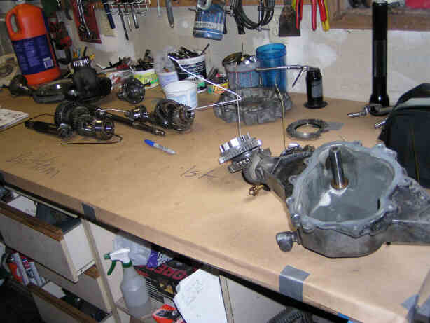

Lots and lots of parts that are hard to keep track of. And lots of cleaning.

This started as a grind in 1st and 2nd. I used Bondo's and Red Beards info to get it apart. One thing I would advise is take it apart before you order parts cause it may be worse than you think and surprises are expensive. I invested in some syncros, dogteeth, gaskets and such before I found this. The price tag just went up.
