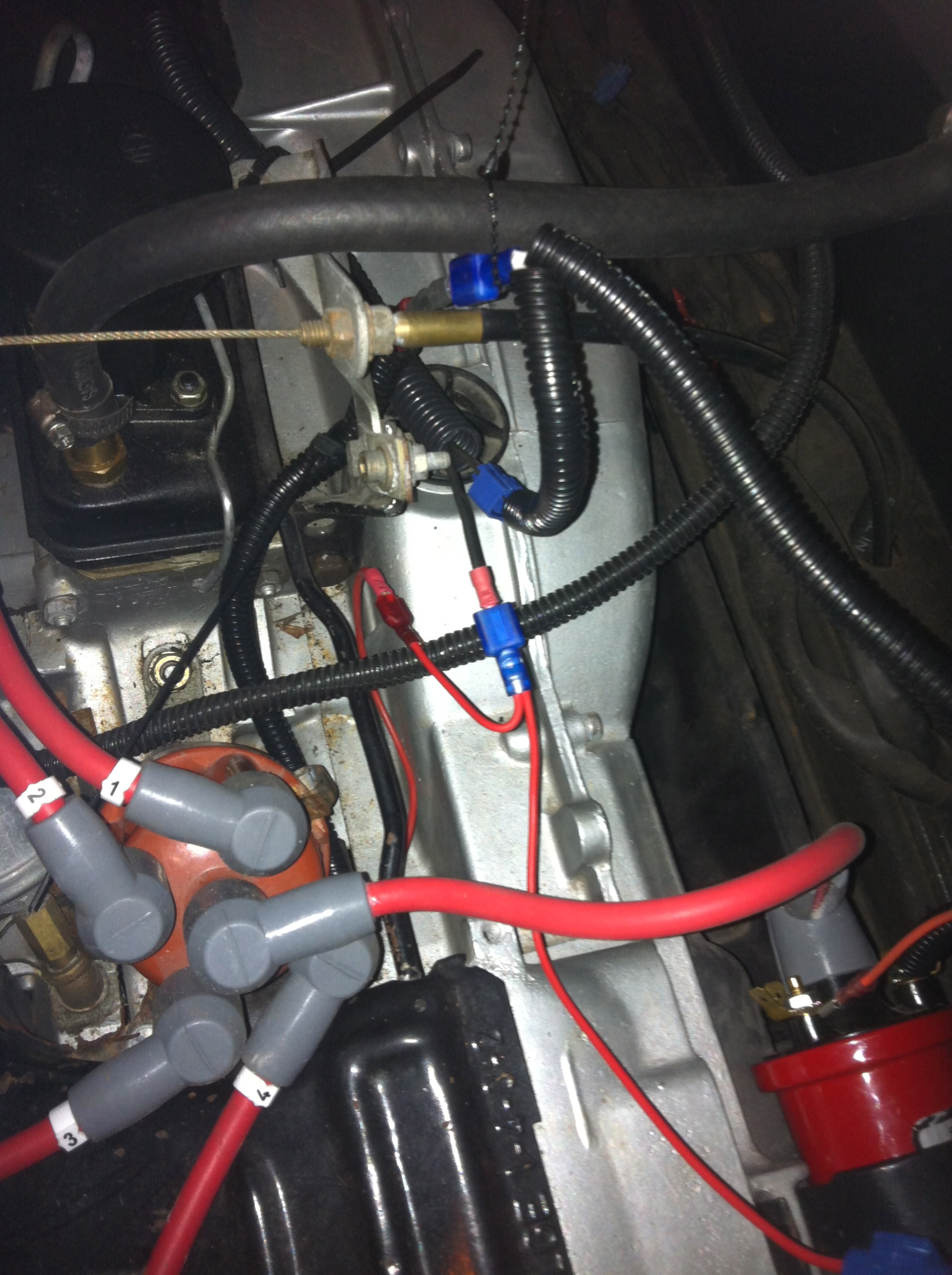

I just Installed a MSD 6a WHAT A difference 100% (IMG:style_emoticons/default/aktion035.gif) (IMG:style_emoticons/default/driving.gif) (IMG:style_emoticons/default/biggrin.gif)
Now my tach will not work. I have searched the forum for what I need to do. I have found no real answer some use the MSD adapter 8910 others the 8920.
I have a 73 fuel injected 2.0 with pertronix. According to MSD the 914 (mine) the tach wire used to go to the Negative of the bosch coil and it is called a Voltage Trigger and says to use the 8910. I have read others using the 8920 with no problem. below are two diagrams I found. Which is the correct one to use

I Installed the MSD adapter 8920 according to the diagram above it worked PERFECT.
THANKS jasons
JC
(IMG:http://i176.photobucket.com/albums/w177/JCD404/IMG_3316.jpg)

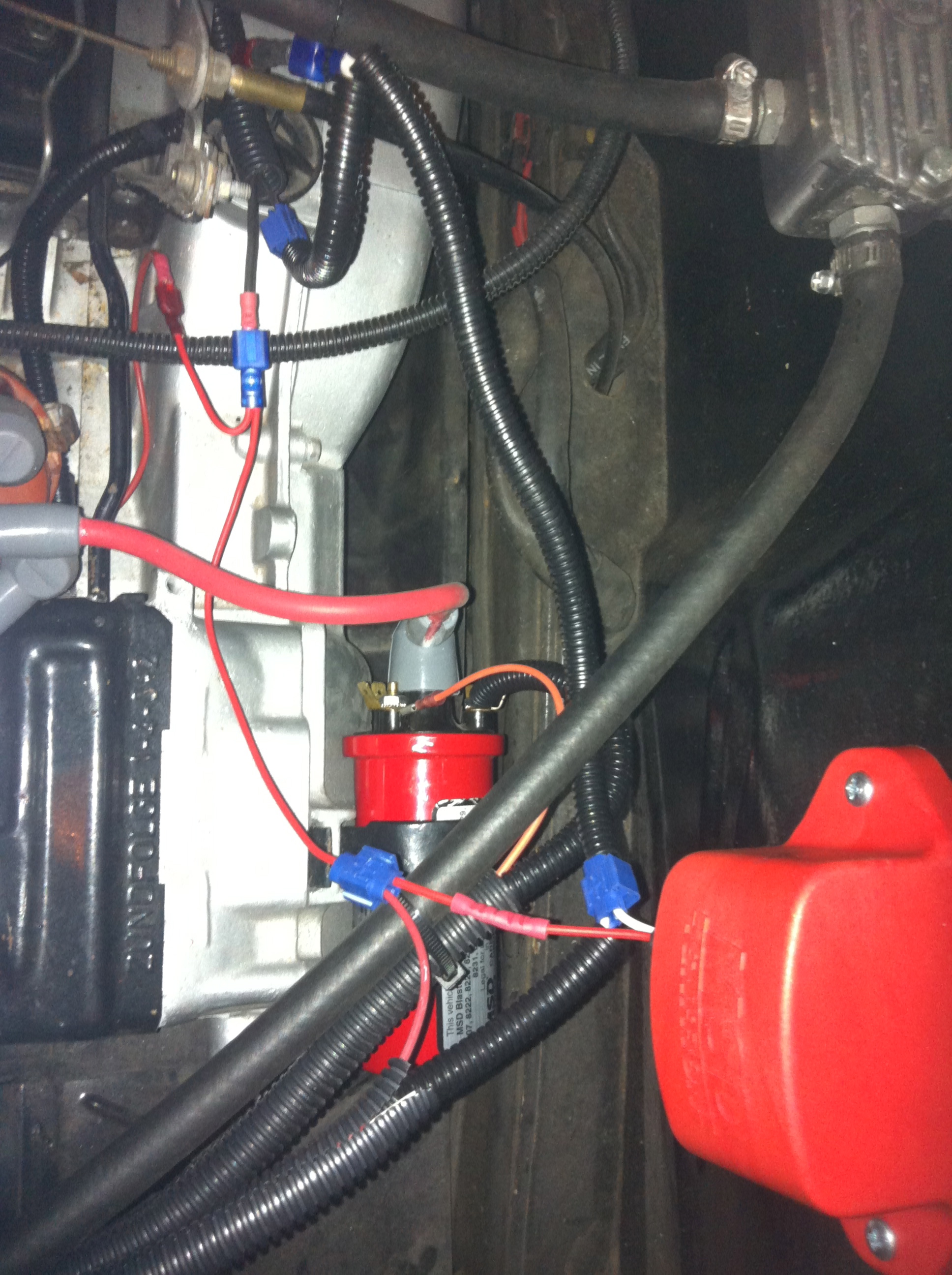

Hello,
I just installed my MSD 6A and I cannot get the engine to run. It will only crank. I used the diagram above for the 8920 tach adapter. I unplugged everything and connected the original set up and it runs, so everything works. Any suggestions as to what I am doing wrong?

reese5997
post Jan 20 2013, 05:32 PM
Posts: 20
Joined: 2-January 13
From: washington dc
Member No.: 15,334
QUOTE(Kirmizi @ Jan 20 2013, 02:04 PM) *
I suppose my first question would be, are you sure the MSD box is good?
Have you double-checked all of your wiring and connections?
Mike
For some reason the stock diode with the male and female endings already crimped in place was backward. I removed the diode and the engine fired up in 30 degree weather instantly. I did not have engine run-on when I turned it off so I left it off. So I am good to go.
