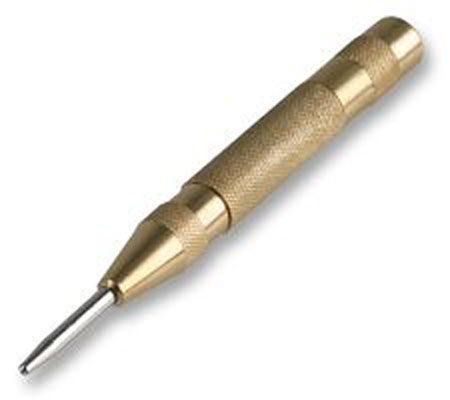

I took a small spring loaded center punch and used it from the inside of the door. It dimpled the skin on the outside exactly where to drill No guessing, no measuring, super easy.

I drilled mine from the inside out. However the doors were gutted at the time I did it. If your windows are in that won't work. I don't know if you have seen an automatic center punch but that would work perfect. When pressed against the workpiece, it stores energy in a spring, eventually releasing it as an impulse that drives the punch, producing the dimple. No hammer needed. You could use it in the inside and it will dimple the outside. I'm pretty sure you could get your hand in there to do that. Good luck.

That sounds like the safest bet ....... I will go pick up a spring loaded punch today (IMG:style_emoticons/default/smile.gif)!!! Thanks .............. I cannot wait to get that mirror on there (IMG:style_emoticons/default/biggrin.gif)!!

My 914 is a 1973 ...... I did the spring loaded punch from the inside ........ drilled the resultant points the punch created ....... cleared metal away from the threads with a dremel then touched up the bare metal to prevent rust ........ installed my new RH factory mirror with new screws and gasket ........... it looks great and works even better (IMG:style_emoticons/default/biggrin.gif) !!!!
