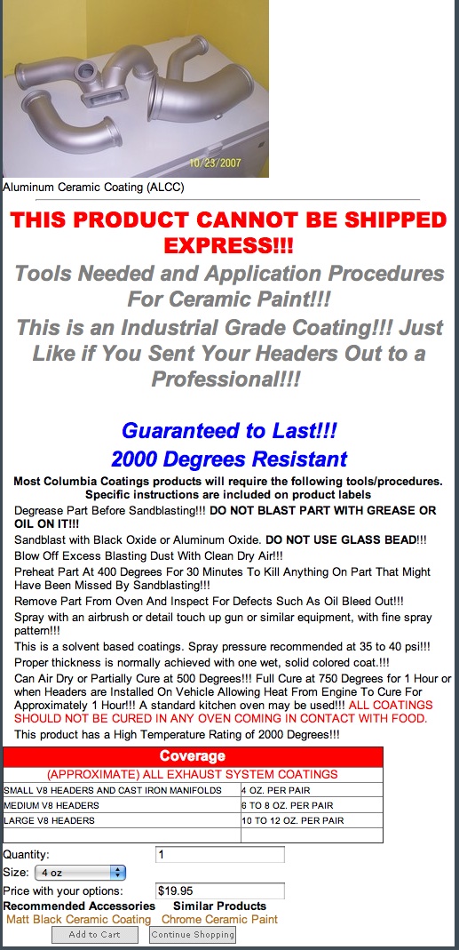

You can do it yourself if you have a powdercoat oven though I have heard of people using the heat of the exhaust to set the ceramic up. Check it out, save some bux........ Ceramic Coating

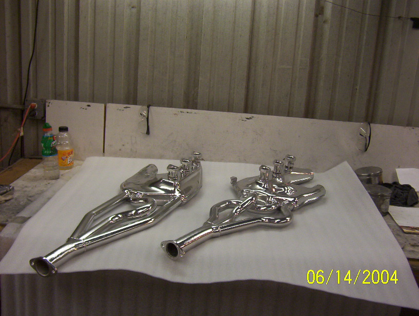

You want Ceramic Coating (Jet Hot) not powder coat. I've had a local company Ceramic coat and in the past have used Jet-Hot the company. I can say that I had a 914 melt into the ground and the only thing left was my Jet-Hot'd coated Kerry Hunter headers. There was nothing else left - nothing, no motor, no tranny, no wheels, no steering wheel - just the headers and they were in perfect shape.

Jet Hot did a nice job on my -6 exchangers several years ago, I certainly had no problems with their performance or turnaround time.
FWIW, I'd use them again.

Jet Hot can do a wonderful job on 914-6 heat exchangers.
I recommend them.
