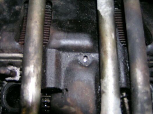

Here's the little asshole

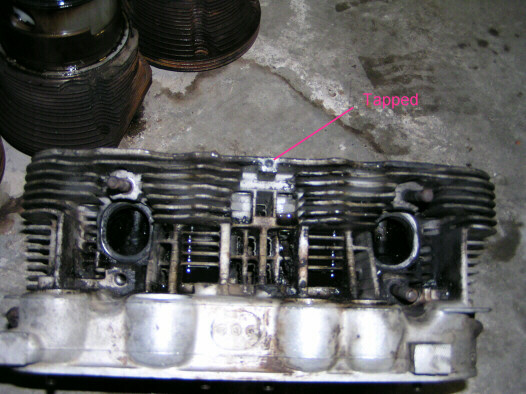

DNHunt
post Feb 28 2004, 06:46 PM
914 Wizard? No way. I got too much to learn.
Posts: 4,099
Joined: 21-April 03
From: Gig Harbor, WA
Member No.: 598
After several hours of messin with it. I finally got it out and the hole retapped to 5.0 X.8. I HATE CHEESHEAD SCREWS. (IMG:style_emoticons/default/ar15.gif) (IMG:style_emoticons/default/ar15.gif)
