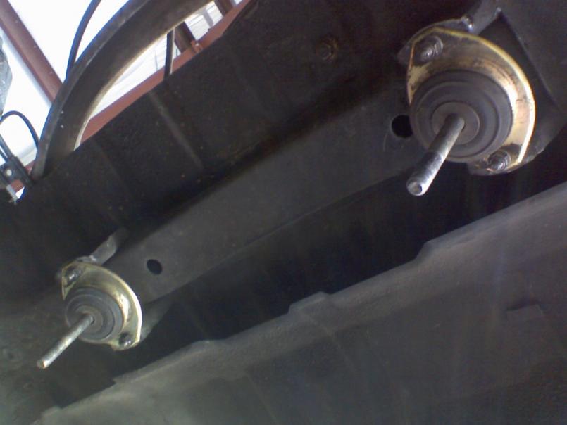

stock:
(IMG:http://www.914world.com/bbs2/uploads/post-8112-1240450643_thumb.jpg)

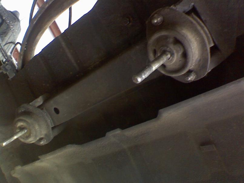

911 sport mounts:
(IMG:http://www.914world.com/bbs2/uploads/post-8112-1240450735_thumb.jpg)
the 911 unit has more of a solid center/design to hold things in place.

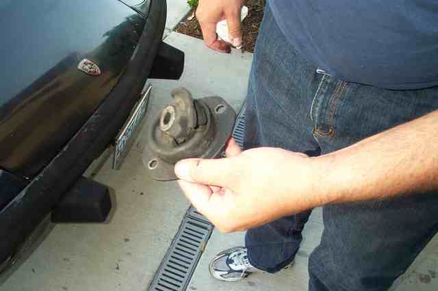

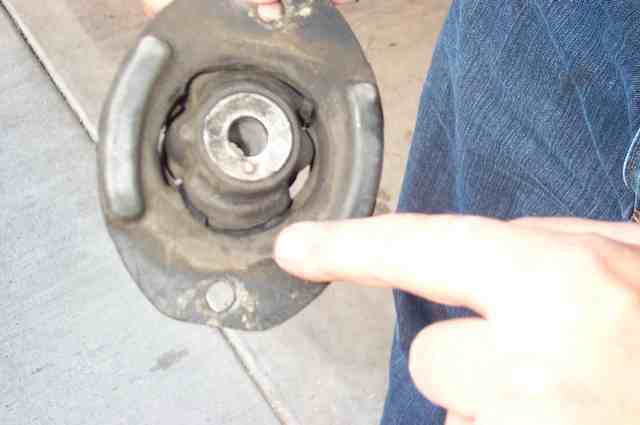

Here's what happens when the old mounts go bad:
Eric
