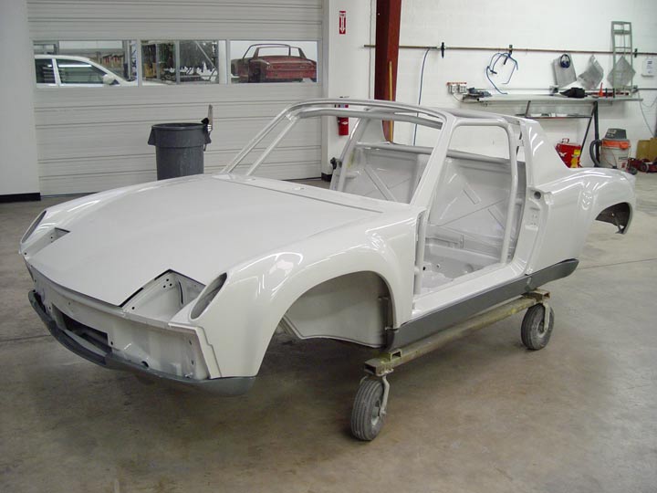

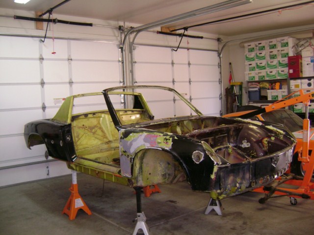

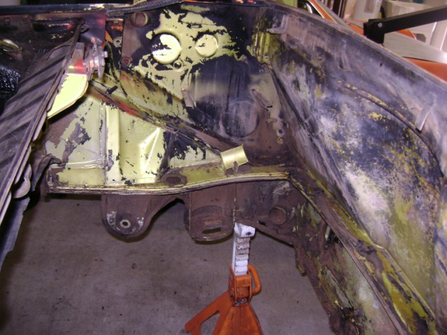

This is the start of a new thread and the progress I am making on this little 914 car. First off, let me give you a little history. I had a WANTED ad in the craigslist area for Tucson and PHX. I got a call from a man stating he had a 914 that he wanted 1500 bucks for. We talked about the car. It ran, drove and he said it would make the drive to Tucson. We talked a little more and we determined he would take 1300 bucks for it. I arrange a rental car, drove to Prescott, dropped off the rental and then met the guy. It was a little rough at first but the car did start and drive... Well? No. Badly... Yes. I decided to go for it and started out the drive. It did infact make it all the way home in the heat of the day and over the mountains. = ) Anyway, so its now home, on stands and ready to begin its new life. Here are some pictures to start the thread.

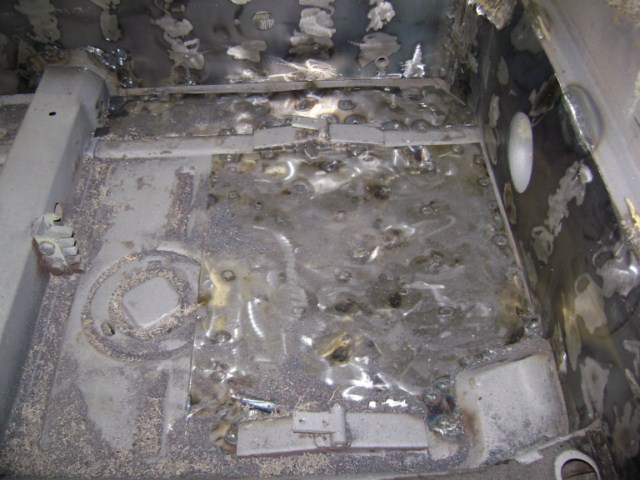

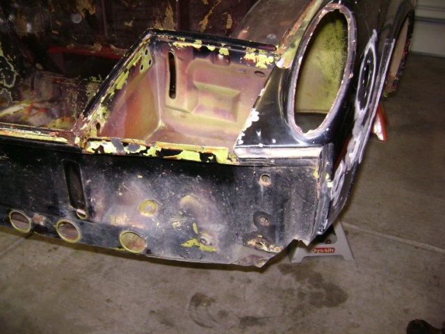

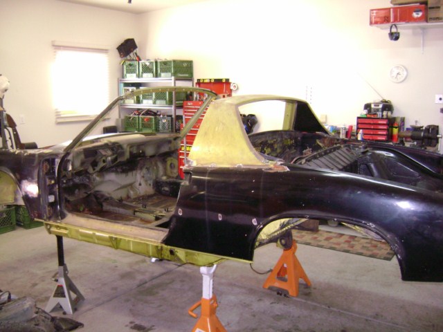

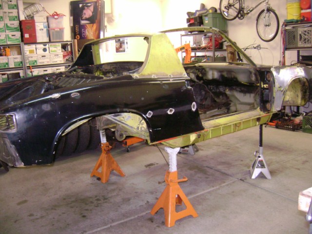

I have decided to take it down to the bare metal. After a week of a lot of hours in the garage, here is were we are at today. = )

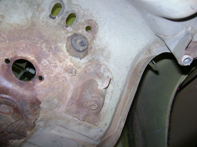

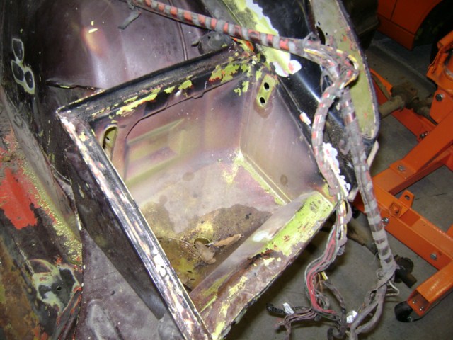

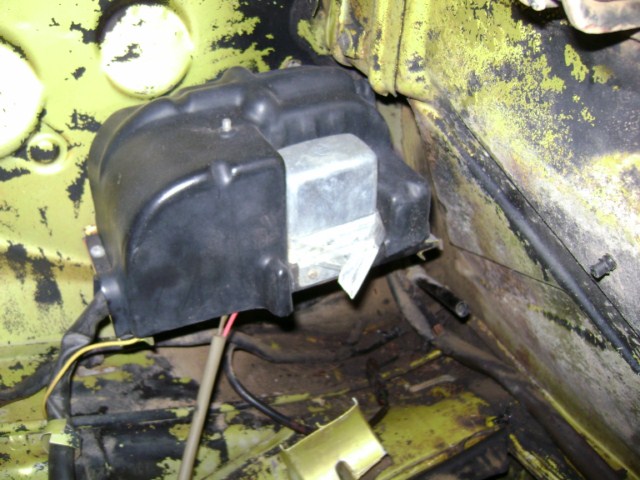

How do I get rid of this box (voltage regulator?)? I dont have fuel injection and I think its all empty except the battery side.

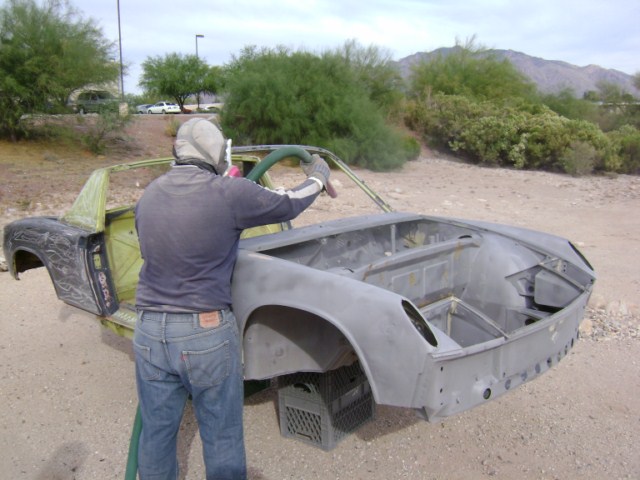

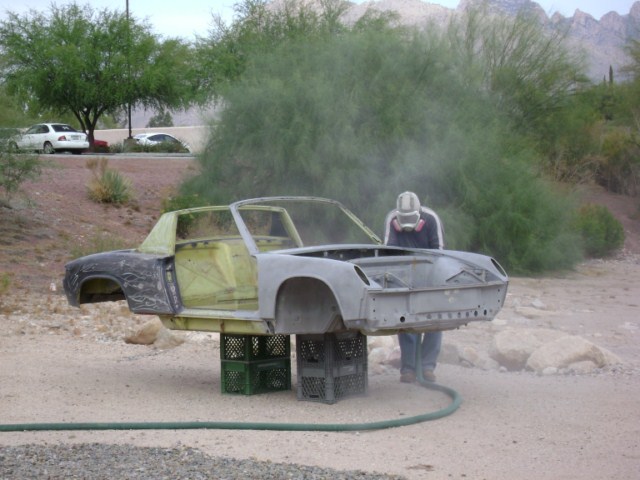

I was told that sand blasting the car is the best way to deal with the rust. It blasts it away (just what I was told) and you know exactly what needs to be fixed. I also was told that within about a week of your car sitting bare without a primer on it or something, that it starts to rust. But I also heard that if you primer it with POR its a problem for the painters(?).
So I was going to get it blasted so when I weld the longs and the rear end that its good perfect clean steel to steel.
LOL So what do I do? Anyone done this before?
I saw one post where the person did all the painting under the car themselves and then built the car and then took it to a painter to do the outside of the car... But I like Patrick Motor sports where they paint the entire car the same color.

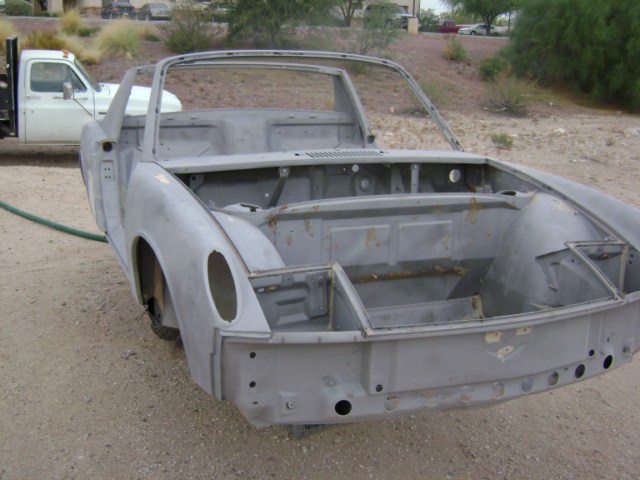

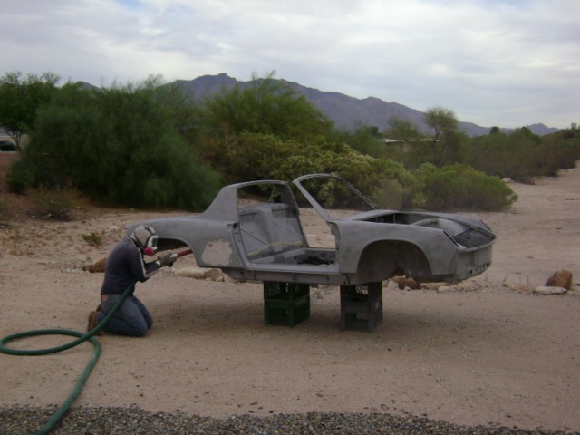

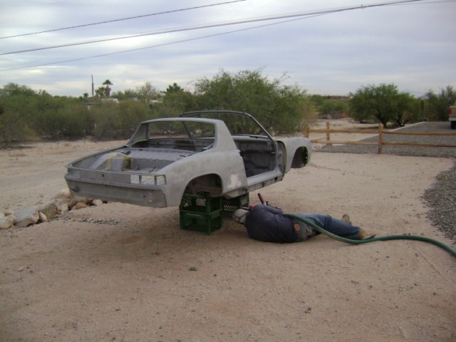

Well, I had it sand blasted. The guy came to my house with a buddy. We dragged it to the back 40, put it up on crates and got him started. It took him about 2:15 to do the entire car. He made sure that he didnt sit in one spot for to long to ensure no warping occured. I didnt realize there was so much bondo on the car... But now... There isnt even DIRT on the car. = )

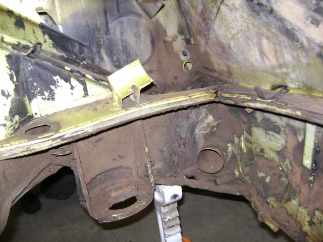

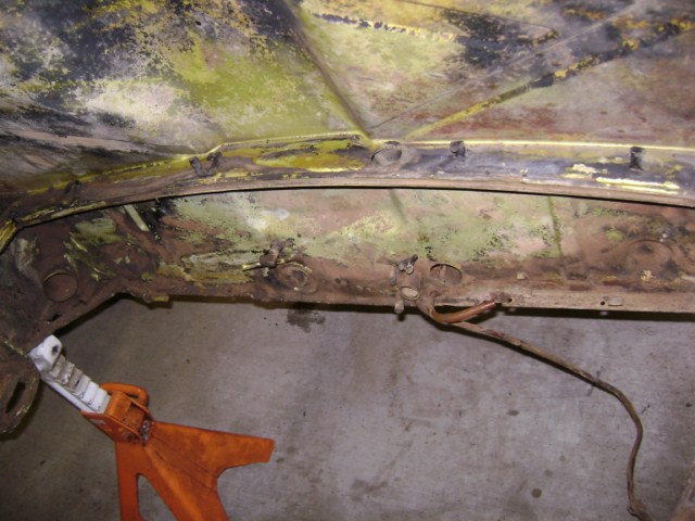

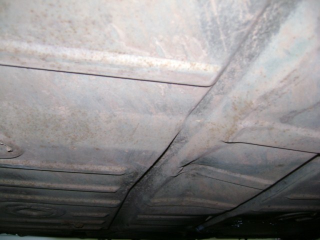

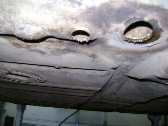

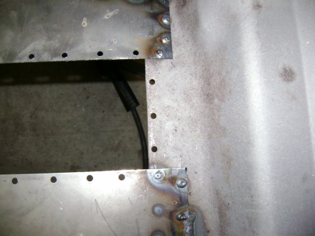

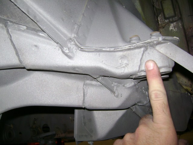

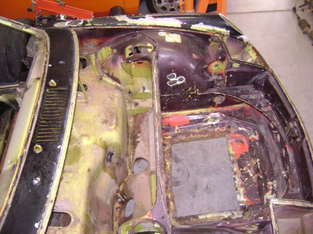

= ) Things are moving along. Are these added or factory? Need some input team. = ) Dont want to start putting a stiffening rear kit in if these are going to be in the way.
Eric

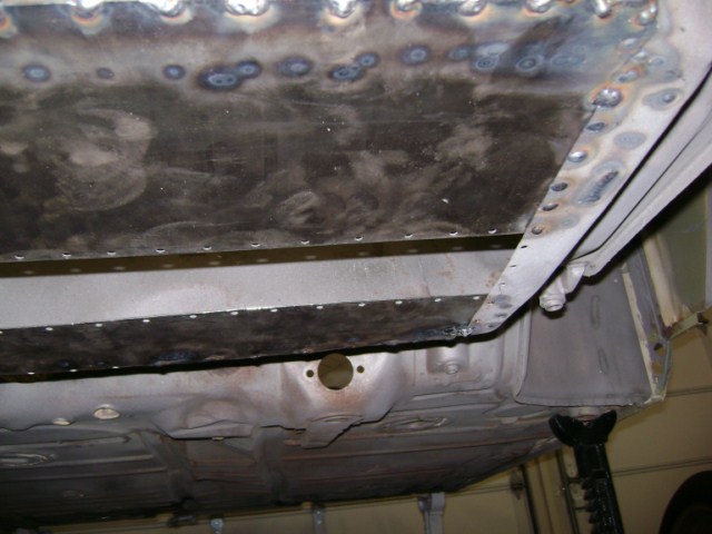

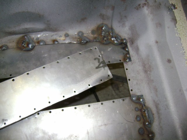

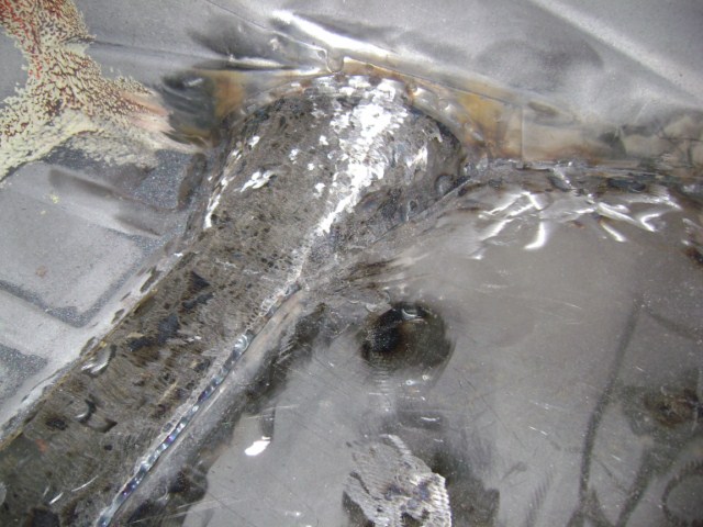

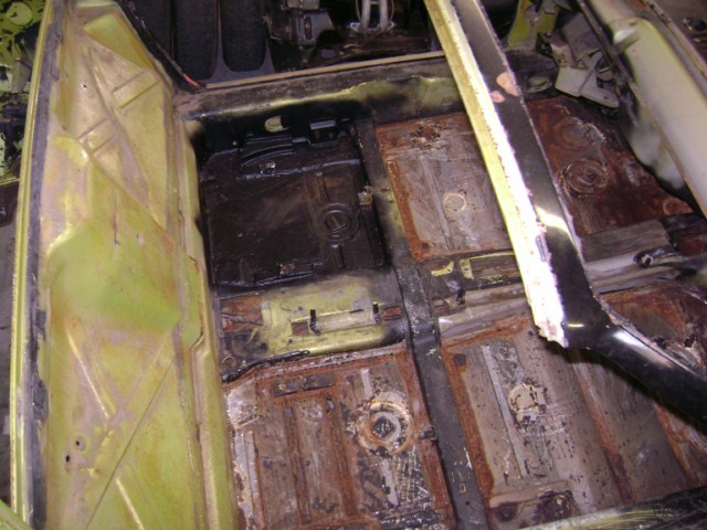

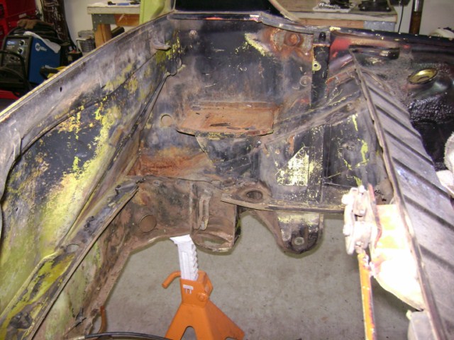

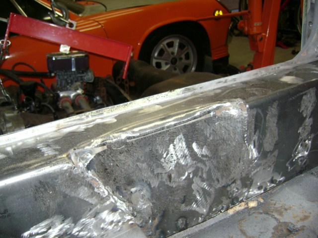

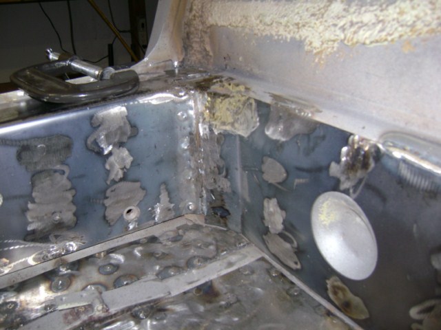

I just got the Engman Long Internal Kit installed. Looks good. Neat stuff. Easy to do.
Eric

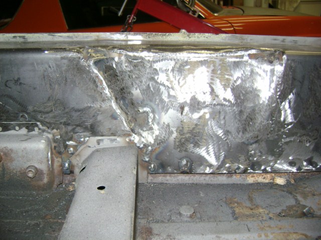

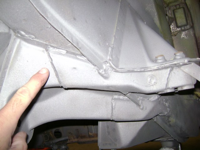

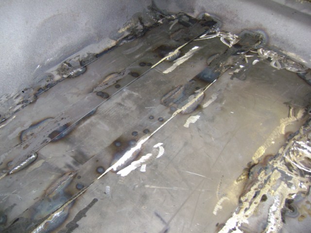

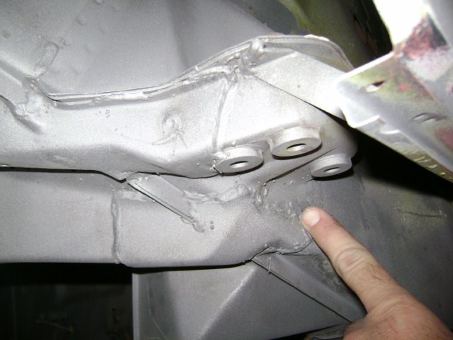

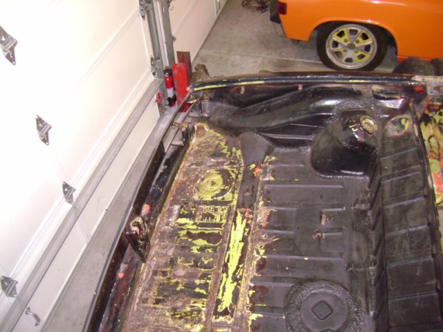

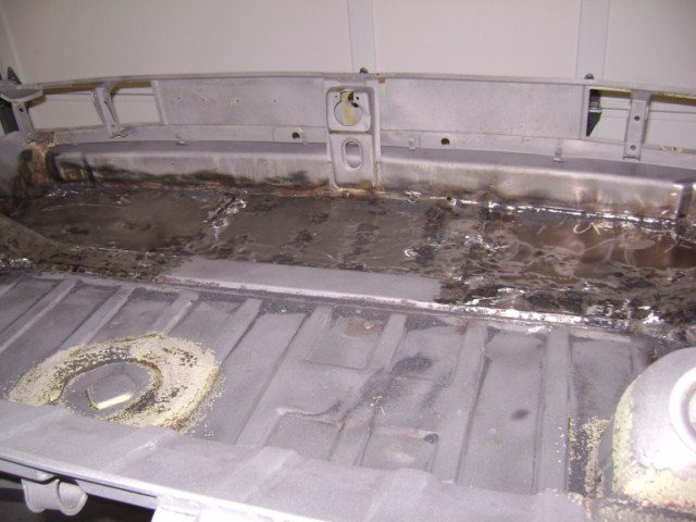

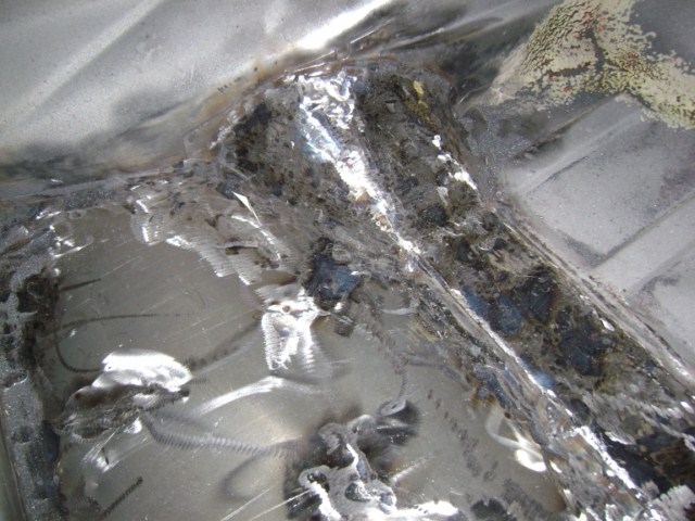

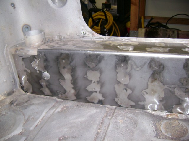

Stiffened the rear support and fixed the trunk area.
Eric

Put your door back on, RIGHT NOW. Before you go any further, make sure they still fit properly and that the body is in alignment. If the cars is twisted in any way from the addition of the longs, this is the time to address the fix. Also I would start blowing out the extra sand. I can't tell you how many times I used the air line and vacume to clean out the sand from every nook and cranny.
Have you paid a visit to your local auto paint store yet. These guys can be so helpful with advise. Pick a line of products and stay with it. They can help you figure out what fillers go with what primer and paint so the products stick.

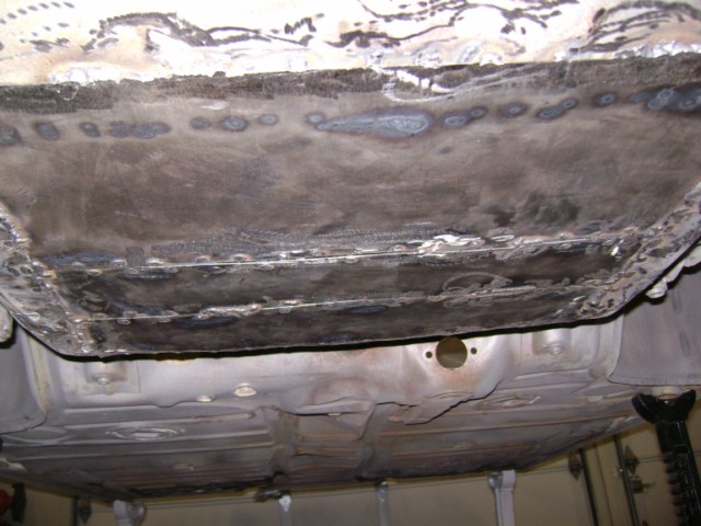

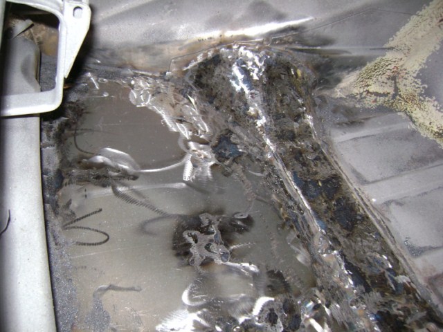

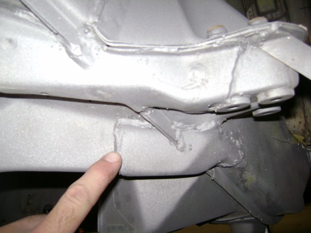

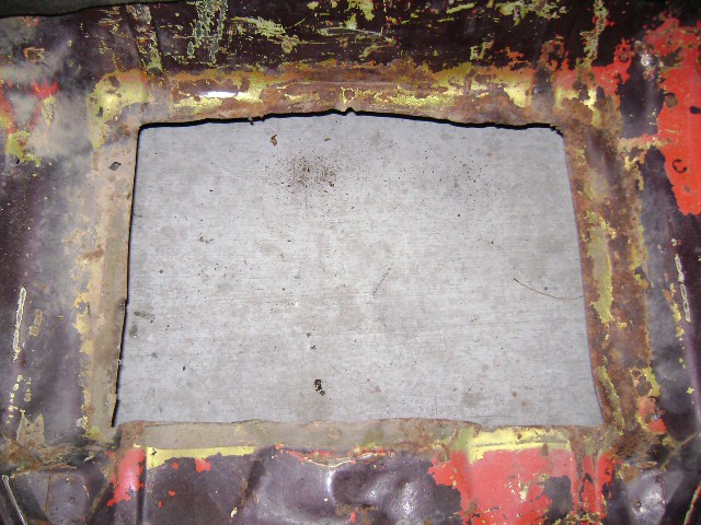

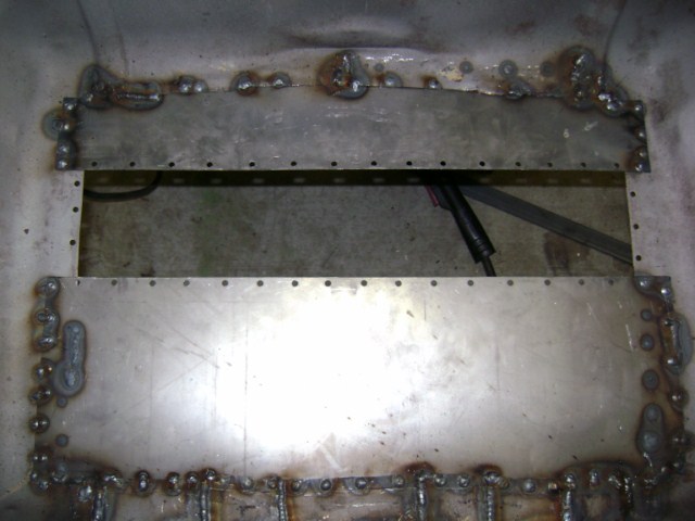

Here is the fixed hole where the AC unit used to be. Not as pretty as I would like but will be plenty strong for AX.
