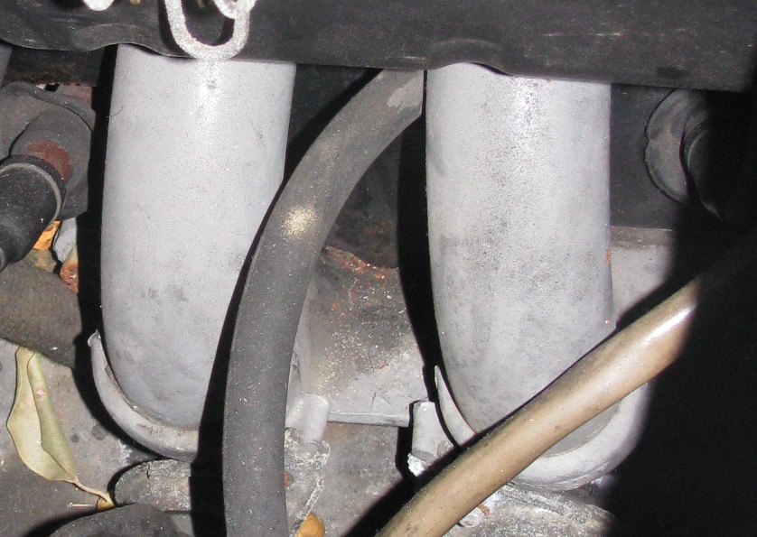

Tod, mine were never refinished & the cropped pic below I just found for you of my early-73 914-2.0's engine bay with a peek at them FYI. It almost looks like a satin or low-sheen grey enamel, but that could also be due to years of use & the mechanics cleaning them with stuff between 11/72 & 5/85 when it was a DD.
BTW - Wurth also makes a flat or satin grey, but I don't think it's hi-temp, & then there are several other hi-temp greys in flat & satin around.
IMHO - I don't think it was OE a zinc, but I could call my mechanic tomorrow & ask him if he recalls (Hans is an old hand German factory trained on the 914s)??
Hope this helps! (IMG:style_emoticons/default/biggrin.gif)

Don't ask how the H**L that leaf got in there, it's been on blocks in the Garage for 24 years, & only out a couple of times to change out the oil, etc.! ....must've dropped in from the tree above the garage/driveway then!
