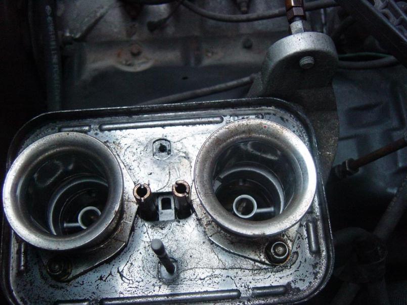

Here are some pictures

Another picture here too I forgot to post...it looks bad in the engine compartment but should be much better when spring arrives hopefully and I have a bunch of parts on order too.

As long as you are ordering from CB or ACE they are all "the same" (DCNF). There are a few different varieties, but they would not be a down draft and running on your car.

(IMG:style_emoticons/default/popcorn[1].gif) ...well in your particular case, you should remove ONE CARBURATOR, and inspect it for size and nominclature. designation may be stamped in the body or at the base, near the mounting flanges. Measure the THROTTLE BORE, butterfly, so you know what you,ve got. BEFORE YOU ORDER PARTS. they are not DCNF. they are IDF.(design type) downdraft carburators. (IMG:style_emoticons/default/popcorn[1].gif) murray

I notice your air cleaners are short and you have velocity stacks so you need check to see if you have enough clearance between the top of the velocity stacks and the air cleaner tops you need a minimum of 34 mm.

Hi, thanks...that helps a bit. I will be going with slightly taller filters so issues with clearance of the velocity stacks, they are the stock ones anyway.
