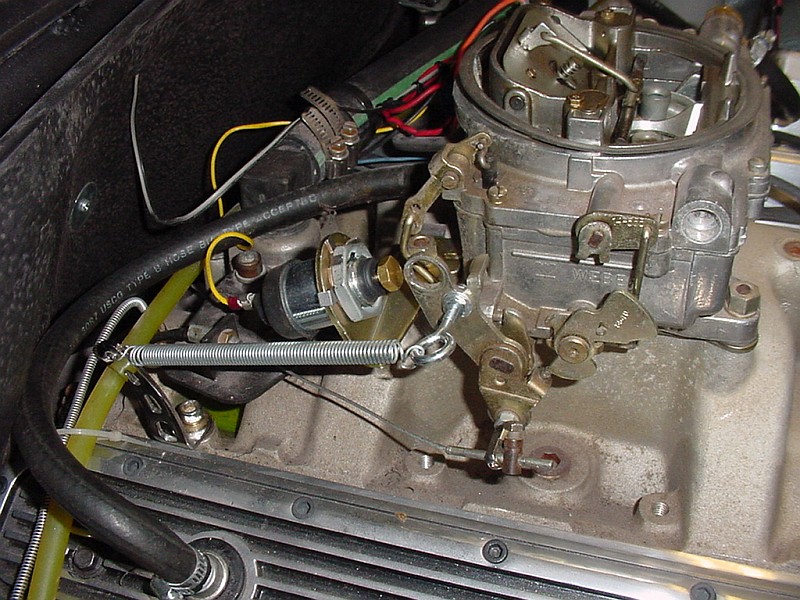

The hand throttle sounds like a nice tool for warming-up a cold engine, but quite frankly sounds dangerous as a "cruise control" as mentioned above. If your'e cruising down the road and have to react quickly, having the motor physically reved at cruising speeds is asking for disaster to strike. Perhaps I don't understand how the hand throttle works...does is release if the brakes are applied?
Another option for the "warm-up" idea, is using an "idle compensator" (on every junk 80's car) or Edlebrock sells them as well. Mount it to push your throttle linkage and put a on off switch in the cabin. It's throw is adjustable as well.
Here's a pic from my v8 application. It also works well for you teeners that have added AC....great way to increase the idle speed (if needed) when the AC is on.

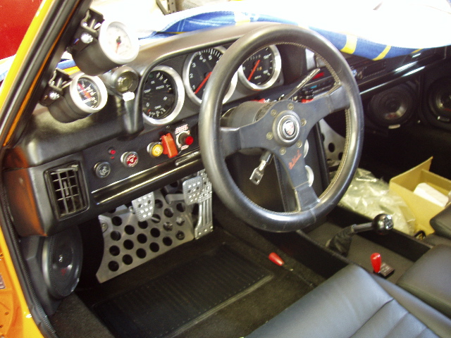

I had to reengineer mine so i could retain the center console, worked great for setting the break in RPM on the engines first start.
Visible red knob on side of tunnel.
