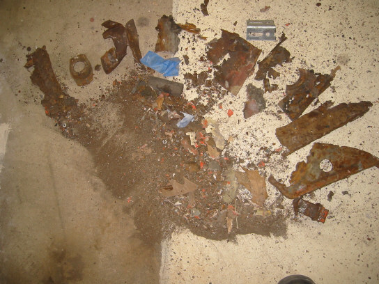

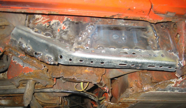

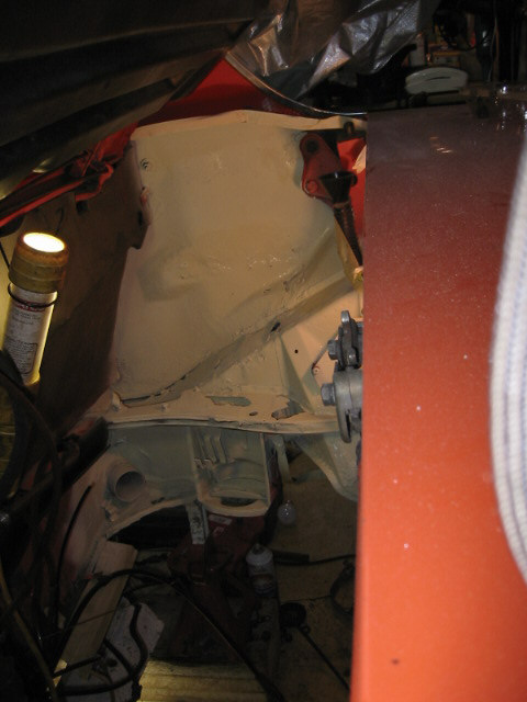

I forgot I had a standing mental note to remove engine and repair long/inner/engine tray in 2009. THE clunk was the last bits of the bottom of the long crumpling where it turns to go up to susp.console. About two months off schedule!
I investigated with an air chisel. This car had f/glass hellhole repair,and little sheet metal layers added to obscure condit of long down by floor jack tray. Spot repair of rocker jack point...all this is now in a bag. Restoration pcs quickly add up to 750$. For the time being i've patched the outer side of the long. The full repair entails fender snipping, and engine removing. Engine is working well, and I'm still not done loving my new 911 Sport trans Mounts.
The scope expands also. I've not mentioned outer firewall problems, and rear edge of floorpans. So for today I patch...
Any More thoughts?Besides changing the title of the thread?Attached ImageAttached ImageAttached Image
