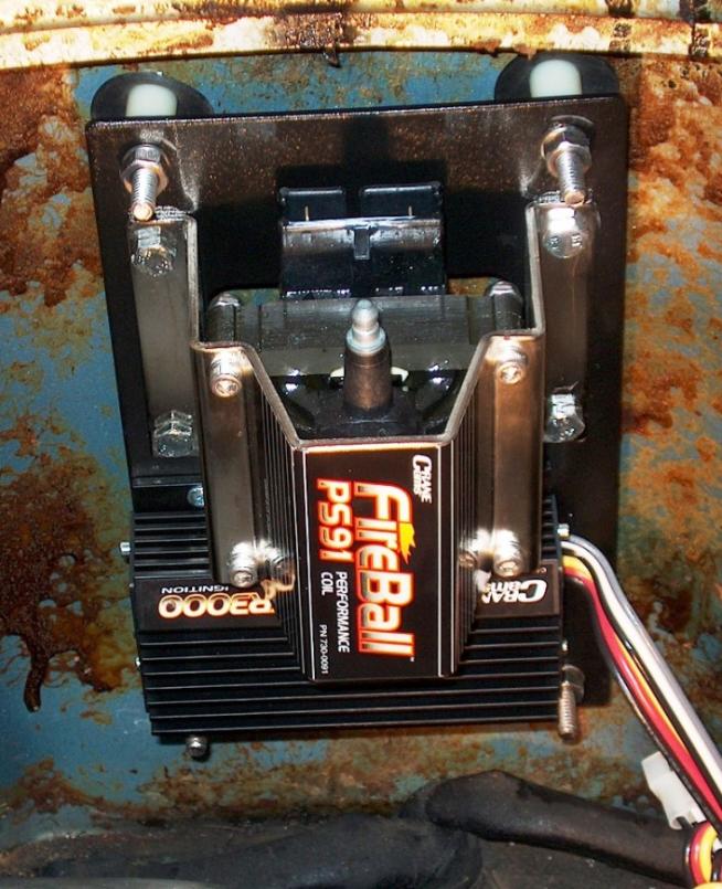

I made a plate, then painted it. The optical unit and the new coil mount to the plate, then it is mounted to the firewall with nylon standoffs and rubber isolation washers. Here's a picture (that's not rust, it's the glue from the engine bay pad).

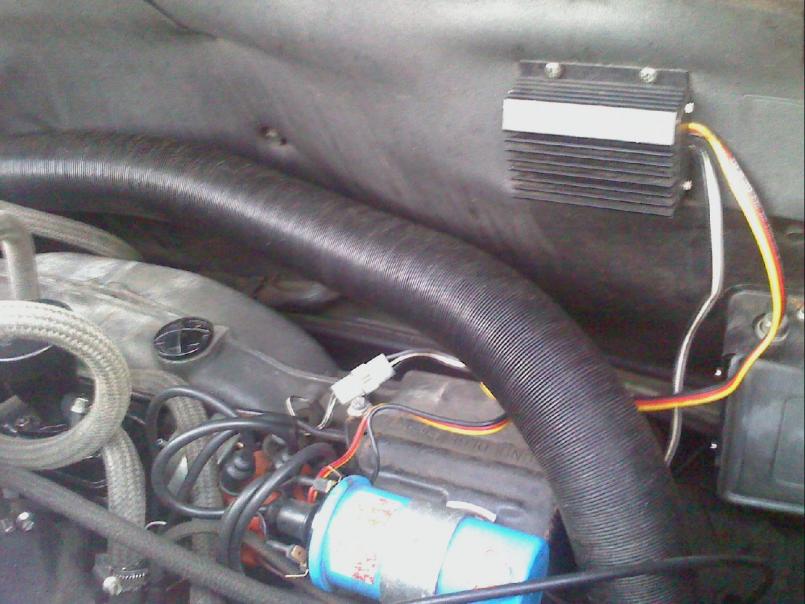

This is my finished set up with the crane "700", for stock 74 2.0. I do not know what your trying to do and have never seen before what you have pictured above so my stock application probably does not concern you but I thought I would throw in for anyone else maybe just wanting to use crane but for a stock application. I mounted the little black box on the fire wall but it could have been hidden w/ a little thought.. simple set up... It has been working perfectly for a couple years w/ a stock distributor and stock bosch blue coil.. 4 cylinder no mods..

I've had the setup in post #2 for about a year now. I really like it, in that it gives me a clean power range, with no points to adjust. I haven't touched it since it was installed.
I have the 205 disty off of a 1.7L installed on my 2.0L due to the wider curve, and Weber 40's. I'd recommend the system to most anyone.
