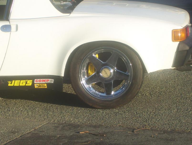

Spoke
post Jan 16 2010, 05:31 PM
Jerry
Posts: 7,438
Joined: 29-October 04
From: Allentown, PA
Member No.: 3,031
QUOTE(rickthejetman @ Jan 13 2010, 01:51 PM) *
my niner has a wrx engine in it now.
Did I miss pics of your car? Let's see what you got!
rickthejetman
post Jan 17 2010, 09:58 PM
Posts: 90
Joined: 5-May 09
From: victorville ,ca
Member No.: 10,335
rickthejetman
post Jan 17 2010, 10:00 PM
Posts: 90
Joined: 5-May 09
Member No.: 10,335
rickthejetman
post Jan 17 2010, 10:08 PM
Posts: 90
Joined: 5-May 09
Member No.: 10,335

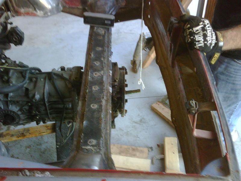

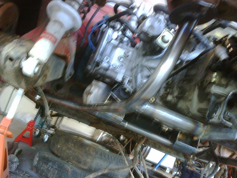

sorry for the crappy cell phone pictures my digital is broken. i'm no fabricator i'm just an airplane mechanic thats learning this as i go along. so no mean coments on the poor quality. its strong it will hold thats all that matters to me.Attached Image

my trunk was totally rotten so it didn't bother me to cut it out. so my engine ended up nice and high and ground clearance is perfect.
