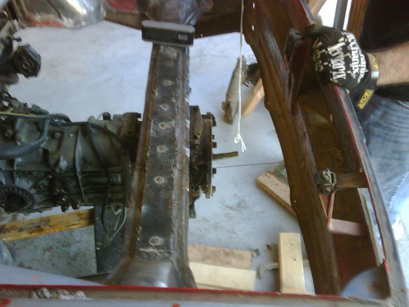

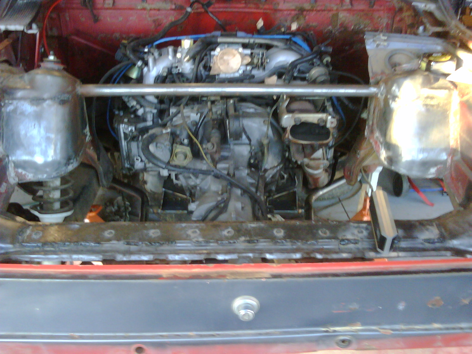

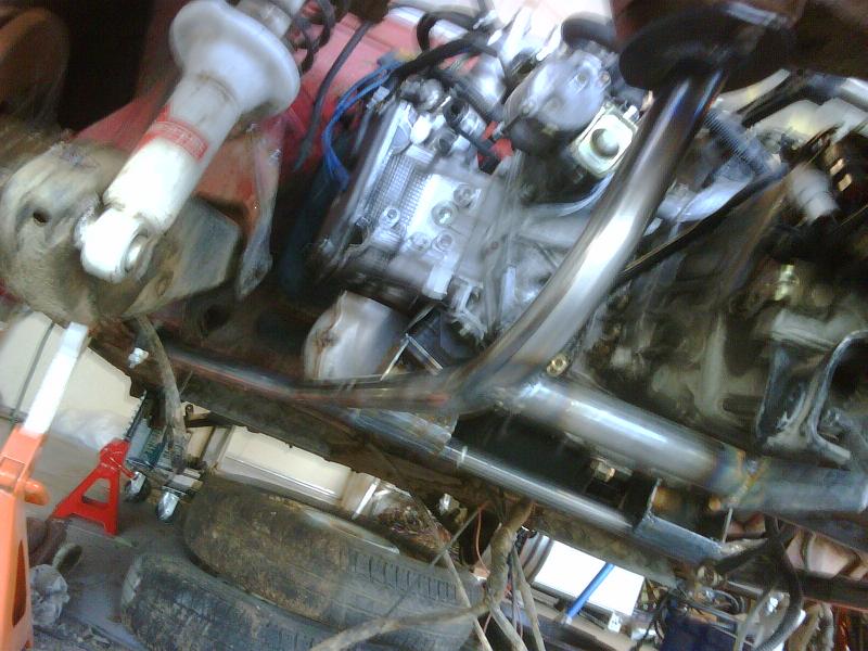

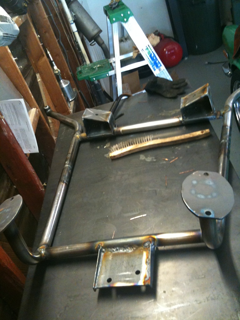

sorry for the crappy cell phone pictures my digital is broken. i'm no fabricator i'm just an airplane mechanic thats learning this as i go along. so no mean coments on the poor quality. its strong it will hold thats all that matters to me.Click to view attachment
rickthejetman
my trunk was totally rotten so it didn't bother me to cut it out. so my engine ended up nice and high and ground clearance is perfect.
