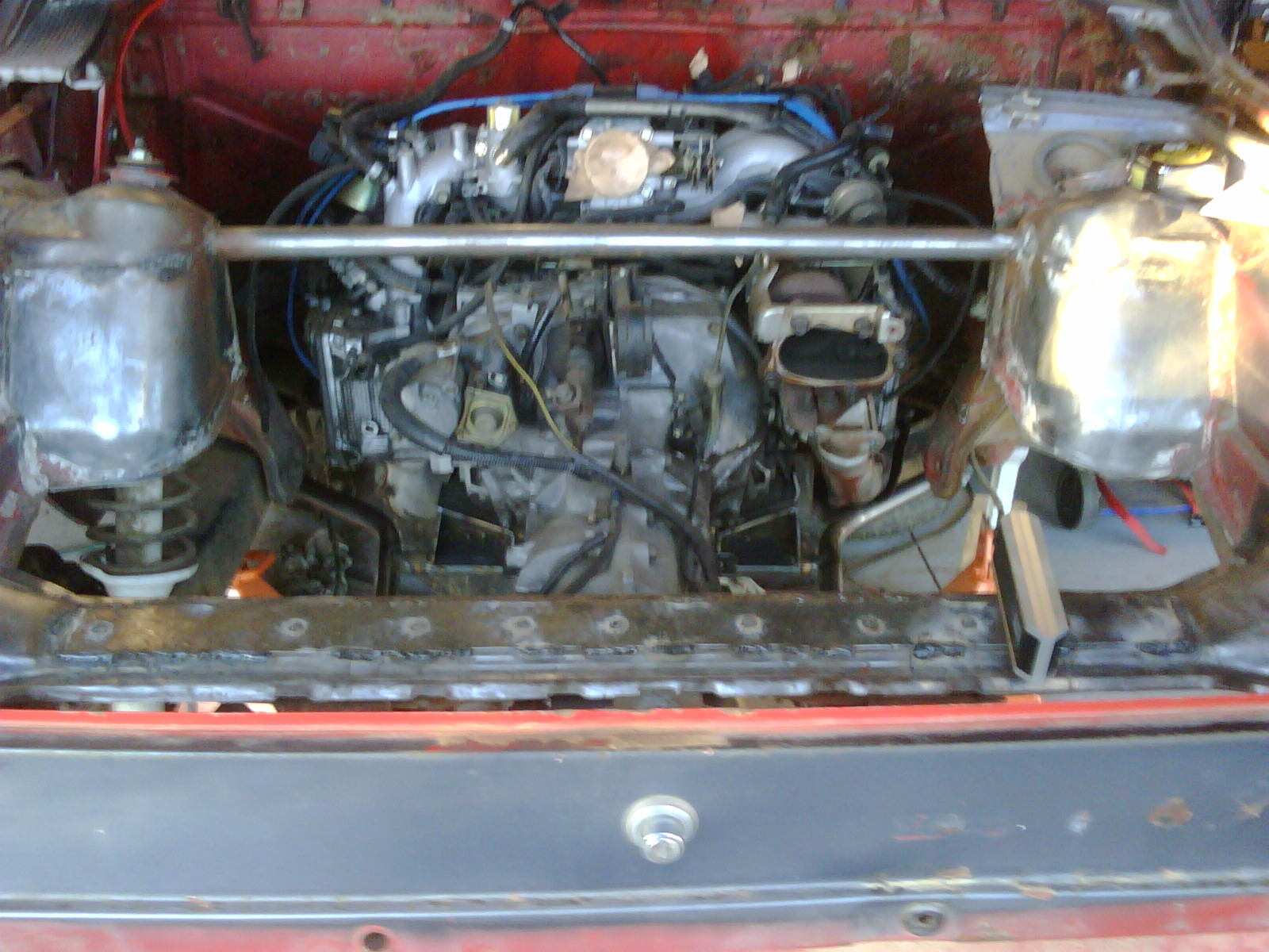

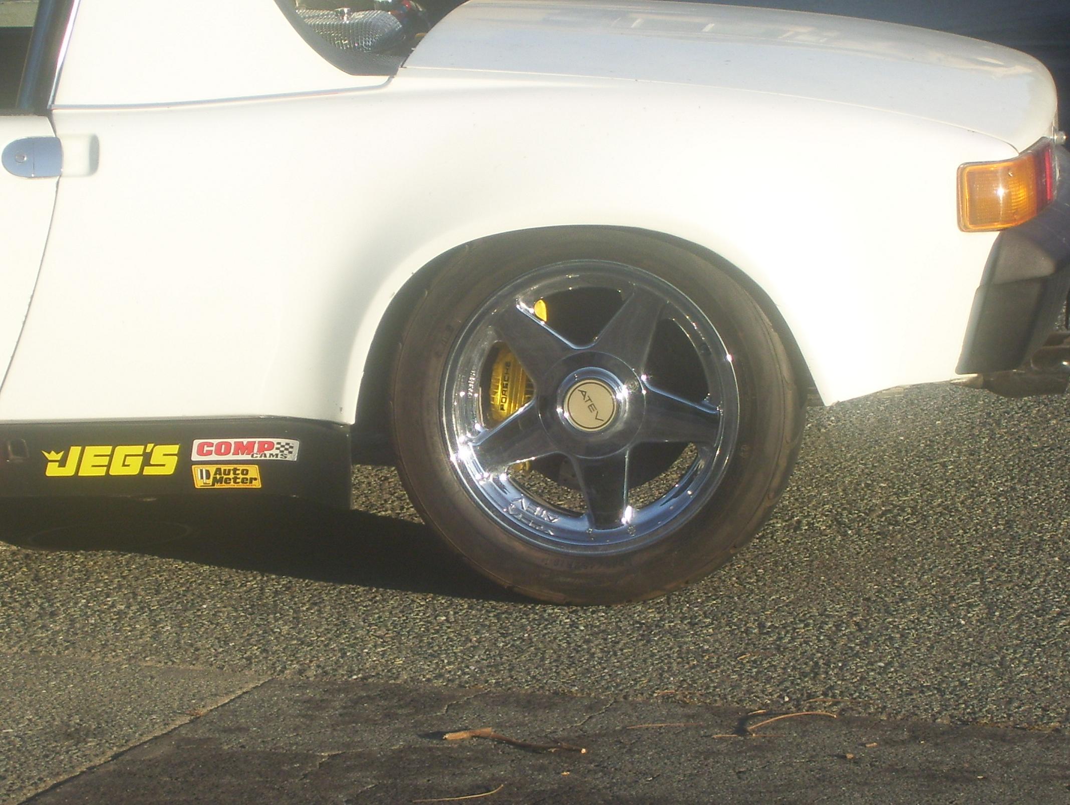

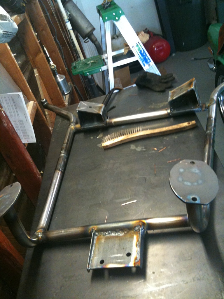

sorry for the crappy cell phone pictures my digital is broken. i'm no fabricator i'm just an airplane mechanic thats learning this as i go along. so no mean coments on the poor quality. its strong it will hold thats all that matters to me.Attached Image
rickthejetman
post Jan 17 2010, 10:14 PM
Posts: 90
Joined: 5-May 09
From: victorville ,ca
Member No.: 10,335
my trunk was totally rotten so it didn't bother me to cut it out. so my engine ended up nice and high and ground clearance is perfect.
