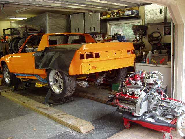

I always get her rear end up in the air and balance the combo on a single floor jack and roll it out the back.
Has worked for me for both the /4 and the /6 engines. (IMG:style_emoticons/default/smash.gif)
I (Well McMark actually) did make a small wood plate to match the bottom of the 3.6L engine to spread the load better.
(IMG:style_emoticons/default/bye1.gif) Andy

I do the same as Andy. i use large 10 x 10s under the rear wheels and get the car way up in the air. I've pulled about 6 engines this way, and have always felt good about it...

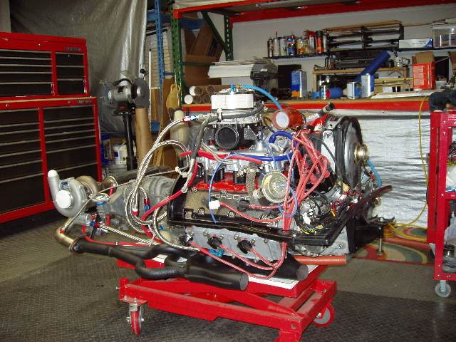

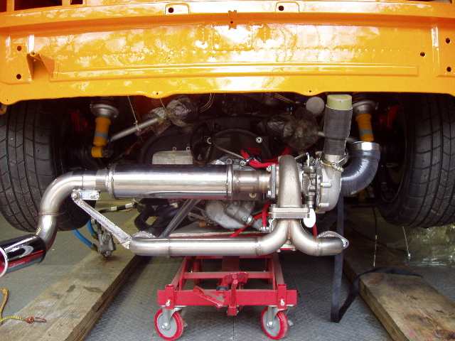

I use a hydraulic lift table, i dont bother with the other ways anymore...

I bought the HF hydraulic lift table, and it worked great because it's really big. Only problem was that I had to take off the jacking handle and make an extension. It points up into the motor and is only about 8" long - designed for foot action, and with no leverage, I couldn't move it up and down.
I haven't tried the motorcycle lift, but thought if the rear of that platform was cut free, and the front reattached with pivot bolts to keep everything level, it'd be a quick lift for the motor and the side of the car. I didn't like the tilt that a motor or car would encounter with the fixed flat lift that it comes with.

I use a lift table also. It has no problem lifting my V8 and trans. Keeps everything stable and easy to lift into place.
Jerry

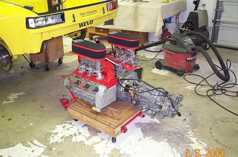

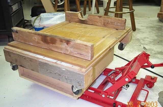

I use the HF ATV life & some home made fixturing. Pull or install a motor/trans
by my self if no help is available.....not a safe as with a buddy, but easy.

They look like this, and you can raise them to work on your engine. EASY! NOTHING simpler.
