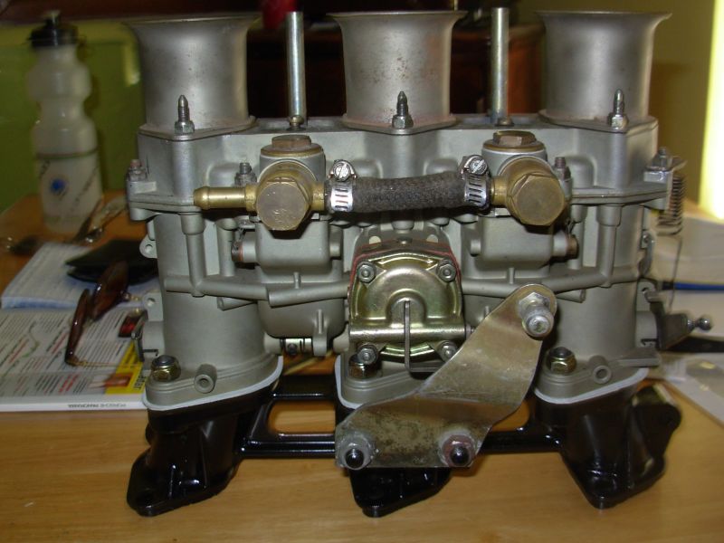

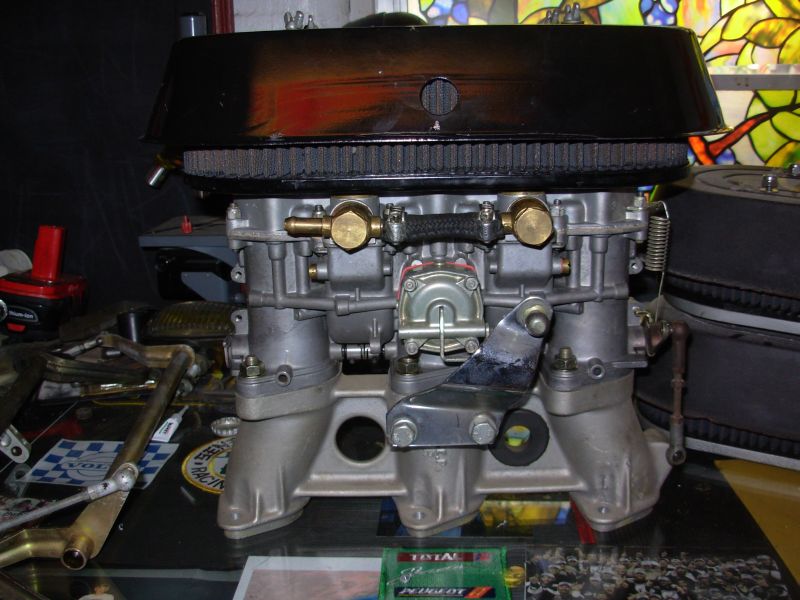

I just sold a set a month ago, I don't have any more. You can also get the tall ones from PMO - They look better
![]() vs ![]() |

Most 2.7Ls have 35mm intake ports. IIRC, the 74 only 'Normal" 2.7L had 32mm intakes.
Whatcha' got? |

Hi JP - It is a 77 911S. I was just told that it needs 40 over 36. Is it 35 or 36? I just want to make sure I am looking/searching on line using the right terminology. Thanks Again! (IMG:style_emoticons/default/beerchug.gif) Scott S My 76 was 35mm which I opened to 36. According to the book, all the USA 2.7Ls were 35 mm intake ports. The exceptions were the "normals"(150 hp) and the RS (NA in the USA) at 36mm. The "short" manifolds (the black ones in TCs pic) can be opened to 35-36. The "tall" (PMO) are 36mm from the get go, IIRC. The PMO insulators are 36 and (IMO)you want these and the manifolds as they block off the notch in the head as cast for the injector. There are also plugs for the air injectors next to the exh port. Pelican & EBS carry these. |

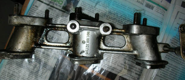

Scott,
My part number is 901.108.321.OR it was from an early S on my 2.5 69S The size is 41mm over 38mm on a low dollar bullet loading plastic gauge. I had early 69 ported S Heads that I sold to Mark and I am going to be running fresh 76 S heads. Bob ![]() |
