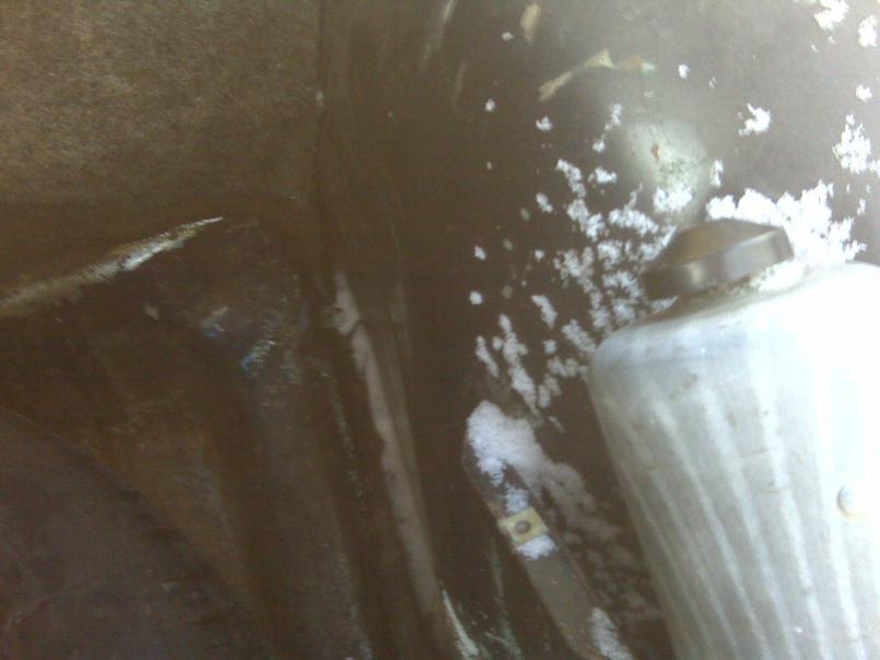

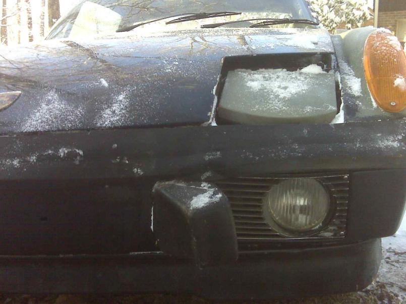

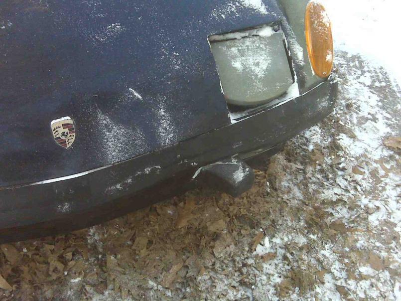

Cell phone pics. I actually hit the pole at an angle so it hit the bumper and then the bumperette caught on the pole swung the back of the car around. It might not look that bad from the pictures but it crumpled the front end a bit.
The inner wheel well is crumpled in a little bit from the impact on that side.
On the replacement list so far: bumper, bumper top pad, bumperette, foglight grill, headlight stuff, hood, front valence. This of course after I get the front end straighten out. I will look into more this afternoon and see if i can't more wrong.

Sorry that happened to you but it looks very fixable, at least you were not injured, you need to be careful when driving in snow.

Very fixable. Most of that you can massage out. Check out my progress thread. It might give you some ideas on how to fix yours. Its your damage x's 10 on the opposite side but similar none the less.

You may need to have a pro do your pull to get the head light bucket or pocket set back the the correct place unless you have experience with that. Do yourself a favor and don't just take after it with a BFH (IMG:style_emoticons/default/smash.gif) until you consult with a good chassis guy. Around here that pull would likely cost 200.00 to 350.00 but you wouldn't have a bunch of stretched and smashed panels with ugly mallet makes in them.

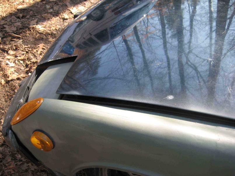

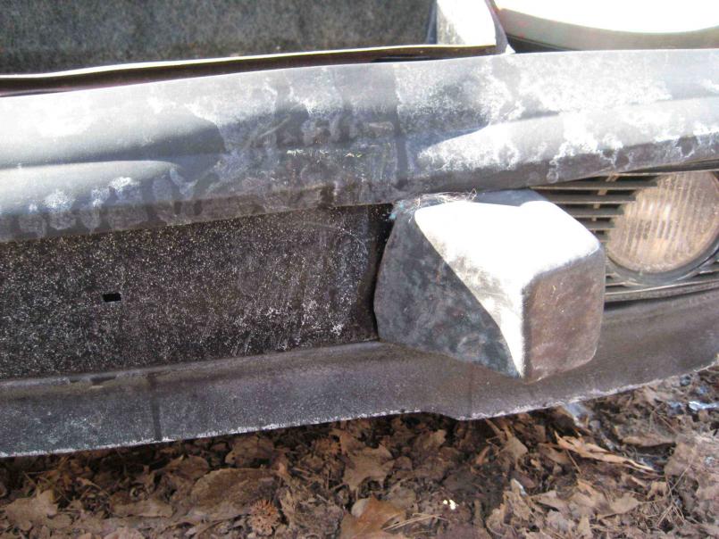

Alright here are some better pictures of the damage.

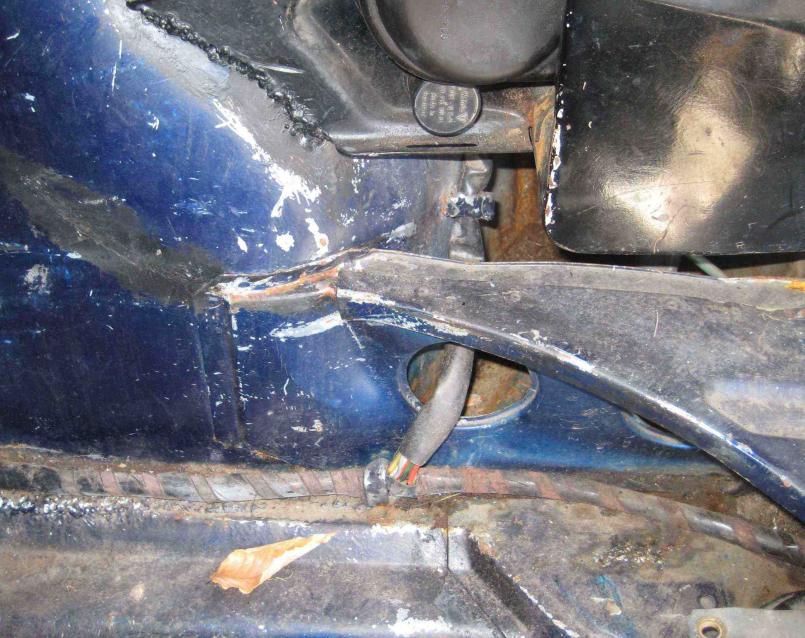

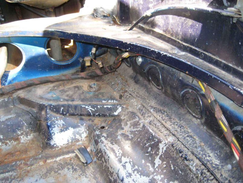

The area under the shelf is pushed in

The hood completely closed.
