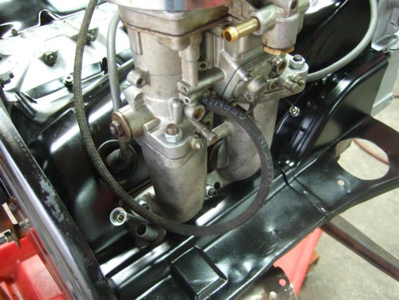

found a pic of the carb, specifially the back that I'm talking about...
it's different than the others I've seen, but maybe ACE can fix them

Van
post Mar 15 2010, 02:18 PM
Posts: 199
Joined: 15-January 08
From: Hyde Park, NY
Member No.: 8,571
Um... have you taken off that nut and looked behind that round washer? You'll find the shaft bearing there.
ME733
post Mar 15 2010, 02:33 PM
Posts: 842
Joined: 25-June 08
From: Atlanta Ga.
Member No.: 9,209
.........YEP.........take off the nutand washer......and there she-be....AND It looks like you have an adjustable acc.pump .....the thing between both bores, has a rod with a spring behind it, attached to the cover in the middle of carb....this means ....YOU DO NOT HAVE the oldest design weber., and yours should be able to repaired easily.....I too understand ACE...does quality work, and has parts.
