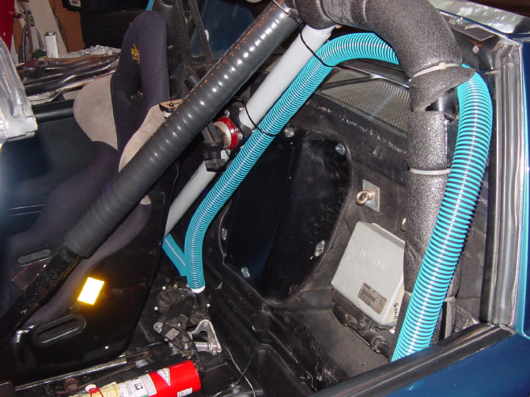

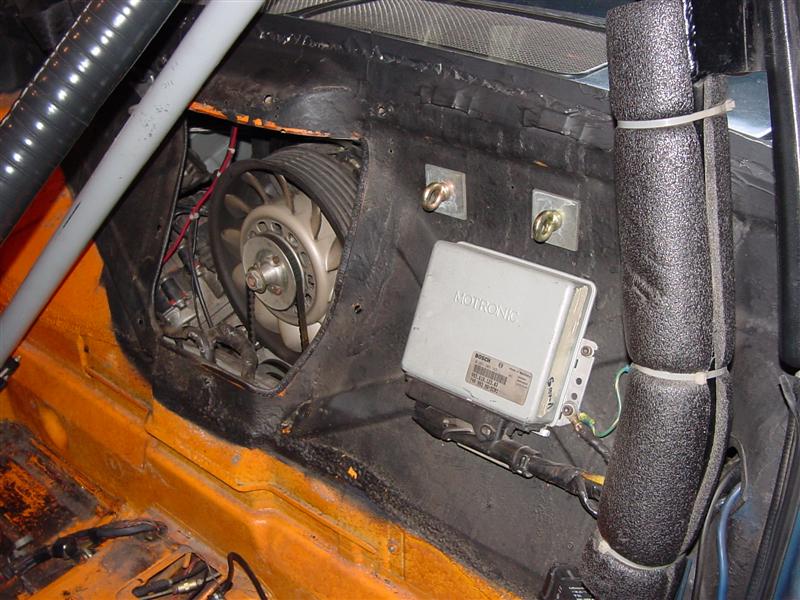

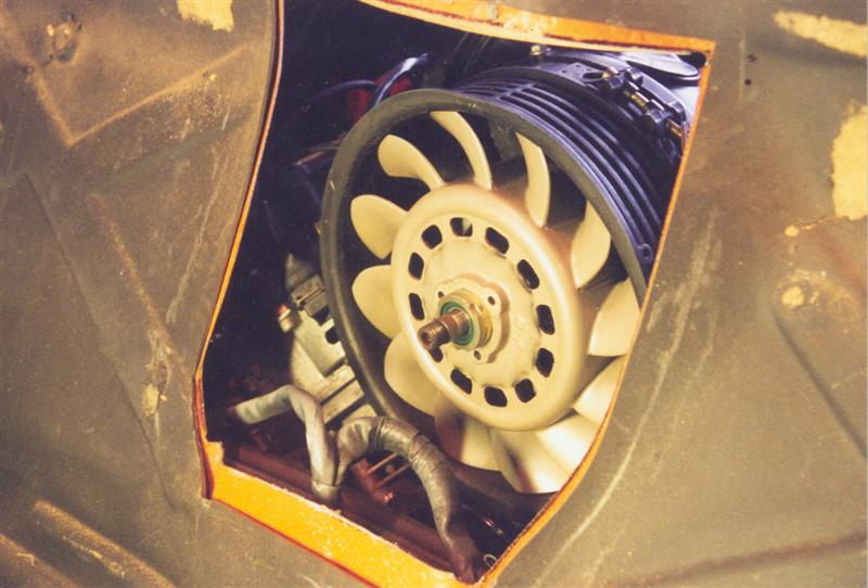

Some pics of Pcar916's cover. I need to make one for my car as I threw a belt at a DE last fall and it is a PITA to change it without one...

My access hole pictured above by JT9146 uses Dzus fittings, not bolts or screws. I like repeatable!
I think I'm using ~ 8 Dzus clips (I'm not where the car is right now). My feeling is if you're cutting a hole then cut a real one that won't trap your hands as you work.
The metal cover slips in and out under the cage crossbar as well. 2-inch, closed cell tape on the panel and sheet metal edge mouldings make for a very tight fit.
