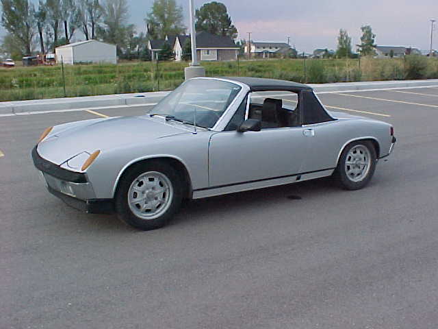

Lets see if this works. Picture below?
aircooledboy
post Apr 6 2004, 10:41 AM
Sweet Pea's 1st ride in daddy's "vroom -vroom"
Posts: 1,672
Joined: 4-February 04
From: Rockford, IL
Member No.: 1,629
Yeah Ba bee! (IMG:style_emoticons/default/mueba.gif)
It was the preview that was screwing things up.
Anyway, that's my girl. This was one of the photos the seller sent me when I first found it. Cosmetically, it looks pretty much the same now. Spent a fair amount of time renewing most of the external engine issues (seals, cables, hoses, lines connectors, etc. ) Runs pretty good now, but I am looking forward to getting the 2.0 in there.
