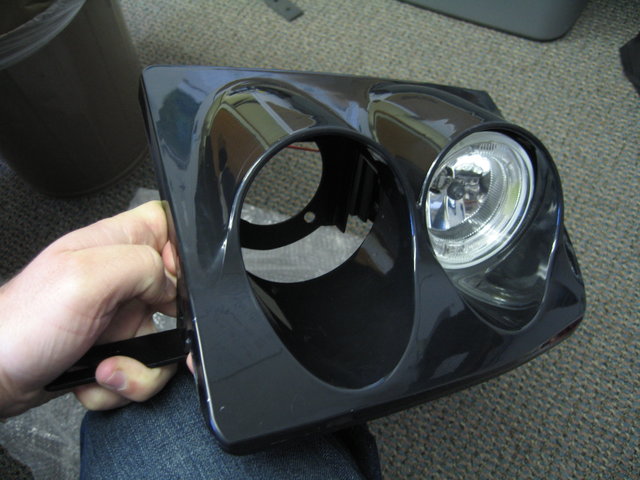

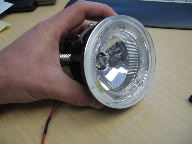

I pulled the trigger and am becoming a copy cat.
Accept I am going to try to retrofit a Bi-Xenon projector into one of the halogen housings. That part may be tough (IMG:style_emoticons/default/rolleyes.gif)
(IMG:http://www.914world.com/bbs2/uploads_offsite/img693.imageshack.us-11125-1280352749.1.jpg)
(IMG:http://www.914world.com/bbs2/uploads_offsite/img525.imageshack.us-11125-1280352749.2.jpg)
Wish me luck.
