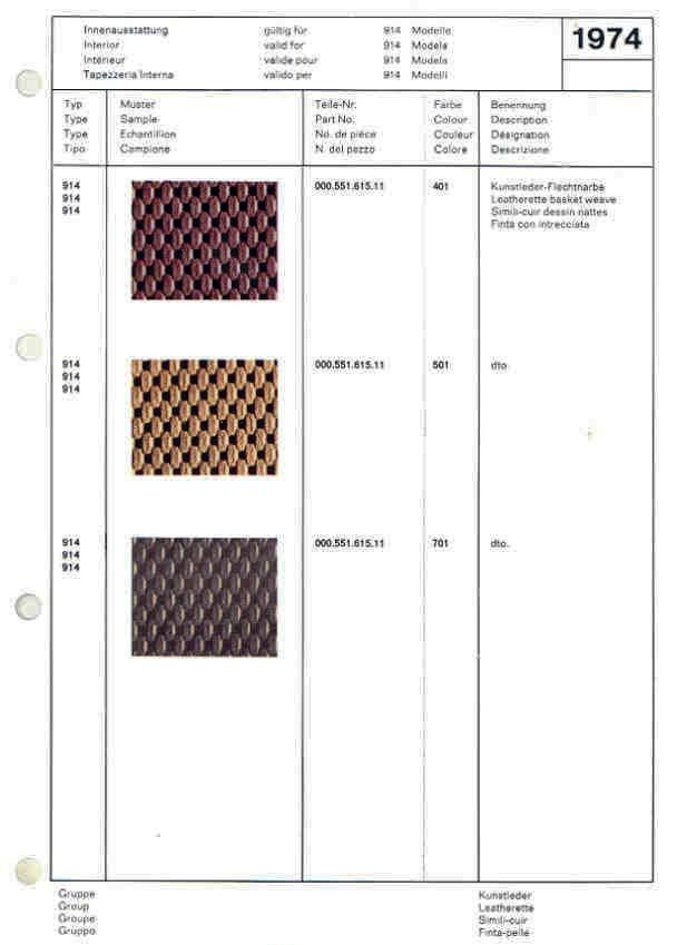

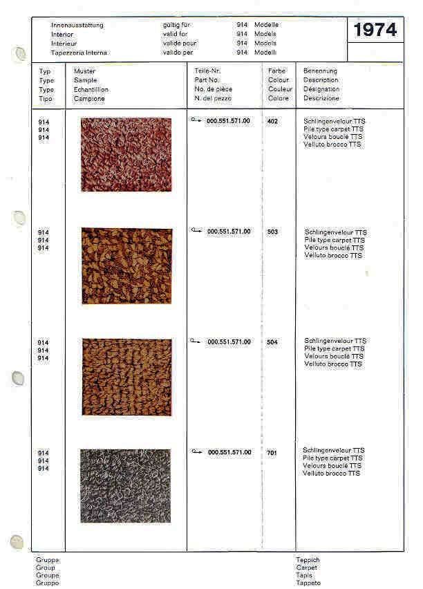

That is the #31 Beige interior under the dye, like I have in my 73 2L - not brown, which is much darker color.
Beige:
Brown:
74 Smooth & Basketweave Leatherette color chart (not great color rendition, but shows the diff.):
I don't know how well that sand the vinyl will work & you cannot get into the basketweave nooks anyway, aside from destroying the surface. If you're trying to do a proper resto on this LE, then get a COA from PCNA & it should tell you the original colors & may say if it was a "real" LE.
So you may be stuck with either an aftermarket repro. reupholstery or finding a proper beige interior & either the tan (504) or dark tan (503) loop pile carpet that went with it, as in the chart below:
The DAPO probably did that because the Beige & tan carpets are almost impossible to find nowadays, & in the process completely pucked-up the nicest interior color IMHO! (IMG:style_emoticons/default/dry.gif)
Appearance & Performance (morph), AA, PP, etc. sell the aftermarket interiors, since the originals are NLA, unless you can find an excellent salvaged one! I decided to use mine & find some smooth vinyl for backpads otherwise unusable to repair the bolster rips in my seats, etc.
Contact Davep & Jeff Bowlsby on here for LE info (do a member search, then PM or email them & start the dialog - they'll be happy to help), cuz they're the gurus on them (IMG:style_emoticons/default/pray.gif) & can help your mission a lot!!! Other good originality resources are Steve Gaglione (smg or sahara steve with the 73 2L brown interior pic above), & George at AA (dr914). (IMG:style_emoticons/default/shades.gif)

Would you like some Beige/Brown carpeting? I have a full set, it desperately needs cleaning, but you can have it for the price of the shipping. There are no worn patches or holes in any of the pieces. It's about 10 different pieces.
My car was a 74 signal Orange with the #31 interior. When I converted it, I reupholstered completely different (gray and burgundy leather) so I went with Charcoal/black carpet.
Send me a PM if you're interested. I may have some of the #31 basket weave material too.

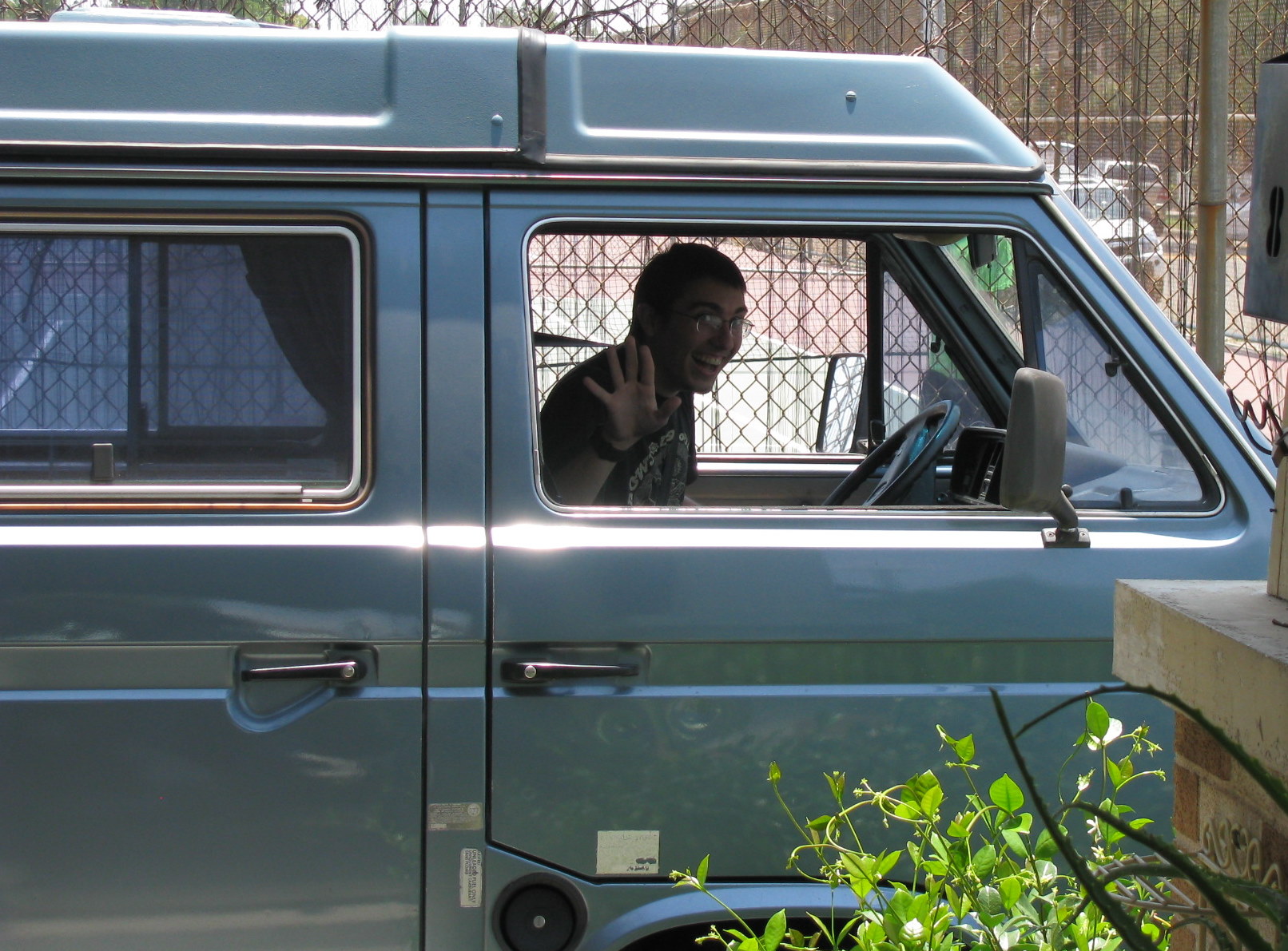

I noticed your 91 Orly Blue Westy in your sig, which I why I mentioned it on those hills - ours is Dove Blue & still pretty much original at now 200,0000+ miles (2 engine overhauls - first replaced entire case due to rod through top in 99, & top end 05). We were loaded with 4 & all our gear for a 3+ week trip from CA to Indy, Cherokee/Qualla, Little Rock, OK then back to CA - so we were veeeery slow up the grade! (IMG:style_emoticons/default/dry.gif)
It was late August on one of our annual trip back when our kids were young, that we had all the torrential rains & flooding in the lowlands (maybe 96 or 98), & we actually hit snow up at altitude before we even got off the freeway to go up to Ashville! (IMG:style_emoticons/default/blink.gif)
OT, but here's a partial pic of our Westy - my wife's DD & general use car too! Paint is original - except we repainted the FG pop-top/luggage rack, & below rear hatch/left jamb & lower right fender panel where we had some "oops" repaired/repainted.
The OE allow wheels/wide tires were also part of the "bribe" to my wife for me to keep spending on my 914's resto - after she saw me hunting for Fuchs 2L Alloys & said: "What about my car?" .... I'm still working on some center caps for them! (IMG:style_emoticons/default/dry.gif)
