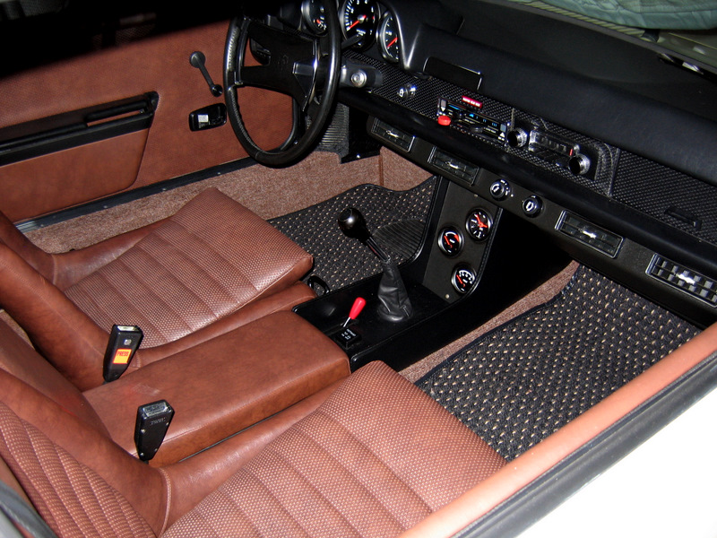

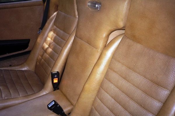

That is the #31 Beige interior under the dye, like I have in my 73 2L - not brown, which is much darker color.
Beige:
Brown:

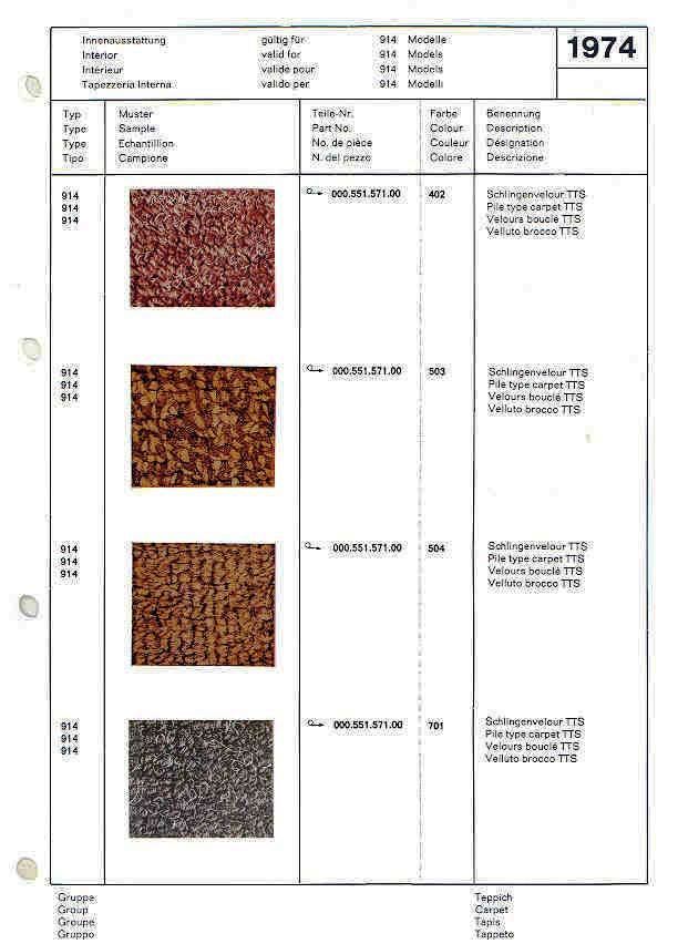

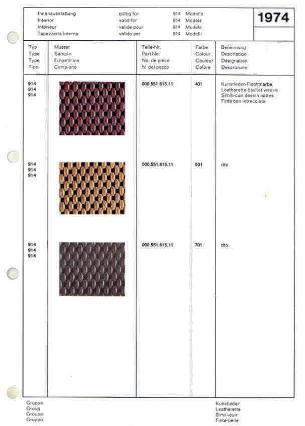

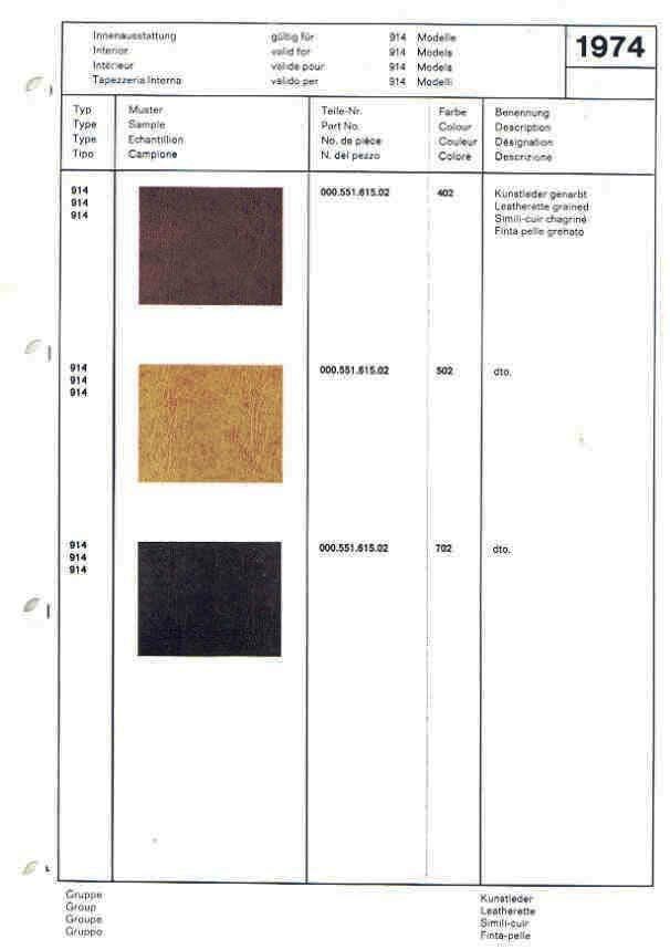

74 Smooth & Basketweave Leatherette color chart (not great color rendition, but shows the diff.):
Click to view attachment Click to view attachment
I don't know how well that sand the vinyl will work & you cannot get into the basketweave nooks anyway, aside from destroying the surface. If you're trying to do a proper resto on this LE, then get a COA from PCNA & it should tell you the original colors & may say if it was a "real" LE.
So you may be stuck with either an aftermarket repro. reupholstery or finding a proper beige interior & either the tan (504) or dark tan (503) loop pile carpet that went with it, as in the chart below:

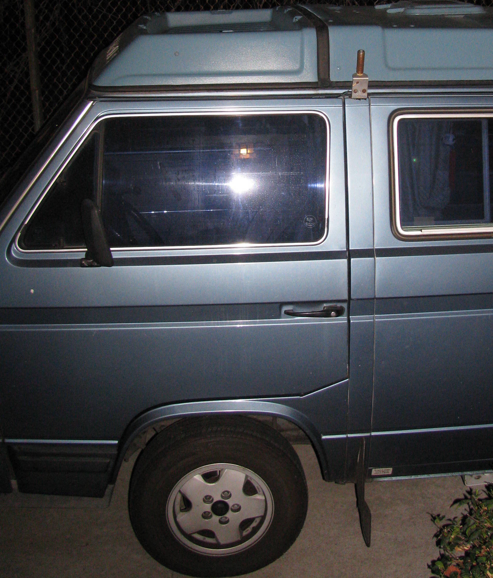

OT, but here's a partial pic of our Westy - my wife's DD & general use car too! Paint is original - except we repainted the FG pop-top/luggage rack, & below rear hatch/left jamb & lower right fender panel where we had some "oops" repaired/repainted.
The OE allow wheels/wide tires were also part of the "bribe" to my wife for me to keep spending on my 914's resto - after she saw me hunting for Fuchs 2L Alloys & said: "What about my car?" .... I'm still working on some center caps for them! dry.gif
