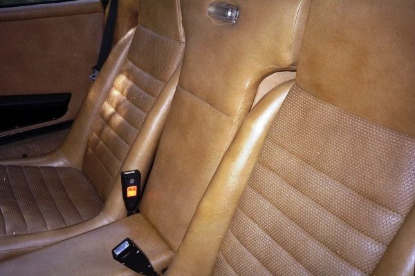

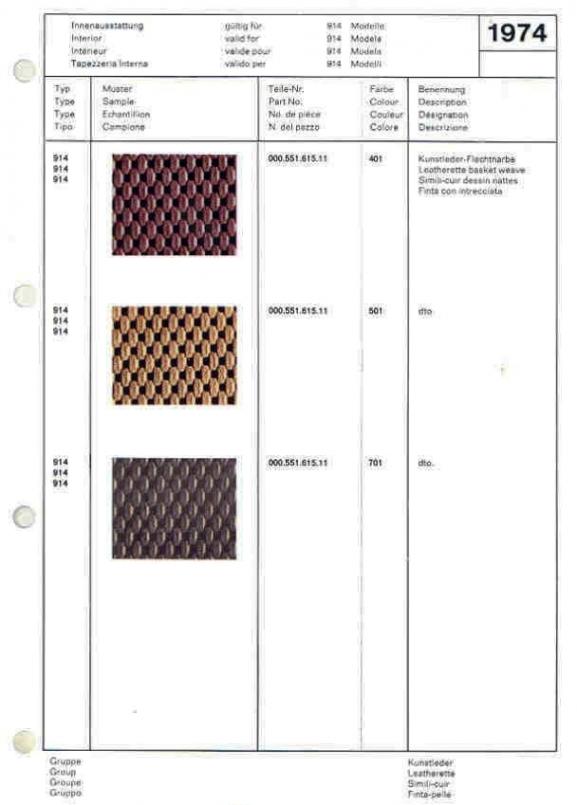

That is the #31 Beige interior under the dye, like I have in my 73 2L - not brown, which is much darker color.
Beige:
Brown:
74 Smooth & Basketweave Leatherette color chart (not great color rendition, but shows the diff.):
I don't know how well that sand the vinyl will work & you cannot get into the basketweave nooks anyway, aside from destroying the surface. If you're trying to do a proper resto on this LE, then get a COA from PCNA & it should tell you the original colors & may say if it was a "real" LE.
So you may be stuck with either an aftermarket repro. reupholstery or finding a proper beige interior & either the tan (504) or dark tan (503) loop pile carpet that went with it, as in the chart below:

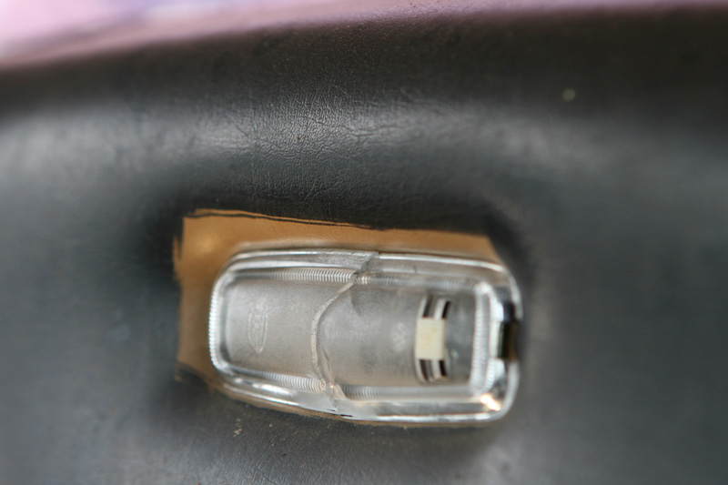

How lazy is a person when they don't even pop out the interior light to finish the job? (IMG:style_emoticons/default/WTF.gif)
(IMG:http://www.914world.com/bbs2/uploads_offsite/www.volksbraggin.com-10419-1274132413.1.jpg)
