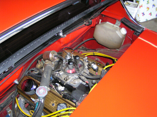

914GEM here is a 327 with a 283 crank brings it down to a 305, Holley projection, all MSD ignition including Dist.
very nice dependable car.
One thing that is fun no shifting, I can make it around the autoX course in second. LOL

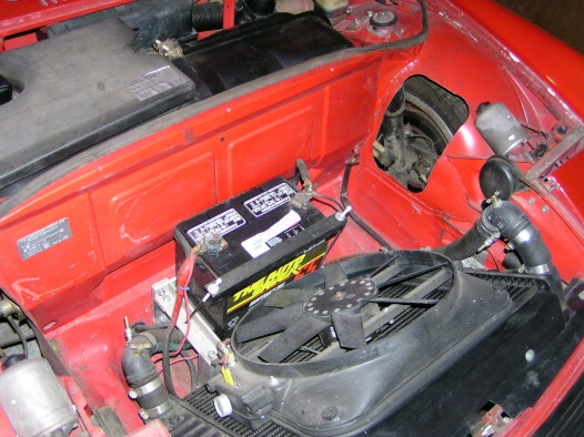

Hi Boxstr, your engine compartment looks nice, where is the battery. My wife and I are planing a trip to the West Coast next year and the camp914 is one of the stop on our trip. Met Brad last year in Hot Springs, he is a great guy full of ideas and knowlage. I would like to visit all the 914 people and shops to bring ideas and 914 tech back to Arkansas so we can use our shade tree for shade.

914GEM thanks the pics are taken before I got the car and It is a little on the dirty side, I have since cleaned it up as time has allowed.
The battery is mounted in the front, radiator is not a RH but it seems to be getting the job done.
When I get around to doing a conversion on the JLO car I will be using the RH radiator system.

I have to make a correction I stated that the motor is a 327 w/283 crank making it a 305, not true it is a 302 like the 67-8 Z-28s. And yes I am having to switch to new Kumhos , because the old Yokos are not getting the job done.
It is setup as an autocross/DE car, and that is what I will keep it as.
