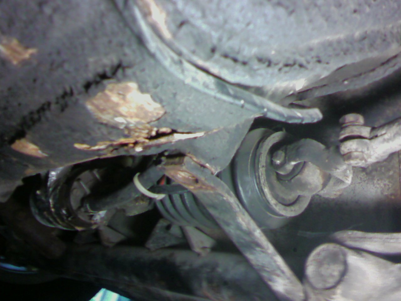

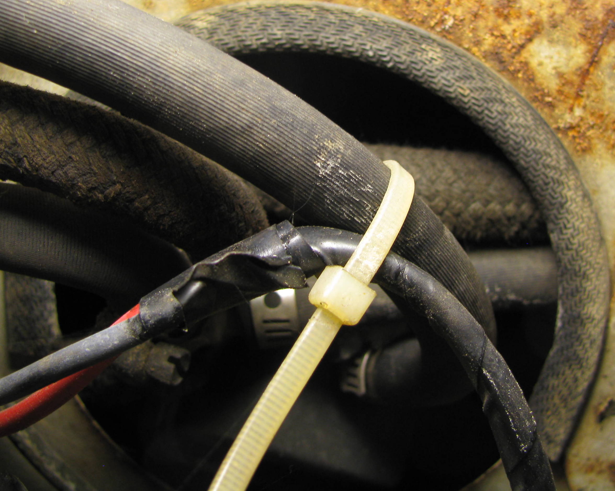

Here's a pic of mine (yup - dirty after DD use 75-85 & in my garage 85-now), & th lines are accessed thru the factory hole for the fuel filter changes in 2nd pic -

Uhhhhhh do you see a problem in this photo? (IMG:style_emoticons/default/blink.gif)

QUOTE(Jeffs9146 @ May 25 2010, 09:51 PM) *
Na, that just holds that steering thingy on. (IMG:style_emoticons/default/welder.gif)
My thought as well. Someone forgot the bolt for the steering rack when they removed the rack cover ...
Hopefully that was just removed to take the picture and then bolted back on correctly.
