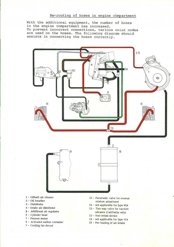

So how does this system work? Review these first two graphics from the factory repair manual to find out.

Then as a test, whats wrong with the charcoal conister installation on these diagrams? The first one is in the factory repair and Service and Training Manuals.
When you are done with this I have more...

QUOTE(Jeff Bowlsby @ Jun 29 2010, 12:28 PM) *
They both show the air from the fan shroud go into the wrong end on the canister ...
The pressure side on the canister is on the side with the two nipples. Fresh air and vapors come in from the same side. The vapor/air mix is then expelled on the drivers side of the canister and routed to the engine air-filter housing ...
What do i win?
(IMG:style_emoticons/default/biggrin.gif) Andy

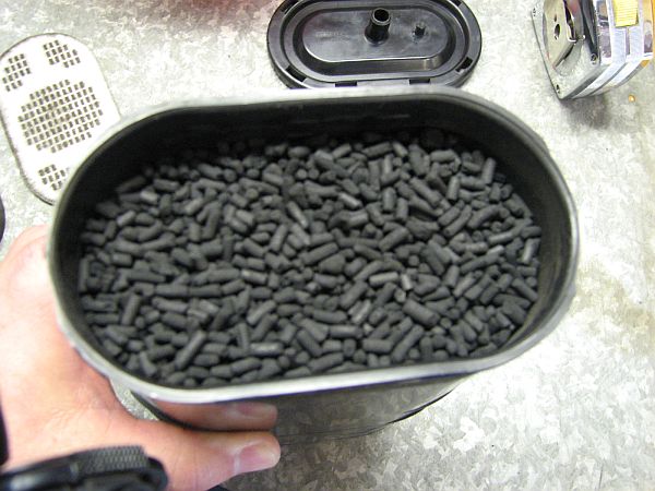

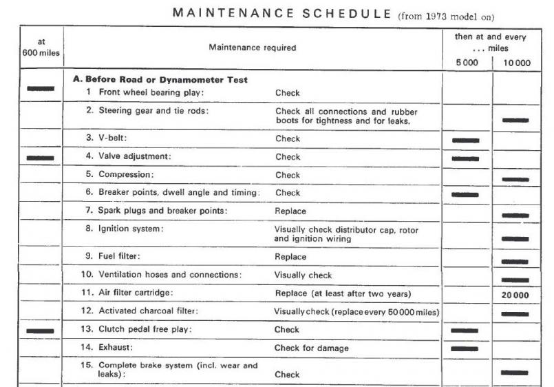

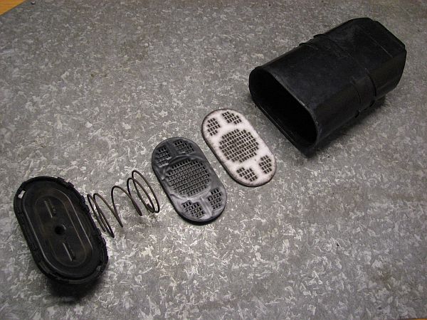

But wait there is more. The later plastic case charcoal canisters can be opened up and the activated charcoal can be replaced (check Google for suppliers). This should be done...every 50K miles according to the repair manual.

You can see the factory manual recomendaiton above indicating replacement at 50K intervals. Thats all I know. I dunno nuthin' 'bout the mineralogical properties of the activated charcoal, bet Google knows.

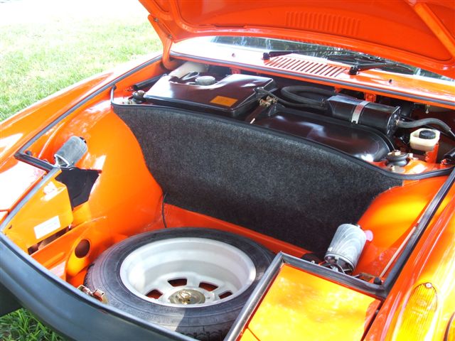

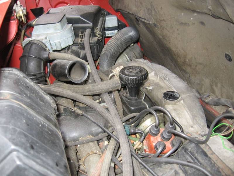

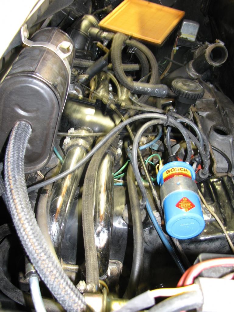

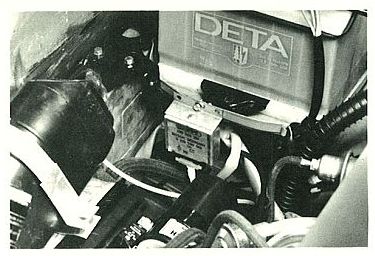

How many different canister styles were their? How many different mounting locations?
A 1970 model

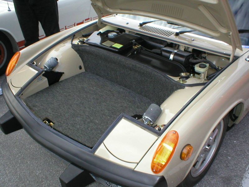

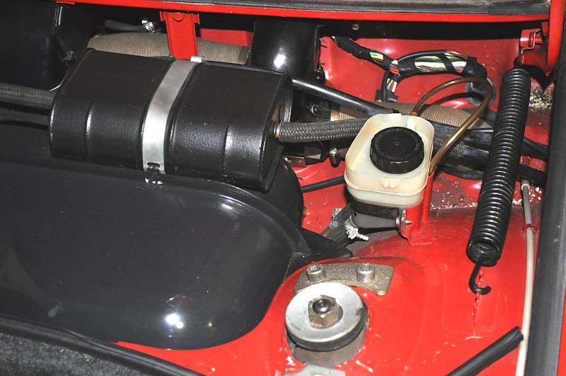

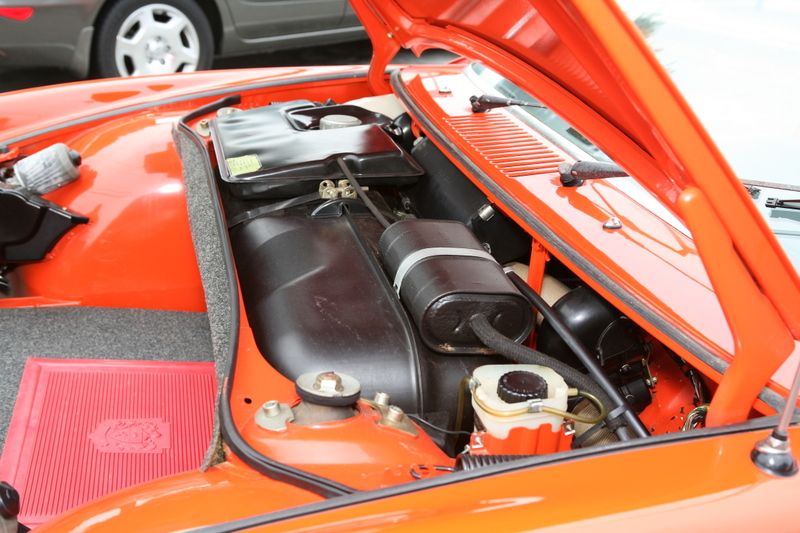

JeffBowlsby
post Jun 30 2010, 10:04 AM
Posts: 9,385
Joined: 7-January 03
From: San Ramon CA
Member No.: 104
VIN 4712908458
JeffBowlsby
post Jun 30 2010, 10:05 AM
Posts: 9,385
From: San Ramon CA
Member No.: 104
VIN 4722907659
JeffBowlsby
Posts: 9,385
From: San Ramon CA
Member No.: 104
VIN 4732903509
JeffBowlsby
post Jun 30 2010, 10:06 AM
Posts: 9,385
From: San Ramon CA
Member No.: 104
VIN 4732914926
JeffBowlsby
Posts: 9,385
From: San Ramon CA
Member No.: 104
VIN 4732926371
JeffBowlsby
post Jun 30 2010, 10:07 AM
Posts: 9,385
From: San Ramon CA
Member No.: 104
VIN 4742905929
JeffBowlsby
Posts: 9,385
From: San Ramon CA
Member No.: 104
VIN 4742915964
JeffBowlsby
post Jun 30 2010, 10:09 AM
Posts: 9,385
From: San Ramon CA
Member No.: 104

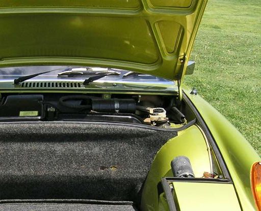

From the 1975 Service and Training Manual
JeffBowlsby
Posts: 9,385
From: San Ramon CA
Member No.: 104
VIN 4752903075
JeffBowlsby
post Jun 30 2010, 10:10 AM
Posts: 9,385
From: San Ramon CA
Member No.: 104
VIN 4762901268

When i removed mine ('70 914-4), i opened it up to have a look inside. It was empty! (IMG:style_emoticons/default/huh.gif)
I guess after 30+ years, all the charcoal inside had turned to dust and was happily burned by my engine ...

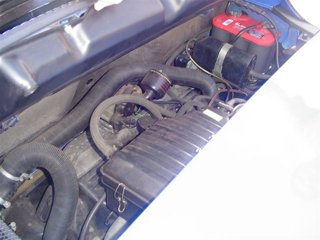

FWIW; this is the only suitable place I could find on my '74 1.8 (VIN 7173). There were no holes in the left side body to bring the lines forward from the shroud/air cleaner, and the car did have the 5mm plastic line in the tunnel. Result? No fuel smell at all in the car or garage.
