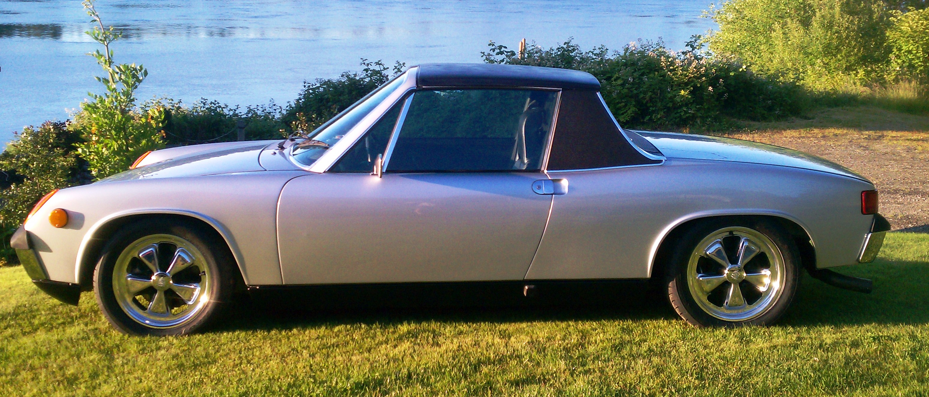

DONE: June 22, 2012 just a few small bugs to quash, as with any 914 car. (IMG:style_emoticons/default/biggrin.gif)
Thanks Everyone for your help and assistance. Parts sold to me. Advice given. Now I get to enjoy the car just in time before the end of the world (IMG:style_emoticons/default/piratenanner.gif)
