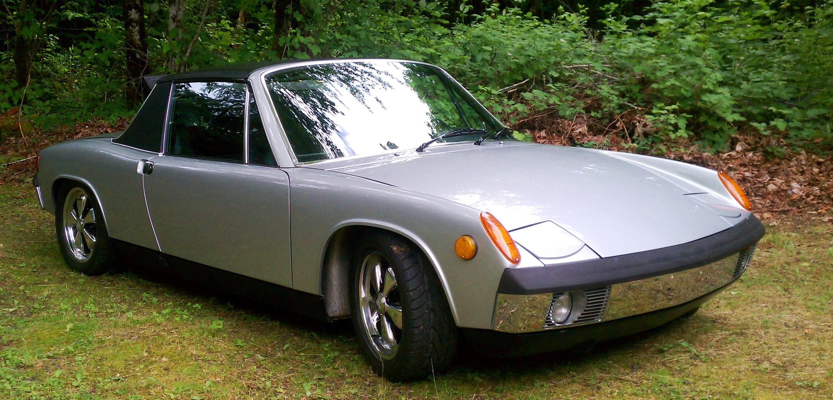

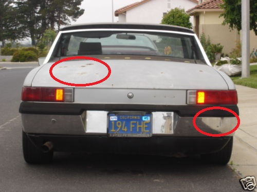

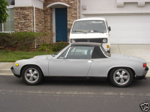

Car as I bought it in San Fran:

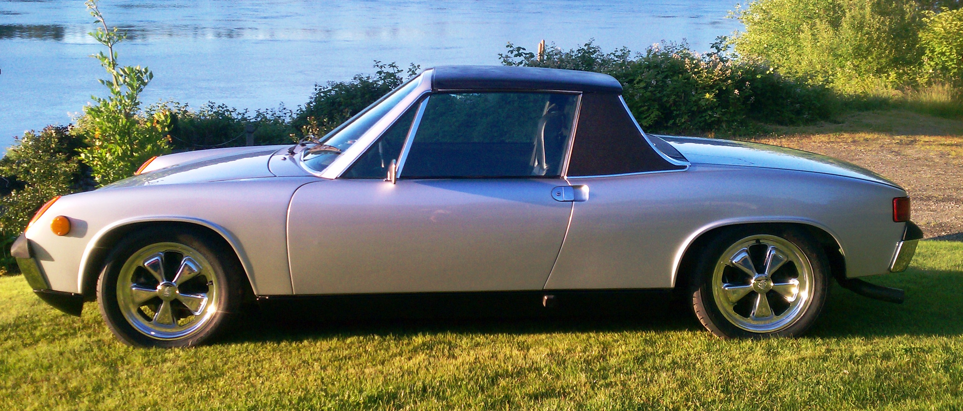

DONE: June 22, 2012 just a few small bugs to quash, as with any 914 car. biggrin.gif
Thanks Everyone for your help and assistance. Parts sold to me. Advice given. Now I get to enjoy the car just in time before the end of the world piratenanner.gif

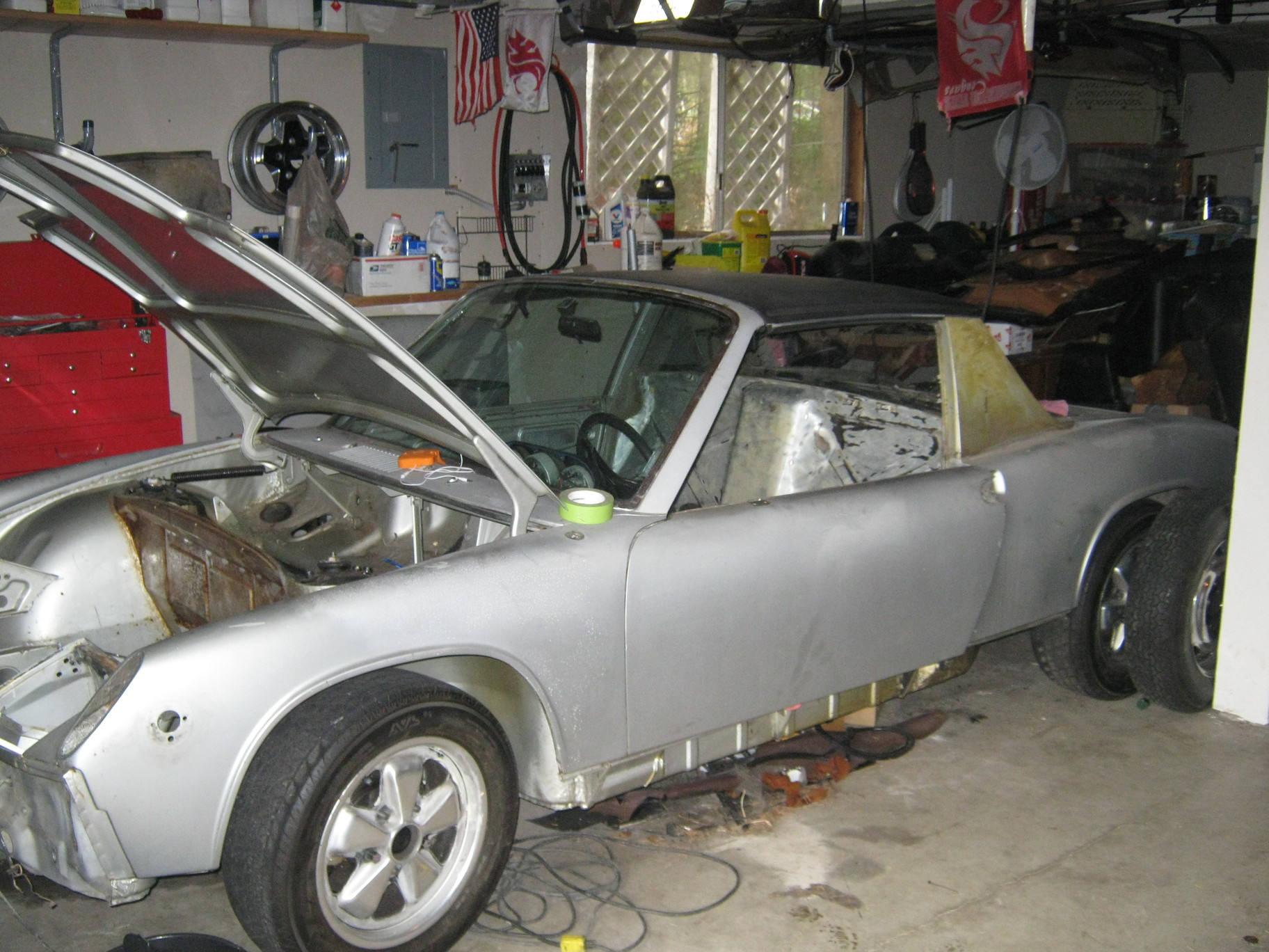

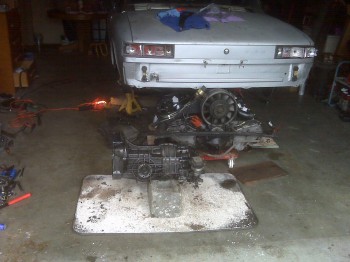

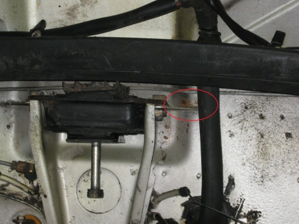

Here's the Car in my garage and the motor/tranny coming out for rebuilds.

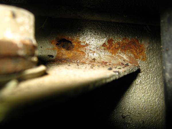

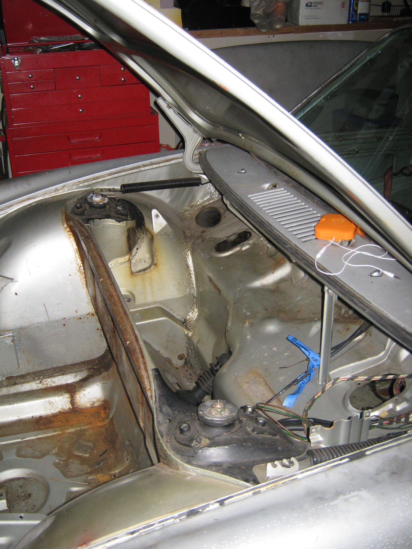

Close up of cancer:

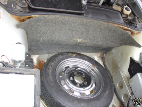

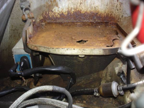

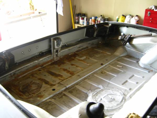

The Battery Tray and Rust issues....not too bad. Very solid Hell Hole. Typical rust from battery acid. I have purchased the tray and support already (Thanks Dan Root)
AND there is rust in the rear trunk. Mostly surface rust, but 2-3 spot where it has gone through.....damn.
The undercoating has also started to peel away from the sheetmetal under the rear trunk. I will neet to strip this area and re-apply.

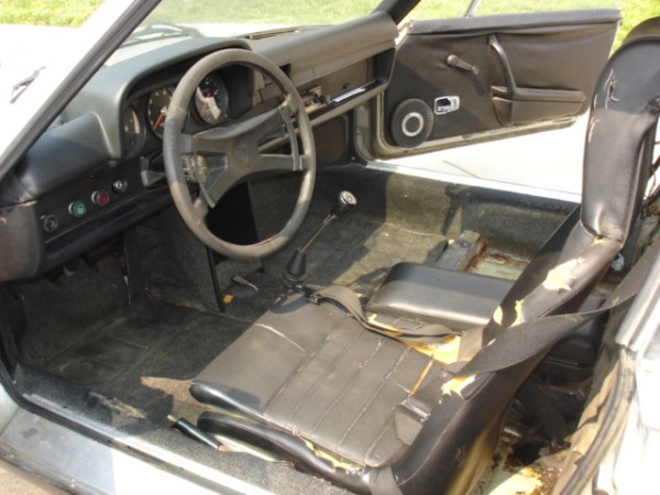

The interior needs help, but it's all there including the back pad (just not in the car on this pic) Also it has a cracked dash, but a plastic cover included for FREE.....I would prefer the felt mat approach to cover the cracks than the plastic thingy...anyone want the plastic cover?
Needed:
Carpet kit
Seat(s) cover kit
Dash replacement
Most interior gaskets/rubber
front vinyl dash cover and pad
door vinyls
one early window crank
driver's door pocket
Please notice the ignition.....a SIX. #3 for the Crandall Trio!

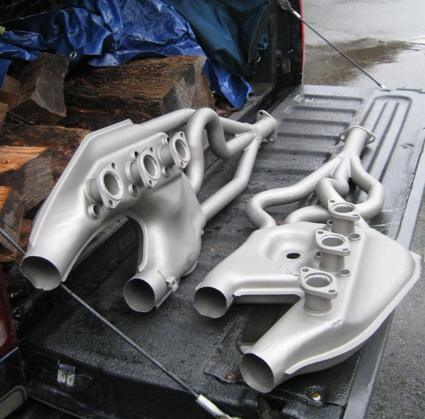

Heat Exchanger DONE!
Performance Coatings in Auburn, WA. Same place PanelBilly is using so figured it had to be okay!
Well worth the $230 to have them protected.

Those HEs look great. Is that a Jet-Hot coating?

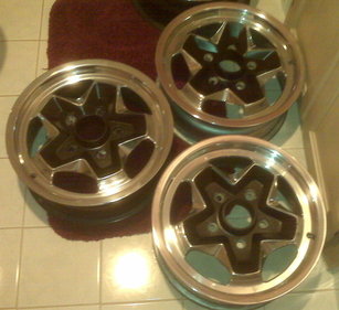

Cookies getting done......CHECK!

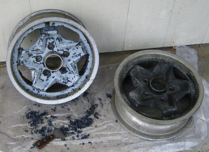

Here's what I started with....
Finished! piratenanner.gif (sorry, low quality cell camera pic) But still makes me very drooley.gif to see these done!
Polished so good it's like a mirror. A guy I found on Craigslist that normally does semi wheels. Charged $30 a wheel to polish....how could I say NO?!

Very nice! I like that look.
Those look incredible. Nice scheme.

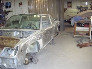

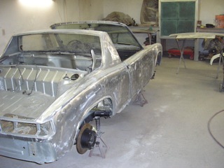

Car Stripped and heading to JMMMOTORSPORTS!

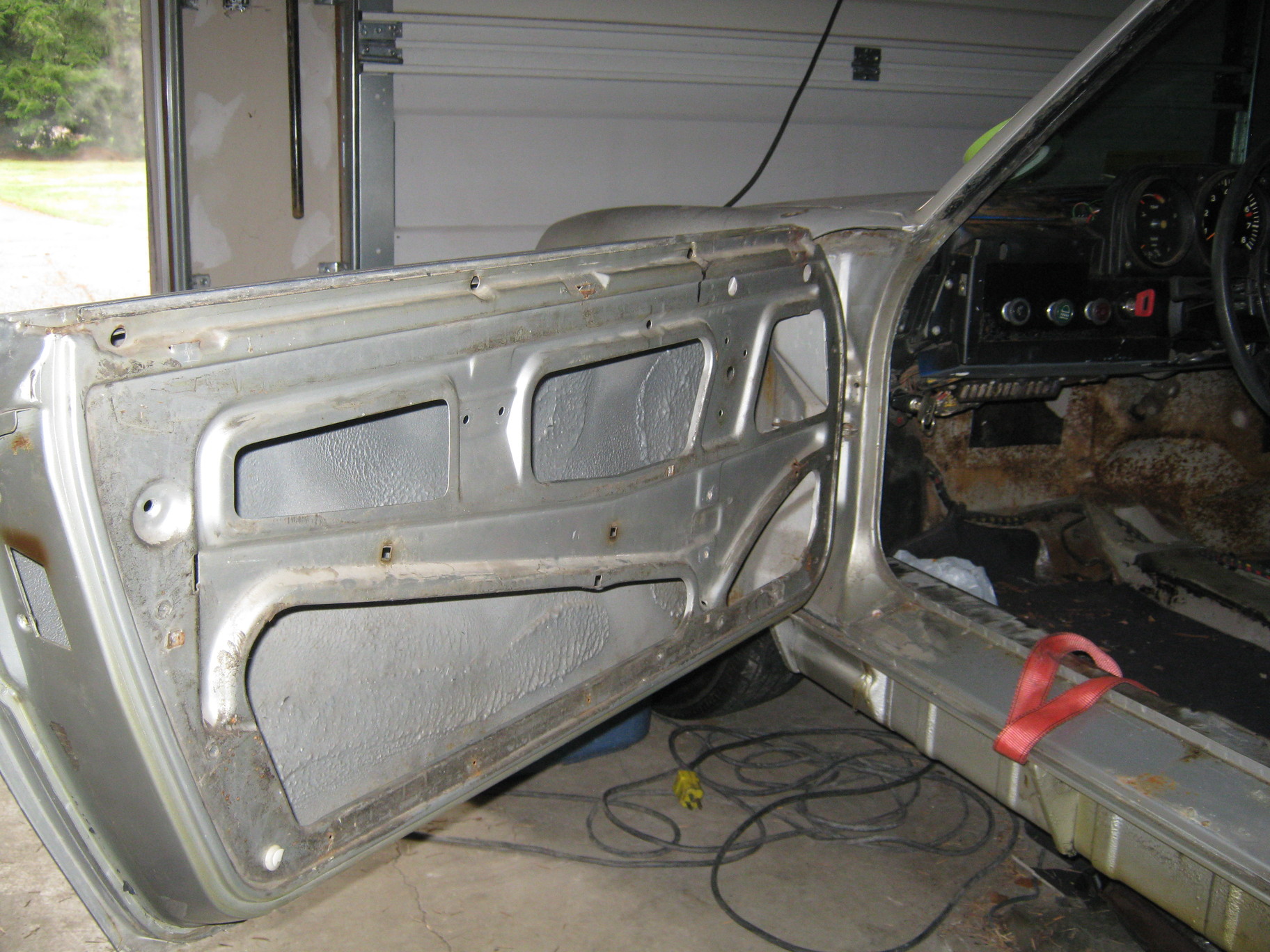

Doors look to be in great shape! Excite to re-assemble with new parts and rubber. Price list to install new stuff: $488.....anyone need a kidney?

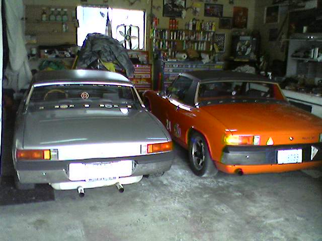

6freak
QUOTE(carr914 @ Dec 2 2011, 06:50 PM) *
QUOTE(Mr.242 @ Dec 2 2011, 12:14 PM) *
let's hope I remember where the pieces go and how to re-assemble the stuff..... GULP!
That is indeed the Hard Part - for me it's nice to have another in the garage to reference to
if he does it at my shop, and i think hes gonna ..he will have mine sitting next to his, should be simple....just time consuming..but fun smile.gif

These just in from Jerry @ JMMOTORSPORTS
piratenanner.gif Give the guy a car for a week and look at him go! drooley.gif
Click to view attachment Click to view attachment
JRust
You took it to the right shop! Jerry knows his stuff. Your car will come out beautifully drooley.gif
