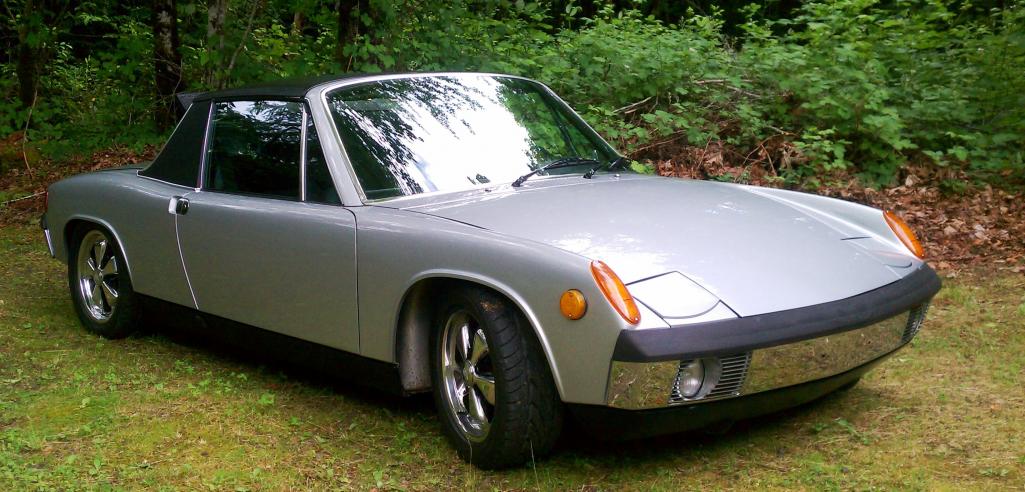

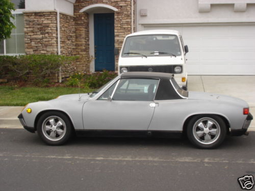

So to risk it all and to have a goal. I shook hands with my girlfriend(married 9.26.11) wife's parents, as well as a co-worker to have my car done by June 2012. I have to enter my car in a car show and be completed.
The recent PNW BBQ, the rumors were floating around if I REALLY had a 914. I've owned it for 2 years and the project was purchased as a running vehicle needing help.
I test drove the car and it ran and shifted fine. Only drove it about 2 miles max due to the left front caliper sticking and pulling horribly to the left when I hit the brakes. Yea, toward the centerline. So enough of that non-sense!
Sent the brakes off to Eric Shea for a rebuild. I got them and started the bleeding process and found the resivoir leaked. It ran down below the fuel tank. STOP, gotta fix that. But need to clean up that brake oil from under the tank.
Remove the tank and since it's out. Yea, better clean it and line it. DONE!
Along comes the Portland Tranny Clinic with Dr. Evil. So, I should pull the tranny. But since the tranny is coming out, I should just pull the whole motor and tranny. DONE!
Since those are all out. I should replace the tunnel fuel lines. In process.....
Since motor is out, I should have the engine bay repaired (battery tray and support) and painted. I started cleaning this up and found car cancer. It was a very sad day....I have been kicking around what to do since and gathering funds at the same time.
Here are some pictures of where I am at. I will start this build thread and I have 2 years or less to complete this build.
I can't lose and I don't like to lose. If I lose, then surely the gal's parents will think I'm a loser. Granted the bet is for liquor, so get them drunk on their victory and they might forget.................
pics:

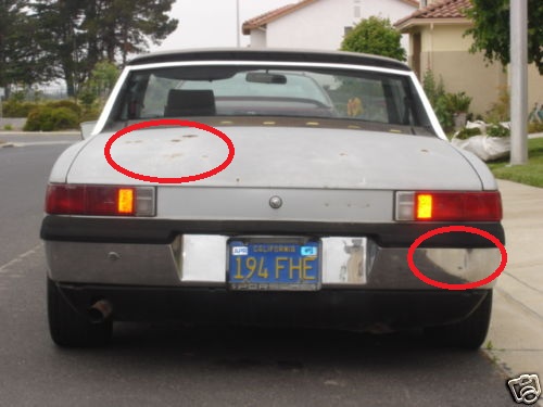

Car as I bought it in San Fran:

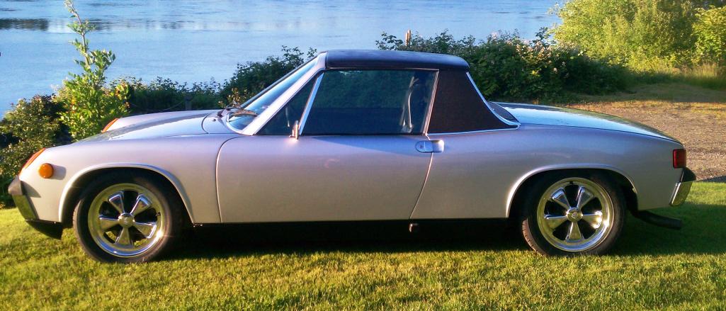

DONE: June 22, 2012 just a few small bugs to quash, as with any 914 car. (IMG:style_emoticons/default/biggrin.gif)
Thanks Everyone for your help and assistance. Parts sold to me. Advice given. Now I get to enjoy the car just in time before the end of the world (IMG:style_emoticons/default/piratenanner.gif)

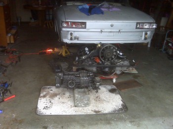

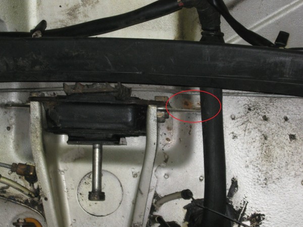

Here's the Car in my garage and the motor/tranny coming out for rebuilds.

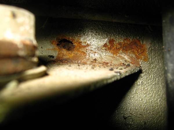

The car cancer at the motor mount (IMG:style_emoticons/default/sawzall-smiley.gif) (IMG:style_emoticons/default/hissyfit.gif)
Close up of cancer:

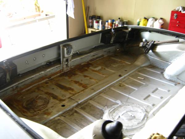

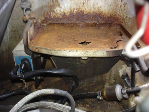

The Battery Tray and Rust issues....not too bad. Very solid Hell Hole. Typical rust from battery acid. I have purchased the tray and support already (Thanks Dan Root)
AND there is rust in the rear trunk. Mostly surface rust, but 2-3 spot where it has gone through.....damn.
The undercoating has also started to peel away from the sheetmetal under the rear trunk. I will neet to strip this area and re-apply.

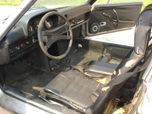

The interior needs help, but it's all there including the back pad (just not in the car on this pic) Also it has a cracked dash, but a plastic cover included for FREE.....I would prefer the felt mat approach to cover the cracks than the plastic thingy...anyone want the plastic cover?
Needed:
Carpet kit
Seat(s) cover kit
Dash replacement
Most interior gaskets/rubber
front vinyl dash cover and pad
door vinyls
one early window crank
driver's door pocket
Please notice the ignition.....a SIX. #3 for the Crandall Trio!

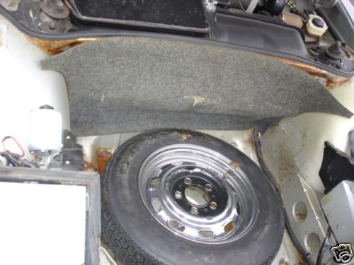

The Front Trunk area....needs some cleaning, attention, and fresh paint.
Rear has some rust on trunk, due to being closed on something and creating a bump. Paint wore off and since this car sat under a blue tarp (IMG:style_emoticons/default/chair.gif) it kept the moisture and rusted. There is also a dent on the right rear of the bumper. I have pushed most of this out; however, the bumper is not perfect and needs rechromed. Lucky me, my gal won a $75 dollar gift certificate at a car show for re-chroming! She wants to chrome my bumper with it......there's a joke in this I know!

This looks like it might be a very neat thread. A couple of things;
1. The rust you show doesn't look that bad, but I bet it isn't the end of it. (then again, this is a west coast car and all I know is the east coast cars)
2. The interior is rough, but luckily, it can easily be repaired/replaced
