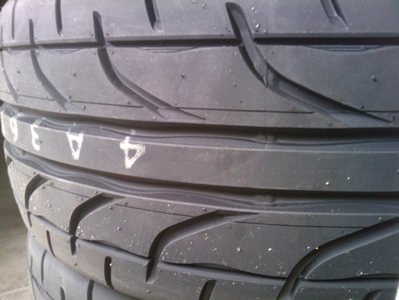

carr914
post Aug 25 2010, 06:21 PM
Racer from Birth
Posts: 131,990
Joined: 2-February 04
From: Tampa,FL
Member No.: 1,623
The Tire Rack Rocks (IMG:style_emoticons/default/aktion035.gif)
I ordered these yesterday morning, did Not do any rush delivery, just UPS ground.
Just got back from my local Pub and they were on my doorstep. (IMG:style_emoticons/default/biggrin.gif)
T.C.

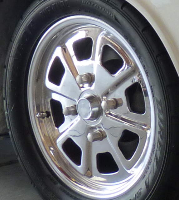

post Aug 25 2010, 09:36 PM
Going back to the Dark Side!
Posts: 4,300
Joined: 4-October 04
From: Auburn, CA
Member No.: 2,880
for very good street, very grippy AX/DE the Dunlop Direzza Star Specs are tough to beat....
this is the next generation Direzza....205x50x15

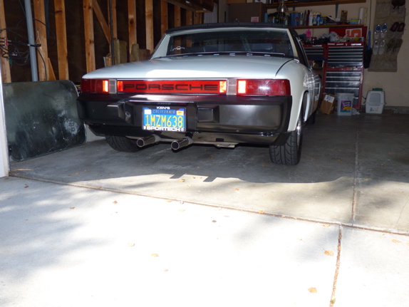

harlenl
post Aug 27 2010, 07:28 PM
Posts: 91
Joined: 6-February 04
From: Santa Cruz, CA
Member No.: 1,640
QUOTE(Zaney @ Aug 25 2010, 09:19 AM) *
What is a good make and size for a narrow body teener for 16 x 7 inch wheels? Good grip but also all sun & rain driving too. (It is the PNW btw (IMG:style_emoticons/default/driving.gif) )
I run 205/50-16 Dunlop Direzza Sport Z1 Star Spec, but only use the car during the summer. In the winter it sits in the garage so I don't know how it will perform in the rain, but looking at the tread pattern it looks as though it should perform fine. The TireRack.com has reviews of the tire from people who have run it in the rain.
http://tinyurl.com/2cjq4zl
Harlen
