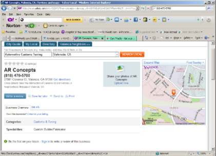

A search comes back as this. Maybe someone local can check it out.
