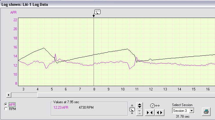

Ok, I'm going to make my comments quick because I'm going to go drive my 914 (seriously). I am running atermarket programable engine management (fuel/ignition). I got a cool little LCD with a built-in 0-1v analog volt-meter that I mounted in the dash (It's only about 1.5"x.75"). I hooked this up the the highest quality narrow-band Bosch lambda sensor I could get. The sensor was rummored to hit .8-1 volt at a mixture of close to 12.0:1. In theory I should have been able to tune the EFI for 13.5:1 at part-load by getting the needle on the guage about 3/4 of the way across. Tuning WOT so the needle was just tickling the far edge should have gotten me a nice 12.5-12.0:1 mixture.
Well, I tuned the EFI accordingly and the car never seemed to run like I felt it should. So I bit the bullet. This week I got my LM-1 wideband O2 kit in the mail. The expense was a hard pill to swallow - it cost almost as much as the PEFI conversion ($400) but it payed for it's self the moment I plugged it in and turned it on. At part load I was running between 14-15:1 (way too lean) and at WOT I was running between 9-10:1 (way too rich).
I've run the two sensors together (narrow and wide), and the narrow really is useless. It is unresponsive compared to the wideband, and inconsistent depending on temp. The wideband is instantanious and the readings are repeatable. It seems to be quite resistant to temp-influenced reading errors.
I'm so dissapointed with the narrow-band sensor and dash display that I probably disconnect it.
-Ben M.
ps - after only 1/2 hour of driving around with the laptop and the LM-1 the car was litterally transformed. No LM-1 buyers remorse here.

post Apr 17 2004, 01:22 AM
I have bees in my epiglotis
Posts: 2,196
Joined: 7-February 03
From: Kennewick Man (E. WA State)
Member No.: 266
Here's another shot with the Y-axis set to AFR instead of RPM. (X-axis is time in seconds. Stop laughing. I was climbing a grade. It's easier to tune going up a hill because things happen more slowly)
-Ben M.

airsix
post Apr 17 2004, 05:37 PM
Posts: 2,196
Member No.: 266
QUOTE(Dave_Darling @ Apr 17 2004, 07:18 AM)
Heating the NBO2 won't get the temperature stable enough to make the readings useable. You will have to bite the bullet and pick up one of the setups pictured earlier.
the Daves are right. This was my experience. The NBO2 I talked about above was a heated one. Reputed by others (auto-groups like this) to be the best NBO2. Bosch, sorry - don't have the Bosch #, but it's a Napa part # OS204 for 86 Ford Escort.
Anyway, my finding is that the NBO2 are too influenced by temp, and too slow to react for useful tuning. In 20 minutes with the wideband I was able to do more for my car than I did in a YEAR with the NBO2.
-Ben M.
ps - This morning I made some tweaks based on the data I logged last night. WOT mixture now stays between 12.2-12.5:1 and the car is running great (autocrossed today). I'm going to fire off an email to the guys at Inovate Motorsports to thank them for making a reasonably priced WBO2 that works so well.
