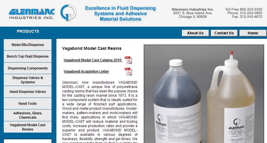

There is a thread on RoadGlue on this. I have seen the material and is an perfect match. It flows pretty freely. Be sure to plug the relay sockets.

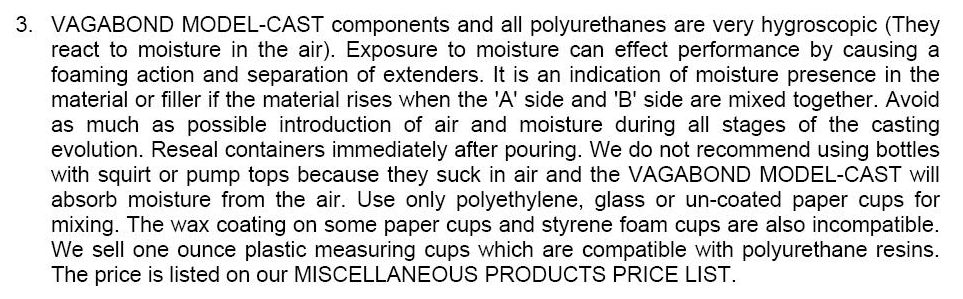

Model Cast is a polyurethane...aren't polyurethanes hygroscopic (they absorb moisture?) I would think thats the wrong material to use for this purpose, regardless of how it looks.
I didn't see that it is polyurethane. Where did you get that? It is a 2 component casting material. The finished product looks exactly like the original. I am sure it is different but looking at it it looks real nice. Glenn has used it a number of times without problems.

QUOTE(Bartlett 914 @ Sep 28 2010, 08:39 AM) *
I just did a quick google search and found these:
http://www.glenmarc.com/VAGABOND%20MODEL-CAST_CAT_2010.pdf
Any corrosion effects of moisture absorption to the circuitry/conenctions over time would be concealed under the coating. Same problem as the original bituminous coating.

What the Vagabond tech sheet is refering to is each component's sensitivity to moisture before they're mixed together. This is common with two-component polyurethane casting materials. Optimally you'd evacuate the mixture before casting to remove entrapped air and moisture.
Andys
That is how I read it. Once it is cured, it is pretty hard. The worst thing to use would be RTV. This out gasses corrosive gas. It also absorbs moisture.
