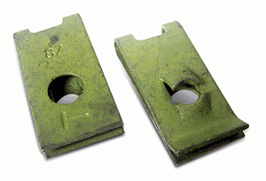

![]() http://www.aircraftspruce.com/catalog/hapages/tinnerman.php Another trick is to drill a hole about four sizes smaller than the tap you want to use, and then use a tapered punch to get the hole close to the correct drill size (to bugle the hole) and then tap it for the size screw you want to use. This takes more time, and works best if you have someone back up the hole with a improvised mandrel. |
