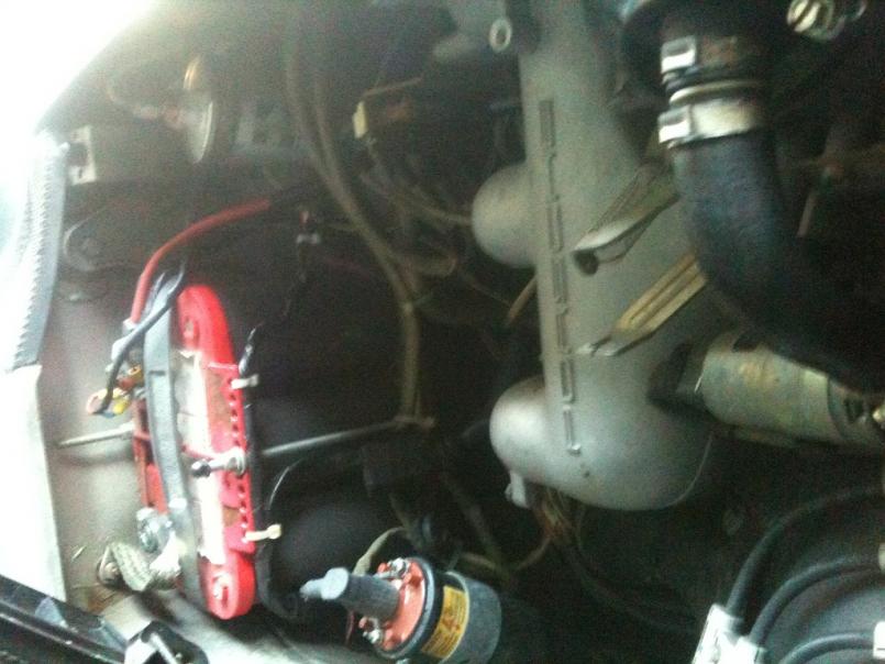

Here's some picks, but not much to see. The filter used to be strapped to the engine lid support brace but Otto's added a brace and strapped it to it.

Here's a bigger picture of the battery area with the filter.
Steve

Looks Good Steve, thanks for the shots (IMG:style_emoticons/default/driving.gif)
