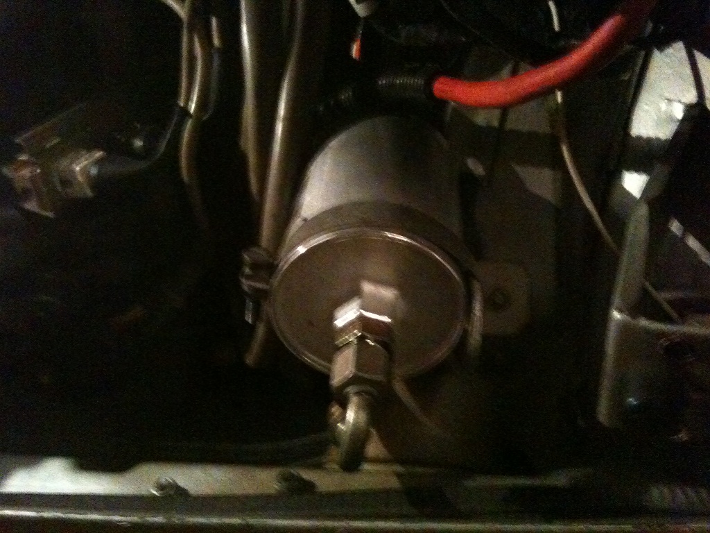

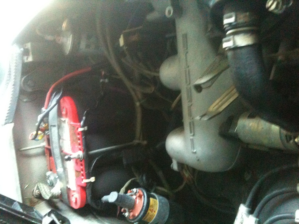

Oct 27 2010, 07:00 PM
Here's some picks, but not much to see. The filter used to be strapped to the engine lid support brace but Otto's added a brace and strapped it to it.

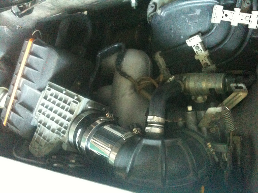

Oct 27 2010, 07:01 PM
Here's another picture on how I modified the the aircleaner with a Pep boys ricer kit.

Here's a bigger picture of the battery area with the filter.

Looks Good Steve, thanks for the shots
