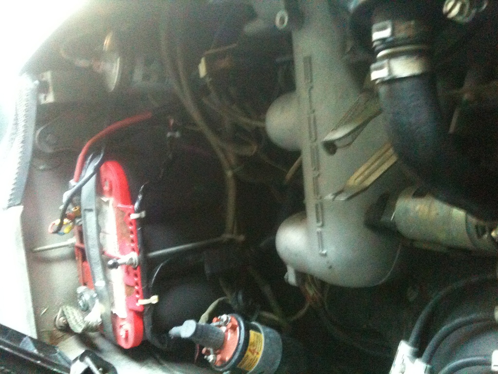

Here's some picks, but not much to see. The filter used to be strapped to the engine lid support brace but Otto's added a brace and strapped it to it.

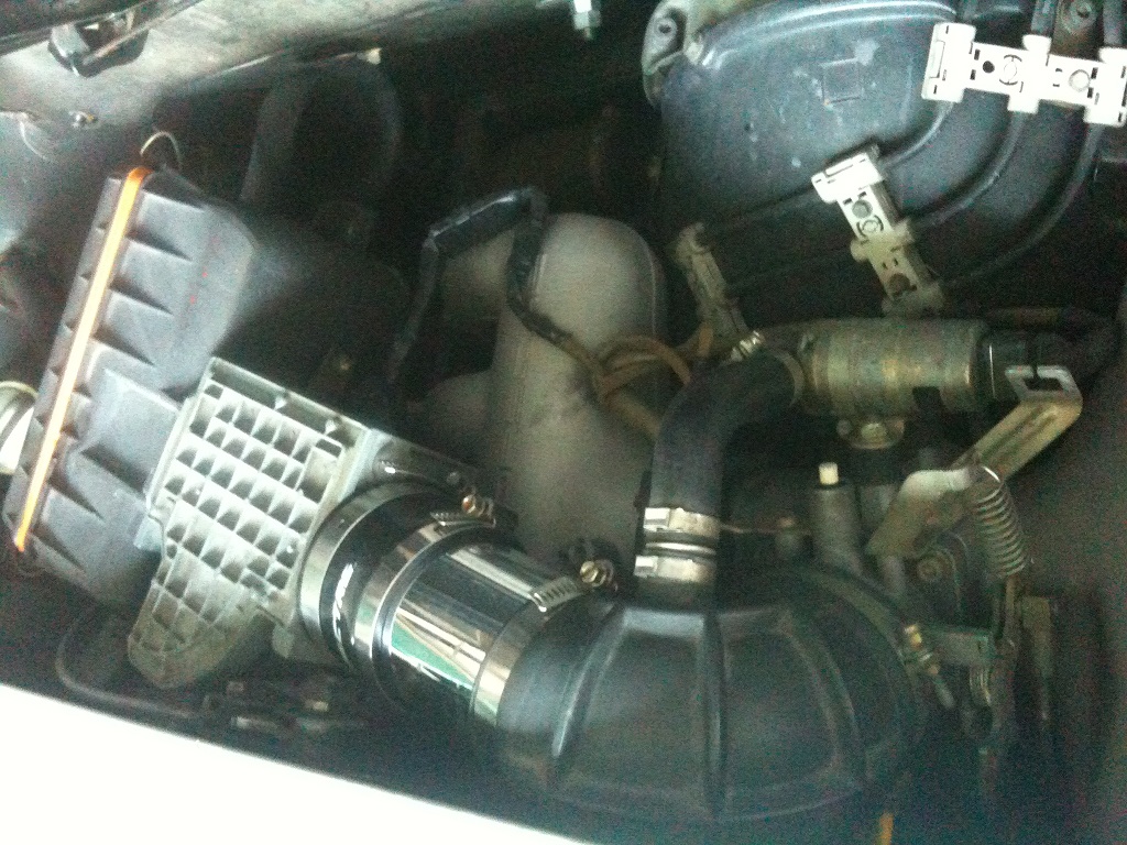

Here's another picture on how I modified the the aircleaner with a Pep boys ricer kit.

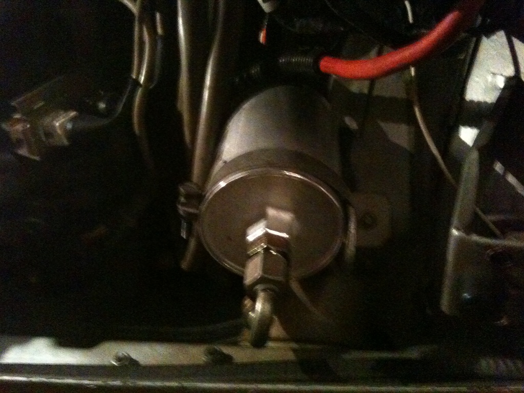

Here's a bigger picture of the battery area with the filter.
