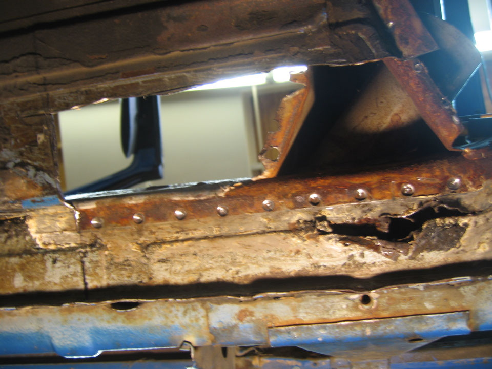

The driver door is nasty-looking. At first I thought someone had hyperextended it reversing into something while it was open, but I think it may have come open rounding a corner, flew open, and got damaged that way. At one point I was thinking just find a door of the same color, and drive her. But of course that was not to be.
The hole right there is the tip of the ice berg
(IMG:http://www.914world.com/bbs2/uploads_offsite/www.914club.com-11782-1291418831.7.jpg)

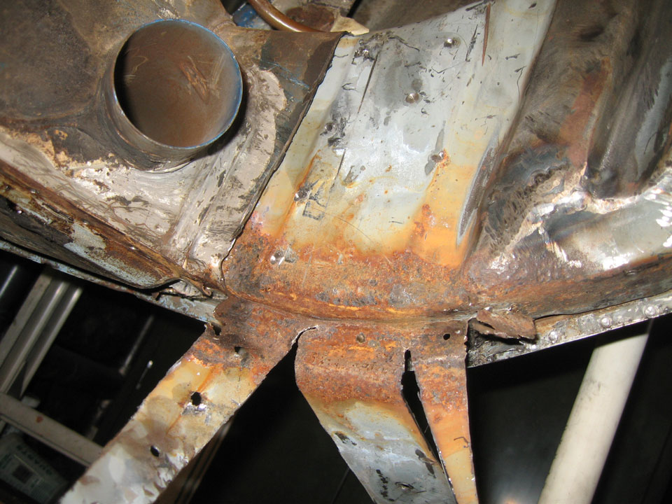

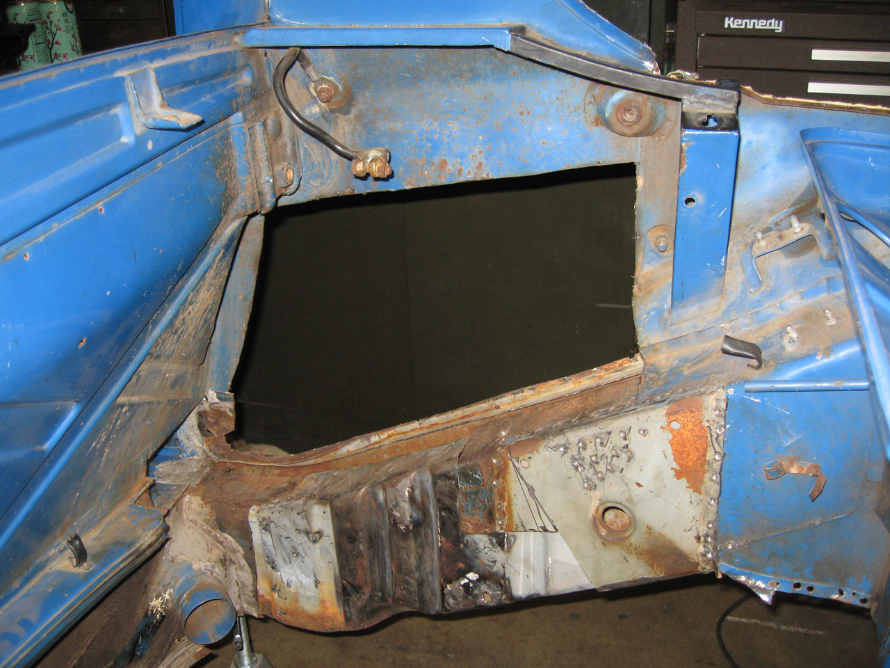

I've been stalling on updating the blog in hopes of giving the impression that I'm moving right along, when in fact I have been a bit stuck on my hell hole. I'm gonna get the metal to brace it at the doors this weekend, I think, put that together next week, and get the major cutting started probably next weekend. (IMG:style_emoticons/default/boom.gif)

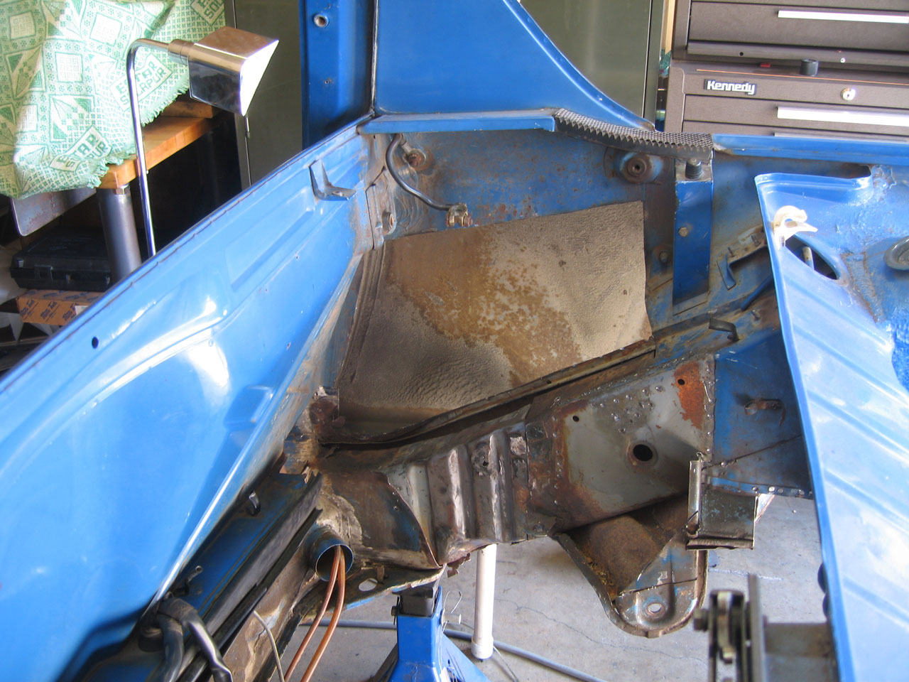

But for now, here's some madness I performed on my rusty-looking cowl/ fender/ door frame.
(IMG:http://www.914world.com/bbs2/uploads_offsite/www.914club.com-11782-1291419166.1.jpg)
Another shot. This side actually looks better than the passenger side. (IMG:style_emoticons/default/icon8.gif)
(IMG:http://www.914world.com/bbs2/uploads_offsite/www.914club.com-11782-1291419166.2.jpg)

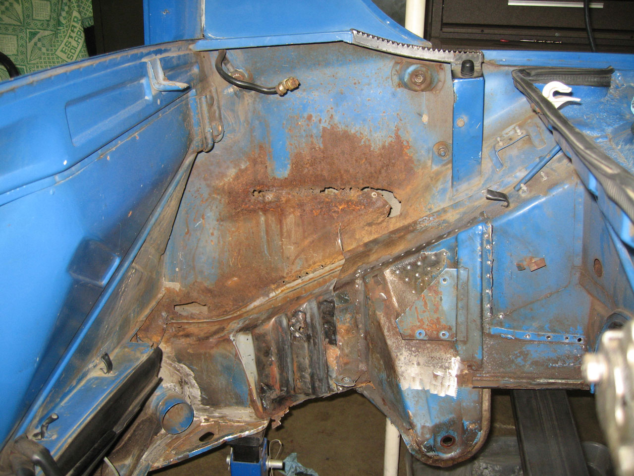

It's gotten below, to the inner fender well
(IMG:http://www.914world.com/bbs2/uploads_offsite/www.914club.com-11782-1291419167.3.jpg)
(IMG:http://www.914world.com/bbs2/uploads_offsite/www.914club.com-11782-1291419167.4.jpg)
Some nastiness at the corner of the headlight bucket where the front lid seal goes.. Now just how did they expect water to exit from there?
(IMG:http://www.914world.com/bbs2/uploads_offsite/www.914club.com-11782-1291419168.5.jpg)
Water made its own way
(IMG:http://www.914world.com/bbs2/uploads_offsite/www.914club.com-11782-1291419168.6.jpg)

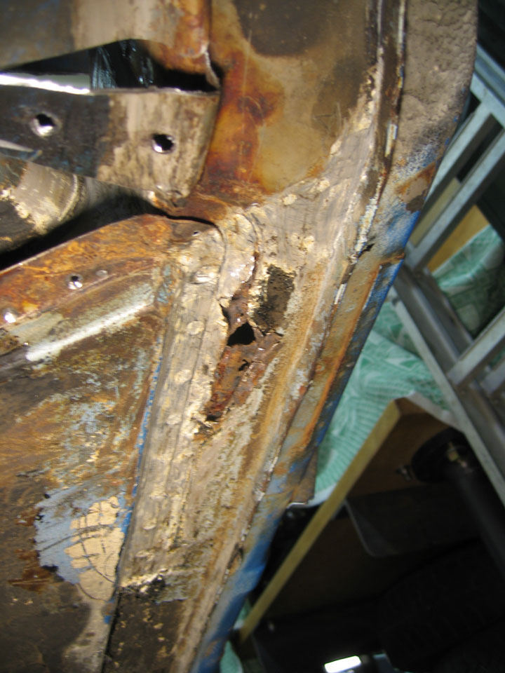

I didn't get shots of this before I scraped out all the sealer, but I can tell you it looked pretty decent hidden by the inches of the white stuff all dressed up in paint.
(IMG:http://www.914world.com/bbs2/uploads_offsite/www.914club.com-11782-1291419168.7.jpg)
So I contemplated for a few weeks what to do about all that, so many layers all coming together in a rusty mess right there, and both sides to be taken care of. Thought about cutting out just what seemed bad, but the challenge of getting it all back together and the fear of not going deep enough, I opted to remove the entire fender. (IMG:style_emoticons/default/screwy.gif) (IMG:style_emoticons/default/smash.gif)
drumroll..... (IMG:style_emoticons/default/hitfan[1].gif)
(IMG:http://www.914world.com/bbs2/uploads_offsite/www.914club.com-11782-1291431278.1.jpg)
They sure put the sealer on thick, about an inch of it there
(IMG:http://www.914world.com/bbs2/uploads_offsite/www.914club.com-11782-1291419169.8.jpg)
(IMG:http://www.914world.com/bbs2/uploads_offsite/www.914club.com-11782-1291419169.9.jpg)
A close up. -not done, of course, but better. You can see what's going on at least without all the rusty rusty
(IMG:http://www.914world.com/bbs2/uploads_offsite/www.914club.com-11782-1291419169.10.jpg)
Some of the undercoat removed, some more to go. I straghtened the lip with hammer and dolly.
(IMG:http://www.914world.com/bbs2/uploads_offsite/www.914club.com-11782-1291419170.11.jpg)
Same for the fender itself :aktion035:
(IMG:http://www.914world.com/bbs2/uploads_offsite/www.914club.com-11782-1291419170.12.jpg)
I thought I'd need a right angle drill to get at the spotwelds in the crevice inside the fender to the pillar, but that piece can come off 2 ways; the other not requiring the angle drill is what I went with. Still, quite the struggle.
(IMG:http://www.914world.com/bbs2/uploads_offsite/www.914club.com-11782-1291419171.13.jpg)

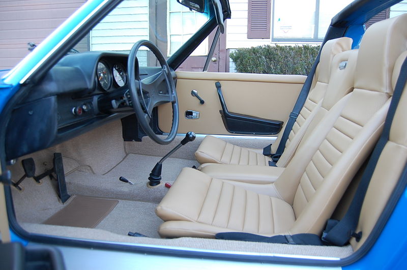

QUOTE(FourBlades @ Dec 3 2010, 05:21 PM) *
Very nice work! You have done this before?
I love Adriatic Blue as well. Best 914 color.
This first picture is of the car I restored. The girl is my wife's friend from Germany.
Picture Thread of Adriatic Blue Cars
John

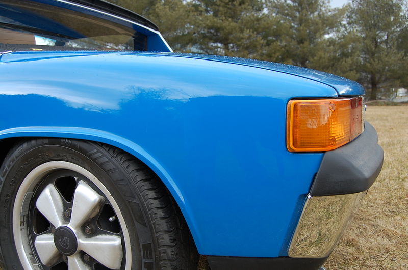

Thanks, it is my first time doing real metal working kind of bodywork and first 914. I've painted some cars before, but just bondo, sanding, mig welded panels and door skins. This will be my first time working on this since 1996 and I'm hoping to do a waay more professional job this time, hopefully no need for any bondo at all. (IMG:style_emoticons/default/biggrin.gif)
I love the L50E. People ask me what color I'm going to paint it. Adriatic Blue! ..of course.
The car, in the link, the color looks great. It is surprising how few there seem to be in adriatic blue.
At first I liked the color of it all faded more than the actual darker color. Now I just hope that the new paint will be the right hue more than the tint.

The just-after-I-got it off pic got turned into an 'h' before? so I've put that up, one even rustier-looking than was on the blog. (IMG:style_emoticons/default/barf.gif)
Here's some of the worst of the carnage in the multi-tiered hell hole.
(IMG:http://www.914world.com/bbs2/uploads_offsite/www.eggscollective.org-11782-1291433480.1.jpg)
(IMG:http://www.914world.com/bbs2/uploads_offsite/www.eggscollective.org-11782-1291433482.2.jpg)
(IMG:http://www.914world.com/bbs2/uploads_offsite/www.914club.com-11782-1291433484.3.jpg)
Going into the inner suspension console ear; it took me a bit to muster the will for it.
That's the current state of things right there.
It's weird the car must have spent awhile sitting level or other than the usual slanted toward passenger side as it's the inner passenger long that's messed up. I am contemplating/ leaning toward removing, sandblasting the outer suspension support, probably I can reuse it. The jack point seems really decent. I'm thinking of something less invasive there.
The inner though, I'm thinking it might be easier to cut out part of the firewall to get to the inner inner long, than to get the jackoint, and bothe layers of the outer long out to get at this business:
(IMG:http://www.914world.com/bbs2/uploads_offsite/www.eggscollective.org-11782-1291433485.4.jpg)
(IMG:http://www.914world.com/bbs2/uploads_offsite/www.eggscollective.org-11782-1291433486.5.jpg)
(IMG:http://www.914world.com/bbs2/uploads_offsite/www.eggscollective.org-11782-1291433487.6.jpg)
Besides these areas, up by the fresh air vent in the door wells ... There are areas that look remarkably good. Tunnel vision inspires me to want to get it to the point of wet sanding it. For now, my tetanus shot is current. (IMG:style_emoticons/default/beerchug.gif)
