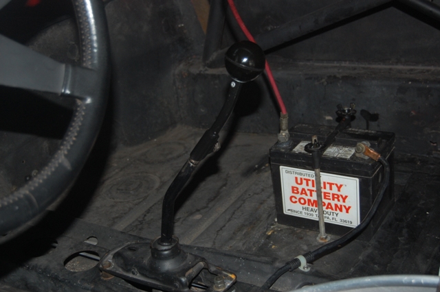

I raised the shifter in my 914 track car something like a foot, and then cut the shift lever down to about 8" or so. It sits next to and slightly below my steering wheel, and I am very happy with the setup. No short shifter needed, since shortening the shift lever shortens the throw.
Scott |

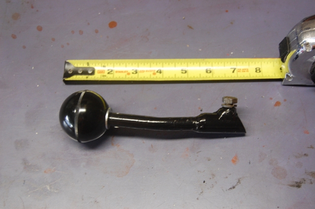

I'm curious to see what others have done as well. I have a short shifter, which I like, but it is a long reach to the lever. Can I weld an extension to it?

How does it feel with the added length? Is the throw super long now? ![]() I wouldn't say the throws were super long but maybe a 1/2" longer. I do have a little more leaverage now that it is longer to it sorta feels like it goes into gear easier. |
